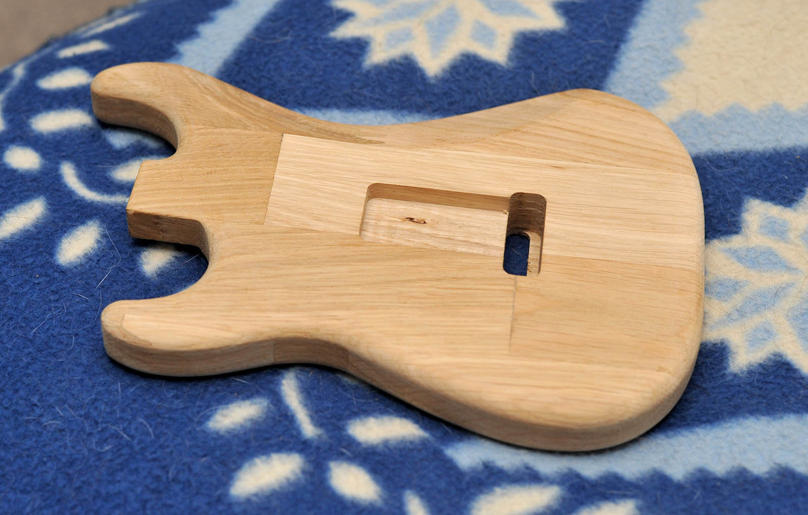

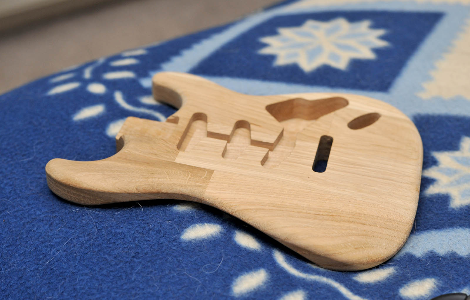

    Hi there,
    I managed to find a few hours to jump onto my new machine and have a go at some two sided machining today. I followed some tutorials on how to set up my stock and workspace for two sided machining using 5mm steel dowels as locating pins so that everything lines up nicely when I flip the blank over and machine the top of the guitar after having done the back. It worked better than I had hoped and its given me the confidence to have a go and try something full size in the near future !!

    Nice. Looks damn decent. I too am a Jazz CNC baby..... I have not ventured into 2 sided projects yet but you have piqued my interest.
    But I can’t let you beat me. I’m gonna have to go 4 sided project

    That's a great looking mini strat body, I'm looking forward to seeing and hearing the finished full-sized instrument. What software are you using for this?

    Hi Kit,
    Thanks for the comment. This one done in Fusion 360 , imported the model as a step file and created the G Code in the Manufacture side of Fusion.
