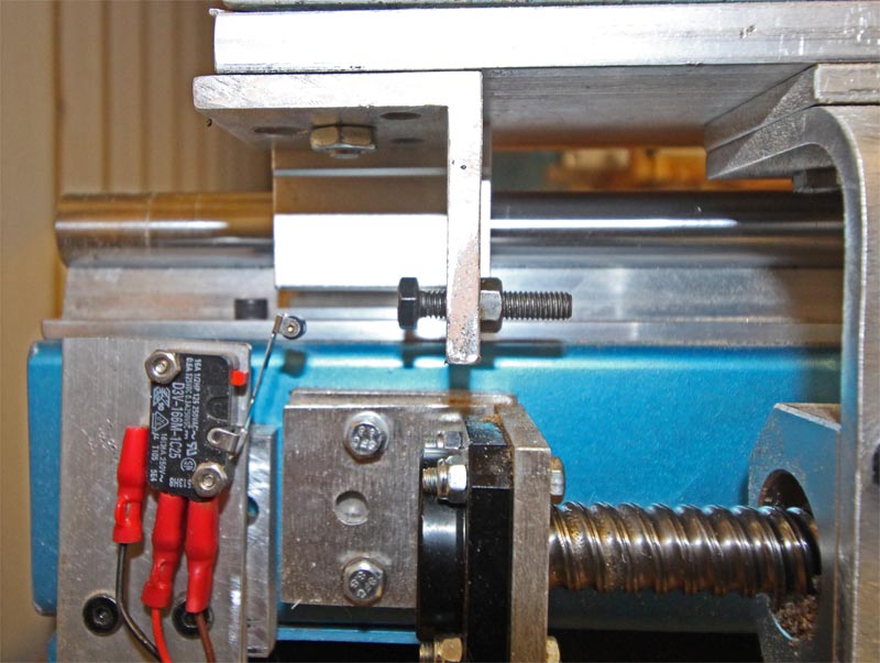

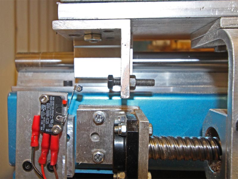

    One of my X axis microswitches is operated by a finely adjustable end stop. OK, it's an M6 bolt through a threaded hole in a piece of aly angle with a locknut. Measure the squareness of the gantry, adjust the nut, home the axis, repeat as required. Simple!

    Anyway we're all back to normal now with everything squared up again. Altering the homing squaring doesn't need alterations to the software, just a tweak of the microadjustable switch actuator shown here:
