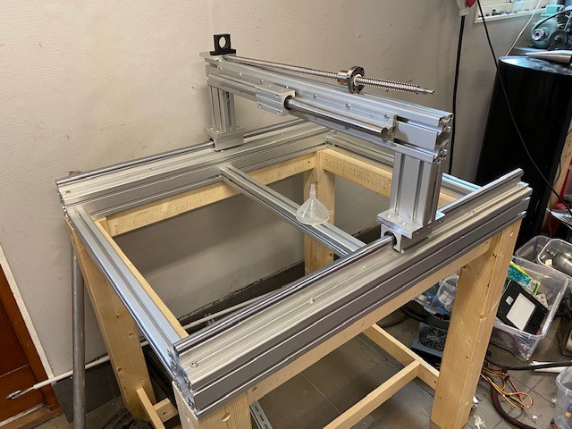

    Hi!
    I’m unsure of what couplings to use. As it seems I will go with alu couplings with a slit in them. Any thoughts about that?
    I’ve noticed that the ball screws are round at the end. Is there any reason that they don’t have a flat surface as the motors has?
    I’m thinking that maybe if something goes wrong they will come loose and prevent further damage.
    Thanks, JW

    No, they are the worst coupling to use. you are better using an Oldham-type coupling like this.
    http://www.fbtmotion.com/html/16.html
    Or better still a disc type coupling like this
    http://www.fbtmotion.com/html/17.html
    Regards the ball screw then just file a small flat onto the shaft, the machined portion is soft enough to file.

    Thanks!
    I guess the coupling is flexible above a certain amount of torque right?

    I've snapped 3 of those metal 'flexible' couplings so far.
    I now use the spider type with no problem at all.

    It's all to do with parallel and Angular misalignments and to a lesser degree axial growth or misalignment.
    Read this it will explain the different types and Torque ratings etc.
    https://www.thomasnet.com/articles/h...oupling-types/
