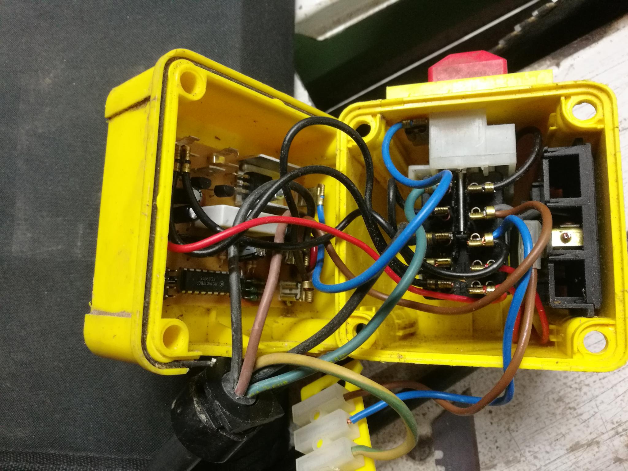

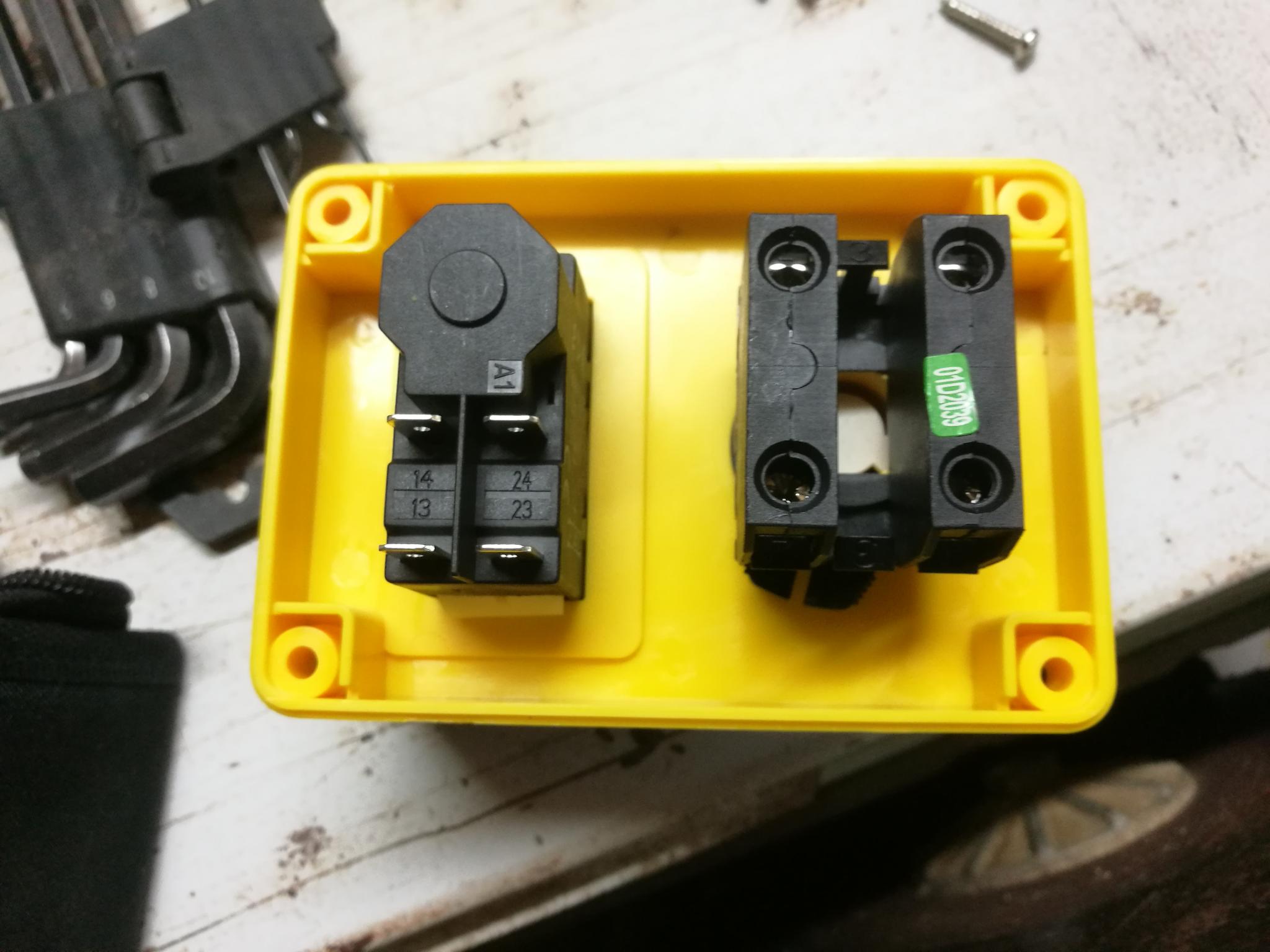

    I bought an old Klinger & Born (Elekra Beckum) table saw with what was described as having a faulty on/off switch. Right enough it doesnt start. I hear a mechanical type engagement from the switch and I can see the blade sort of ever so slightly oscillating which was slightly odd but its not rotating.
    I thought it might be the switch so bought a (NVR) safety switch and e-stop. I see single phase motor with a capacitor and the cable going to the switch has 5 wires, brown, blue, earth and two black.
    I've attached a few pics.
    Q: I suppose the first question is what should I look at before assuming the switch is damaged. Does it have a fuse and an internal reset for example?
    Q: If I can replace the switch with a more modern NVR which I have, see pic. What is the wiring for the two black wires?
    Thanks for any help.

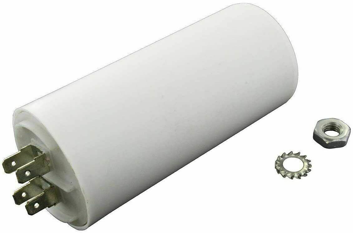

    I wondered about the cap as well so I bought a spare of the same value. I see my replacement cap just has four terminals, see pic whereas the original has a length of twin core coming out of the cap, brown and blue. I'm not seeing any marking on the cap hmmm?

    Those terminals look like just two terminals with two tags on each. Look carefully at where they are rivetted into the top cap - they are probably a single piece of metal folded.
    You didn't mention humming but you did say that it shook a bit - that's why I think the motor is energised but doesn't know which way to go until the capacitor circuitry gives it a kick in the right direction.

    Lives in East Lothian, United Kingdom. Last Activity: 8 Hours Ago Forum Superstar, has done so much to help others, they deserve a medal. Has a total post count of 2,994. Received thanks 376 times, giving thanks to others 9 times.
    That looks like it's a bit more than just a NVR switch. The circuit board looks like it's got some kind of speed controller and/or soft start built in.
    It doesn't matter what way the new capacitor is connected as they're not polarised. Just make sure you connect the wires to separate terminals, and not the same pair.
