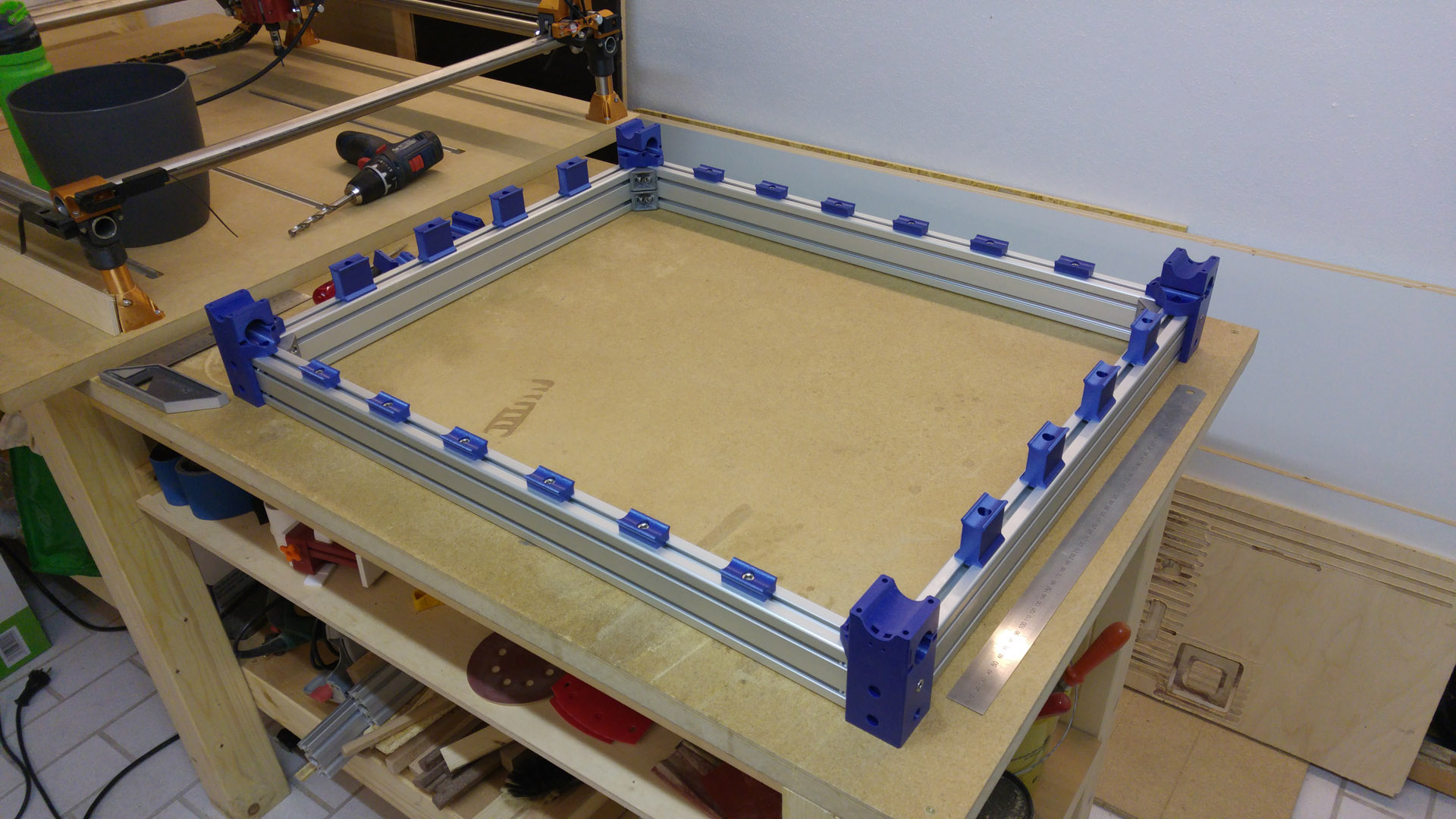

Then I quickly ran into the limitations of the MPCNC. The machine just wasn't rigid enough, and there was a considerable amount of deflection in the steel pipes.

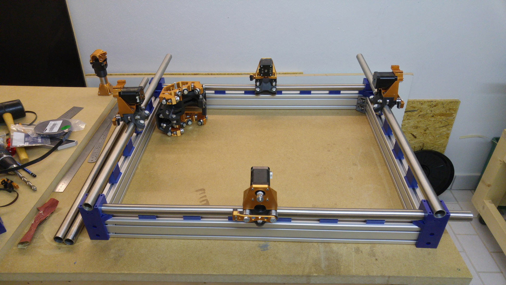

I made some attempts to address those issues and succeeded to some degree:
Stiffened the frame with alu extrusions,beefier corner connectors, reduced the work area, and provided 3d printed supports for the steel pipes.
ID:	29849Click image for larger version.

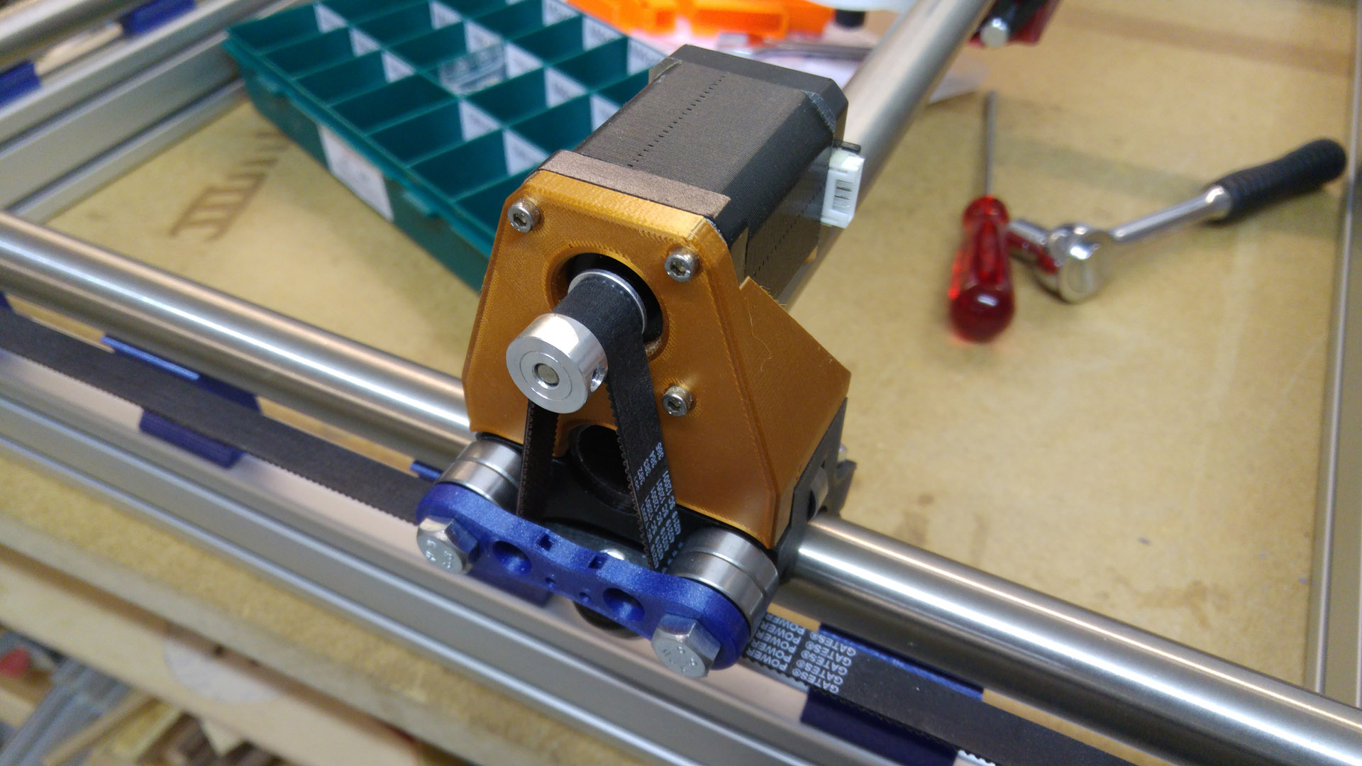

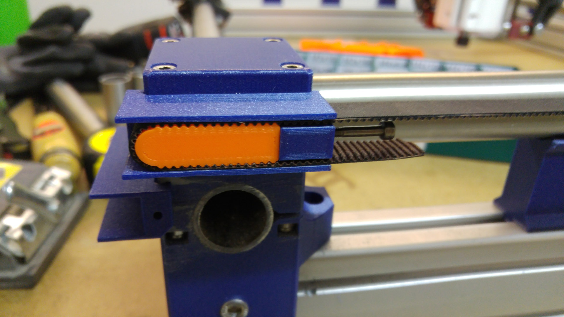

Doubled the belt width, and designed solid belt tensioners to replace the zip tie tensioners.
ID:	29851Click image for larger version.

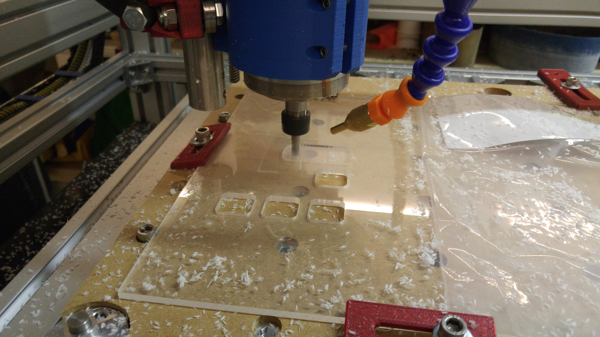

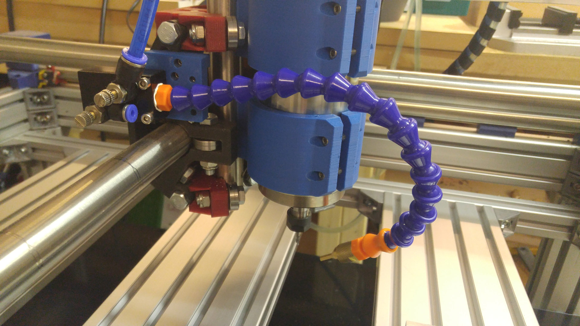

The whole process was really fun, and I could now do reasonably fast/deep cuts (using an adaptive toolpath) in soft woods, plywood, hard pastics (with an air blast)
After some time my makita handheld router (which I used as a spindle), died on me.

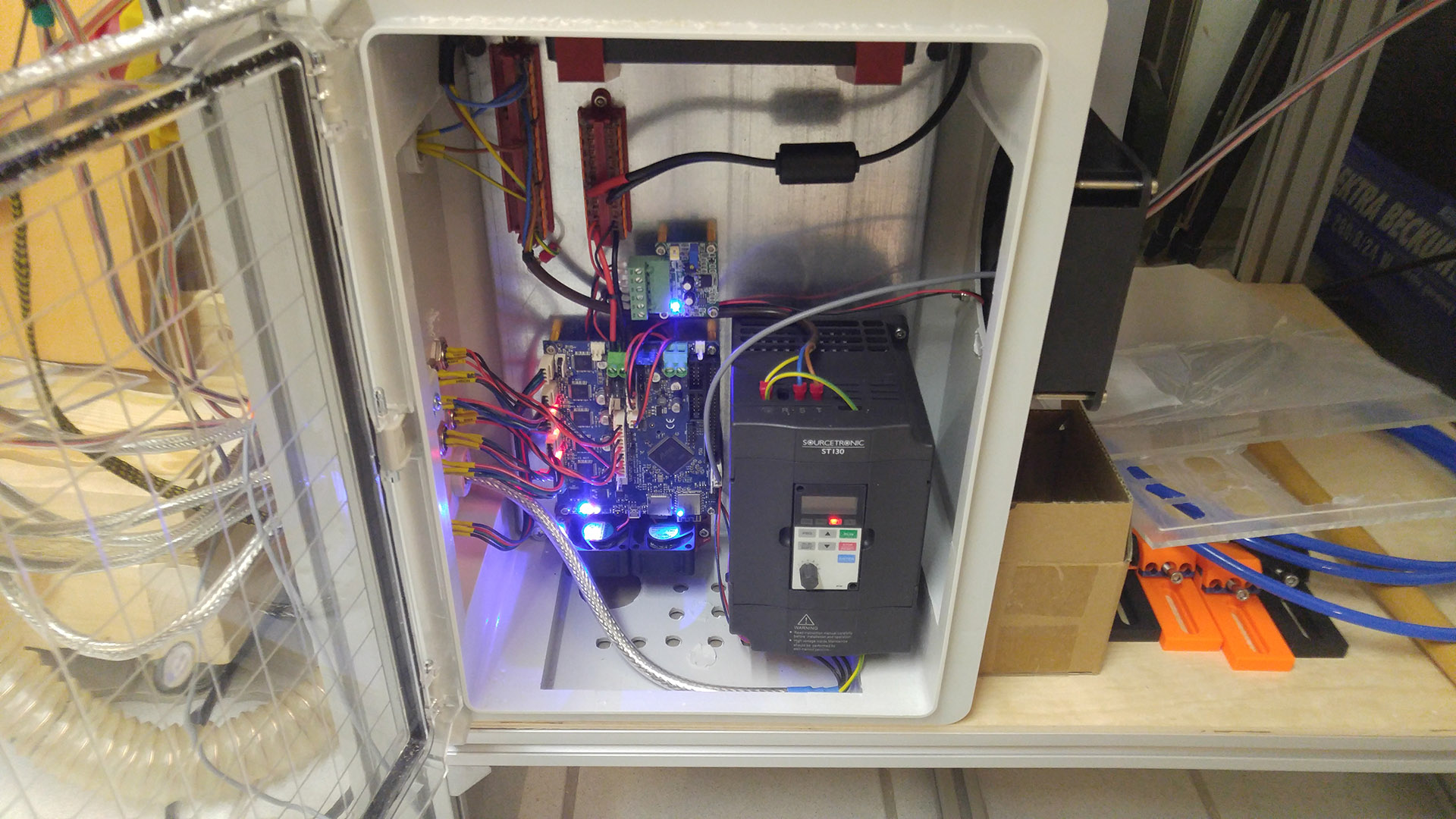

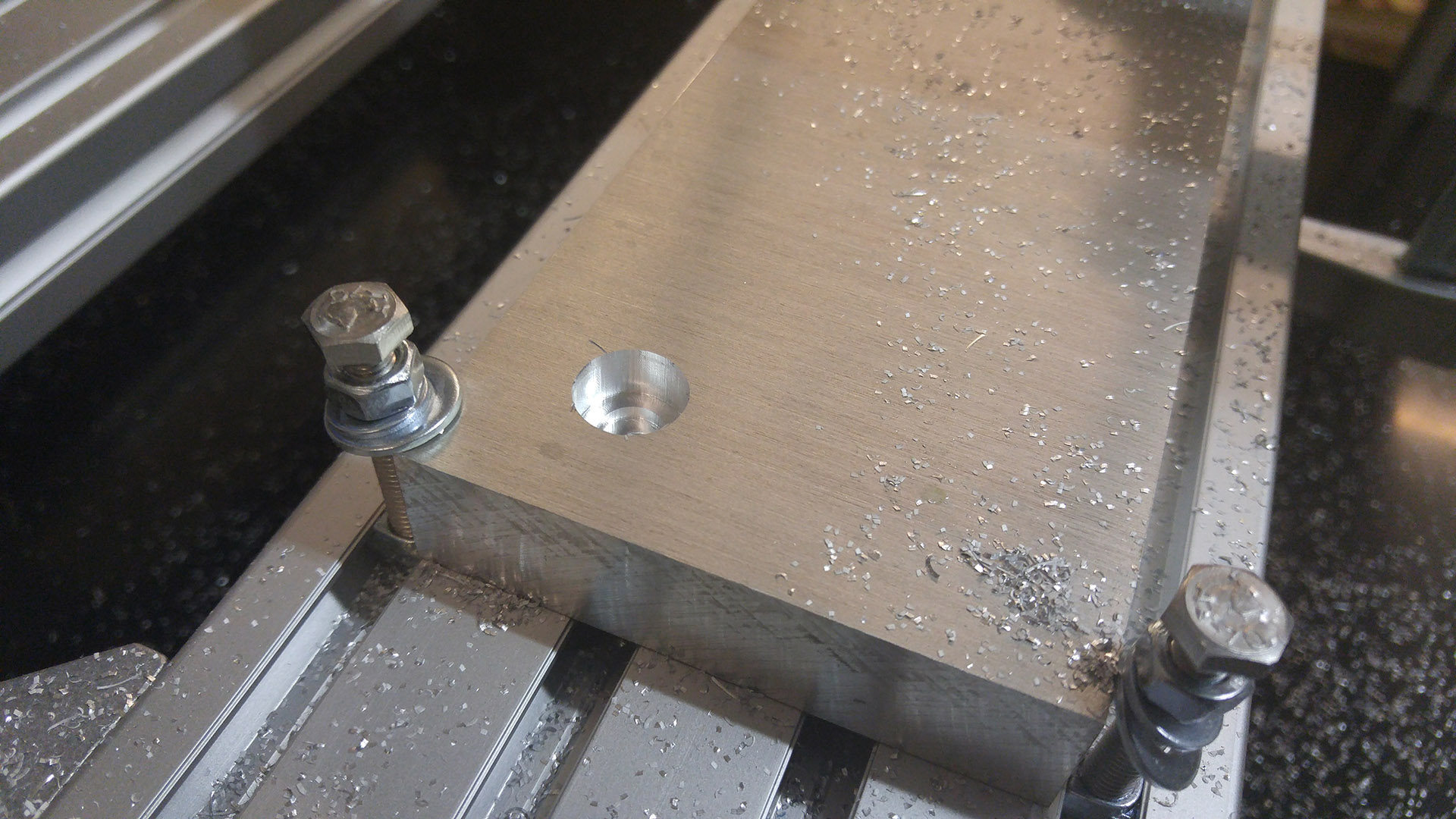

I decided to use this as an opportunity to learn how to setup a proper spindle with VFD, and bought the cheapest chinese 800w spindle kit off ebay to replace it.
ID:	29844Click image for larger version.
ID:	29845Click image for larger version.
ID:	29846Click image for larger version.

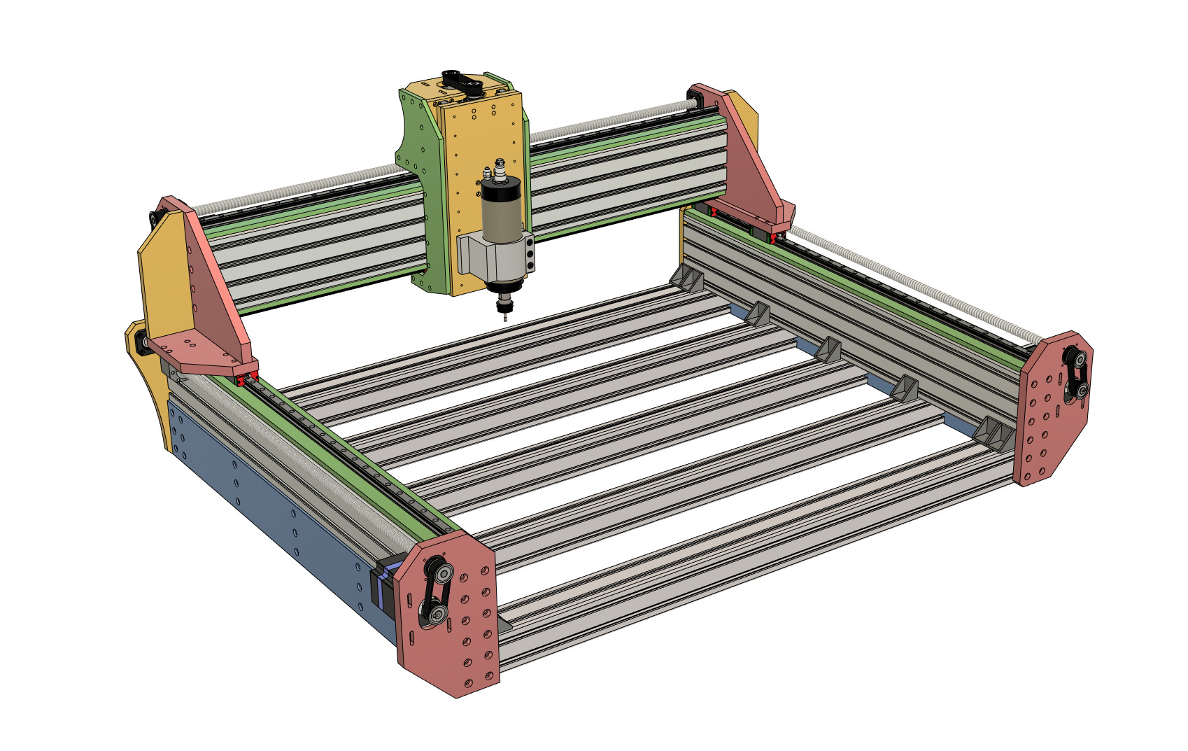

But the mpcnc project has now served it's purpose, and I would like to design and build a "proper" gantry style cnc:
I will be making a new post in "DIY Router Build Logs" about it soon, in the hopes of receiving some criticism/advice, plus I have a few questions.
Thanks in advance!
