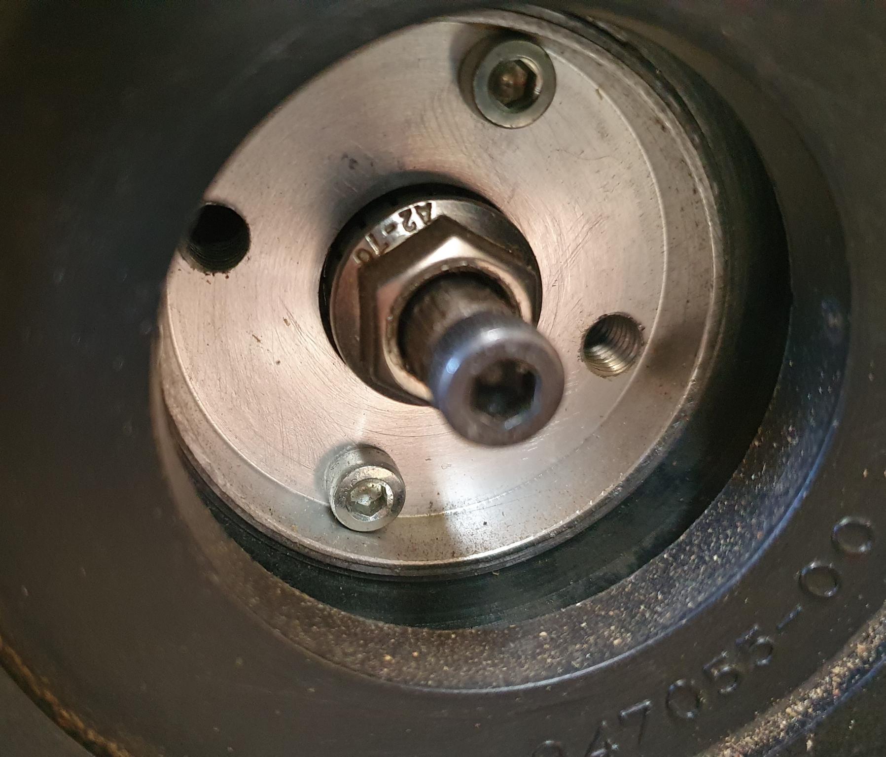

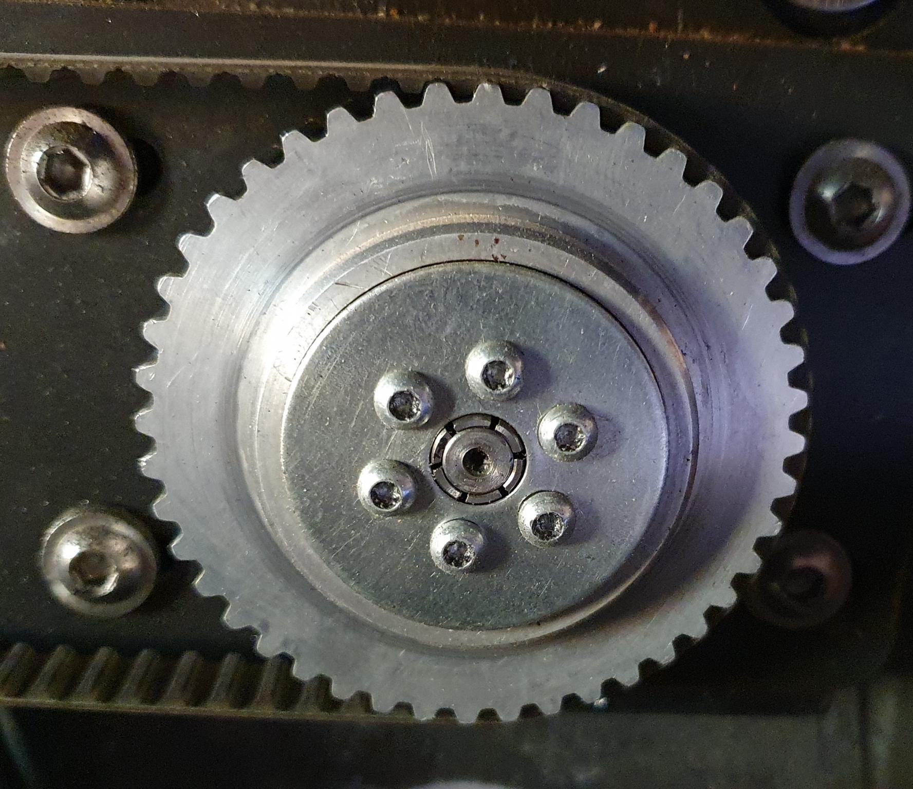

    Taperlocks are used extensively in industry, I have made my own using ER collets, pic of one on my bench mill and one on my router, both driven by servos

    Personally I wouldn't consider the additional moment of inertia of a taperlock pulley to be a massive concern if you have a long 20 or 25mm ballscrew but if you have steppers, I guess you may struggle with speed and response as it is. Without a high drive (power supply) voltage, the torque output of steppers quickly tails off, so the headline torque figure may be misleading.
    Surprisingly it does Muzzer.! . . Esp with a stepper system on long screws and smaller steppers feel it the more and really struggle with it if the pulleys are heavy. This is why when building machines with long screw lengths and steppers, (over 4ft) I select a higher pitch screw and use a ratio to lower screw speed, this serves 2 purposes, lowers the chance of screw whip and lowers the inertia.
    I also only fit Nema 34 motors which use high voltage drives, often these are at mains voltage depending on motor size 8nm + but for the smaller 34's I still wouldn't use drives less than 80Vac/100Vdc. The 4.5Nm and 5.5Nm Nema 24 Closed loop Lichuan motors I use now are so powerful running on 60Vac that I rarely fit Nema 34's below 8nm as the difference they allow in performance is much better.

    The other thing to think about is for an axis with double ballscrews you need to be able to square the gantry. This might mean being able to rotate one ballscrew very slightly by hand (without the pulley secured) until the gantry is square, so a key way or D flat would not work as this puts the pulley at a fixed location on the ballscrew. A simple pair of grub screws allows the pulley to sit at any angle on the ballscrew.
    Also on the inertia side I did the calculations for machine design years ago and the mass of the gantry was a pretty small part of the motor requirements. The acceleration of the ballscrew was a large part of the motor requirement, and this in turn related to the ballscrew inertia. Inertia relates to having mass a long way from the axis of rotation, so heavy pulleys will have an effect. If you want to pocket them out then removing mass furthest out makes the biggest difference. And larger pulleys are significantly worse as inertia relates to the square of the radius so goes up quickly.

    If I had the knowledge and tools I'd prefer to drill/tap a longish threaded hole into end of the ballscrew and bolt on a pilot bore pulley. Use say 5mm high tensile. Guess it depends on machine size wether it would hold.
