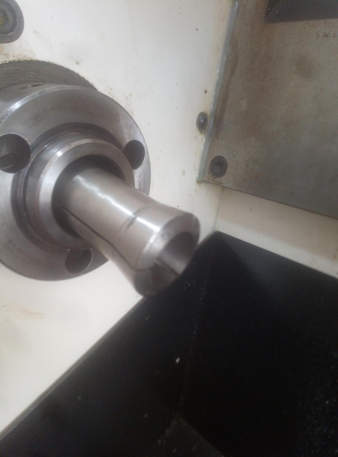

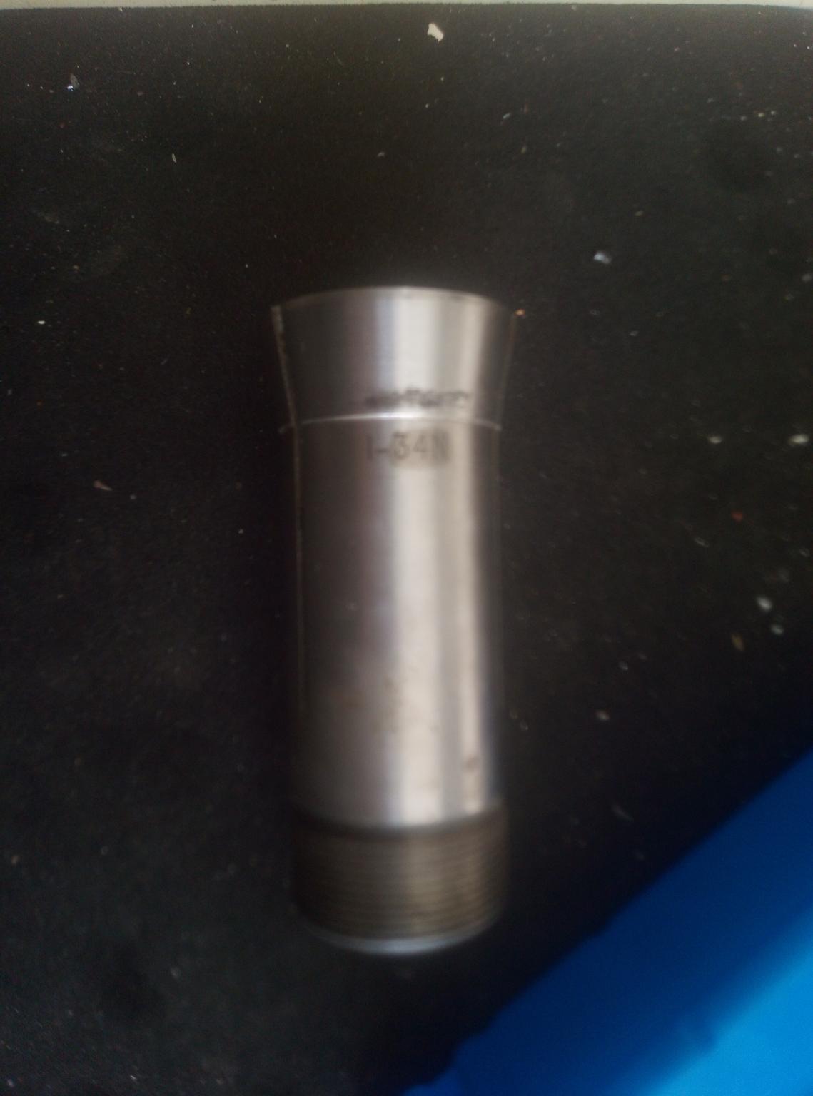

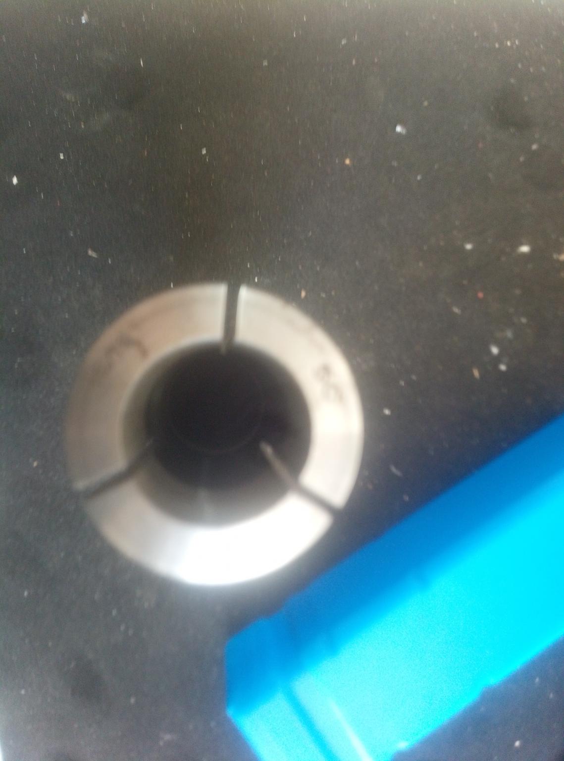

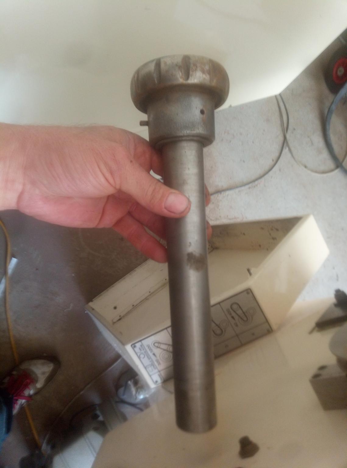

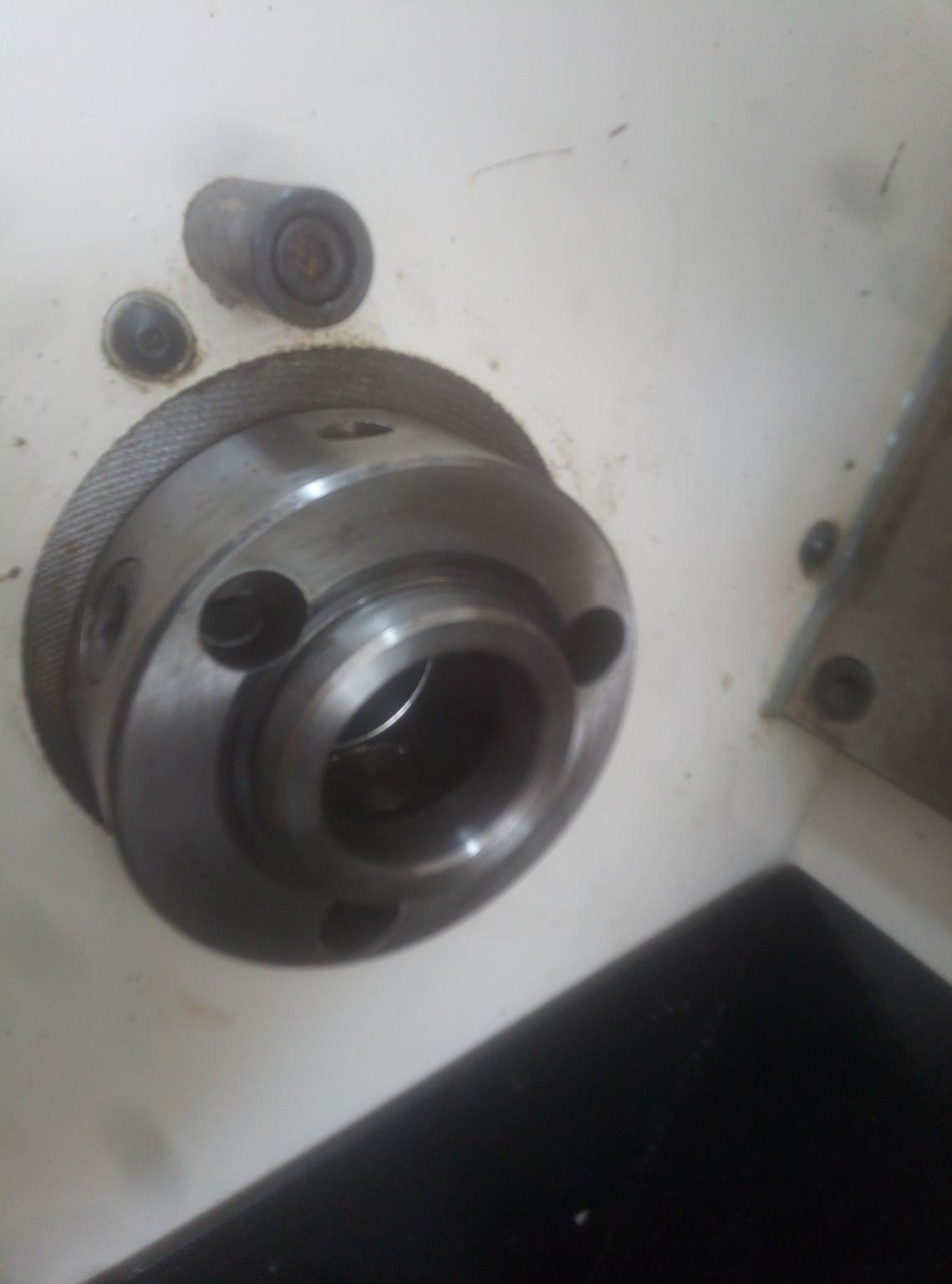

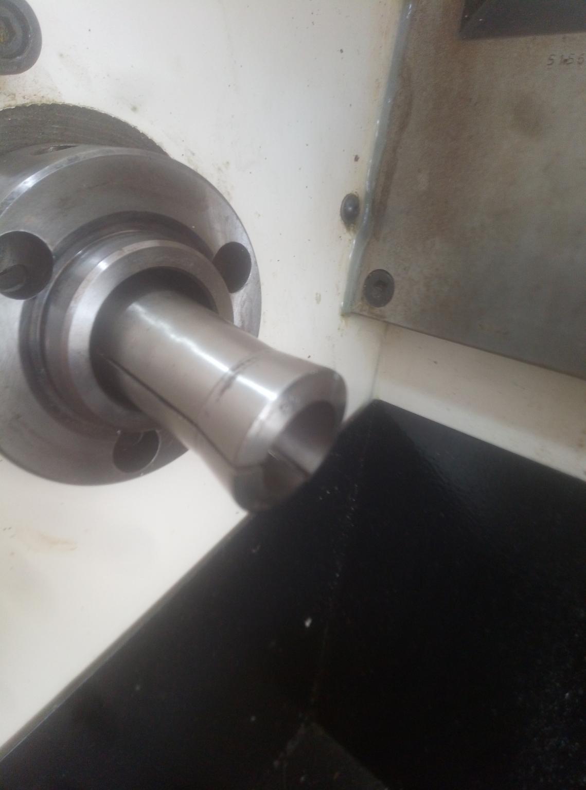

    hi my name denis
    i have 2 boxford tcl 240
    I would like to remove the spindle and put a classic drill bit for and a cylindrical piece to work with a bridle.
    i took pictures. someone made this change?
    when the old owner bought it they tried to do something, but it is incomplete. see attached photos.
    know that it tapers and deltro the (sleeve) the tube to be able to put a support to put a tip.Click image for larger version.

    That looks like it's got a camlock spindle fitted.
    Given there's only 3 mounting holes, it'll either be a D1-3 or D1-4 - https://www.smalltools.com/lathe-spi...ication-chart/
    It looks like the previous owner has fitted some form of manual collet chuck.
    Once you've identified the spindle fitted, googling should find suitable chucks.
    Muzzer's Avatar
    Lives in Lytham St. Annes, United Kingdom. Last Activity: 20 Hours Ago Has been a member for 8-9 years. Has a total post count of 490. Received thanks 81 times, giving thanks to others 27 times.
    It is likely that the spindle has a Morse taper in the bore. I have a D1-3 nose on my Colchester Bantam and this has a MT5 taper. If yours does have a Morse taper, you can buy a collet chuck eg ER32 or ER40. You will need a drawbar too but that should be simple to make.
    These are widely available on ebay, Amazon and AliExpress
    https://www.aliexpress.com/item/32908168694.html
    thanks. I also thought that inside it is in a large morse cone,
    I will check with a bore gauge to be able to measure inside
    I have 2 same lathe, I try to check in the first lathe
