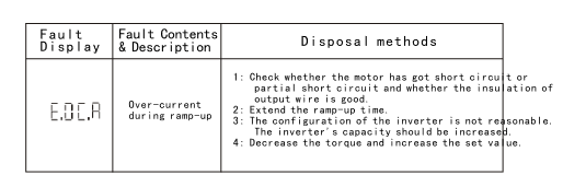

    I connected a new 2.2kw spindle to a Haunyang D223B VFD this one Click image for larger version.
ID:	29879 which has been off for 6 months and it gives me this error code

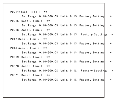

    I think I need to adjust some settings I tried changing these values but nothing changed

    Does anyone have an idea of what I need to change and what sensible values are?

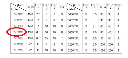

    PD14 and PD15 are the only ones you are interested in, Set both to 20 just to eliminate it's not them causing the error. If it works then set PD14=5 and PD15=10, these figures will work.

    What happens exactly.? Does it try to start up then give the over-current error or does it just trip straight away.?
    Straight away
    I tried PD013 8 to reset the vfd and now it does nothing when I press run
    It was counting up to 400 if I unplugged the spindle before I reset the settings

    That's not a good sign, it's suggesting the spindle is going to ground. Does it make any buzzing sounds then trips or instantly trips.? Does the spindle twitch at all.?
    Silly question but you have checked the spindle isn't seized or the cable damaged.? It's often the silly things that bite you.!

    The cable is brand new but I'll check it just in case, the spindle is also brand new could the vfd be at fault? With the old spindle as soon as I pressed run it blew fuses in the 13amp plug the machine is on. The VFD powered on fine with the spindle unplugged counted up to 400 so I assumed the spindle failed
    It worked fine but I left it for 6 months other stuff came up and when I came back this started
    I only have 1, 2 & 3 pins soldered on as the spindle isn't earthed I was going to do that after I get it working I have checked continuity from the spindle plug to the VFD it seems good no shorts I have grounded the RF wiring
    The VFD to spindle cable length is ~5m one solid piece
