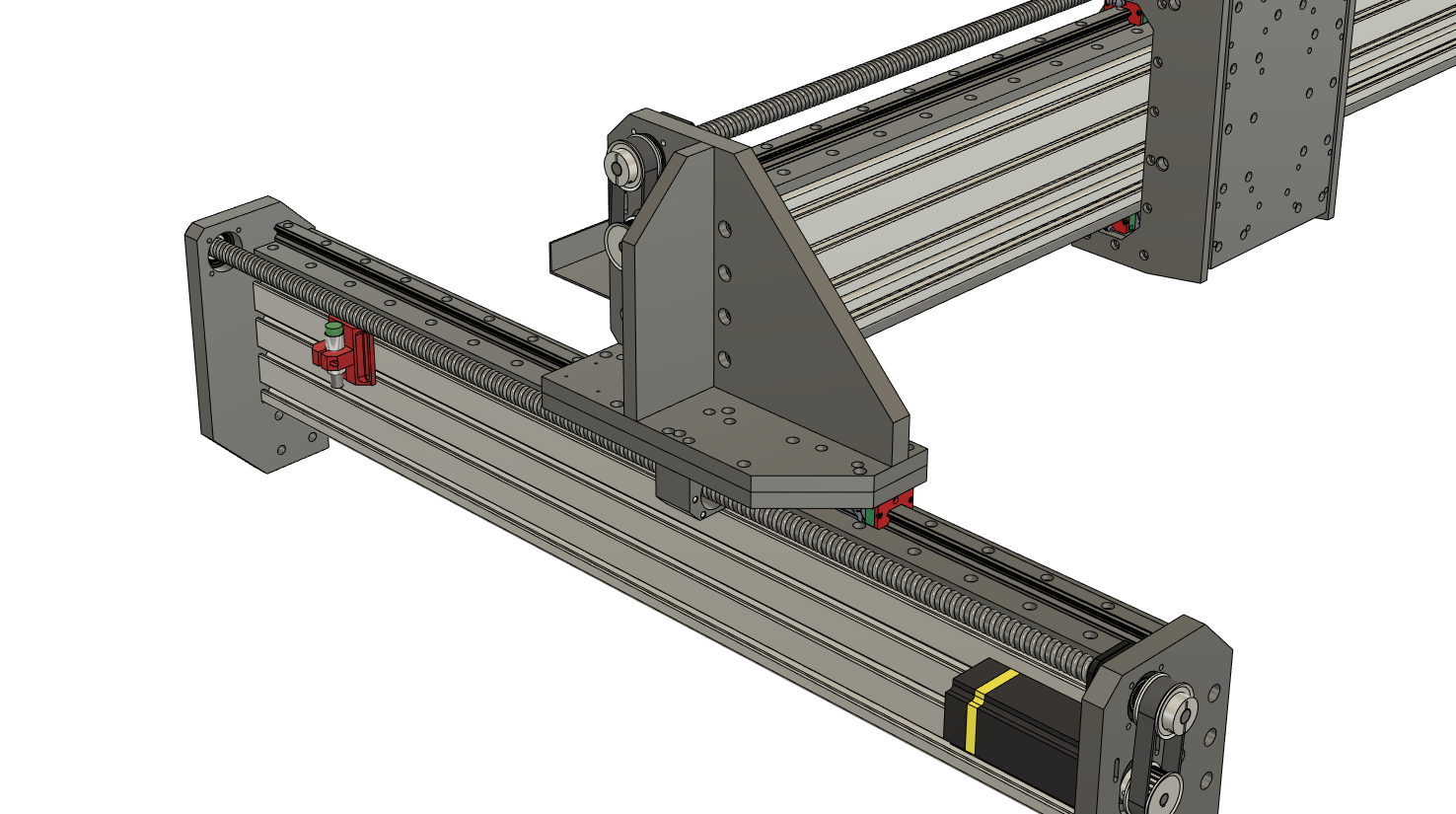

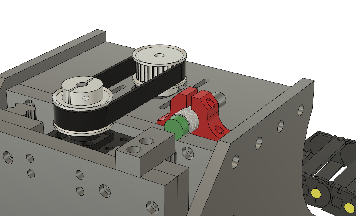

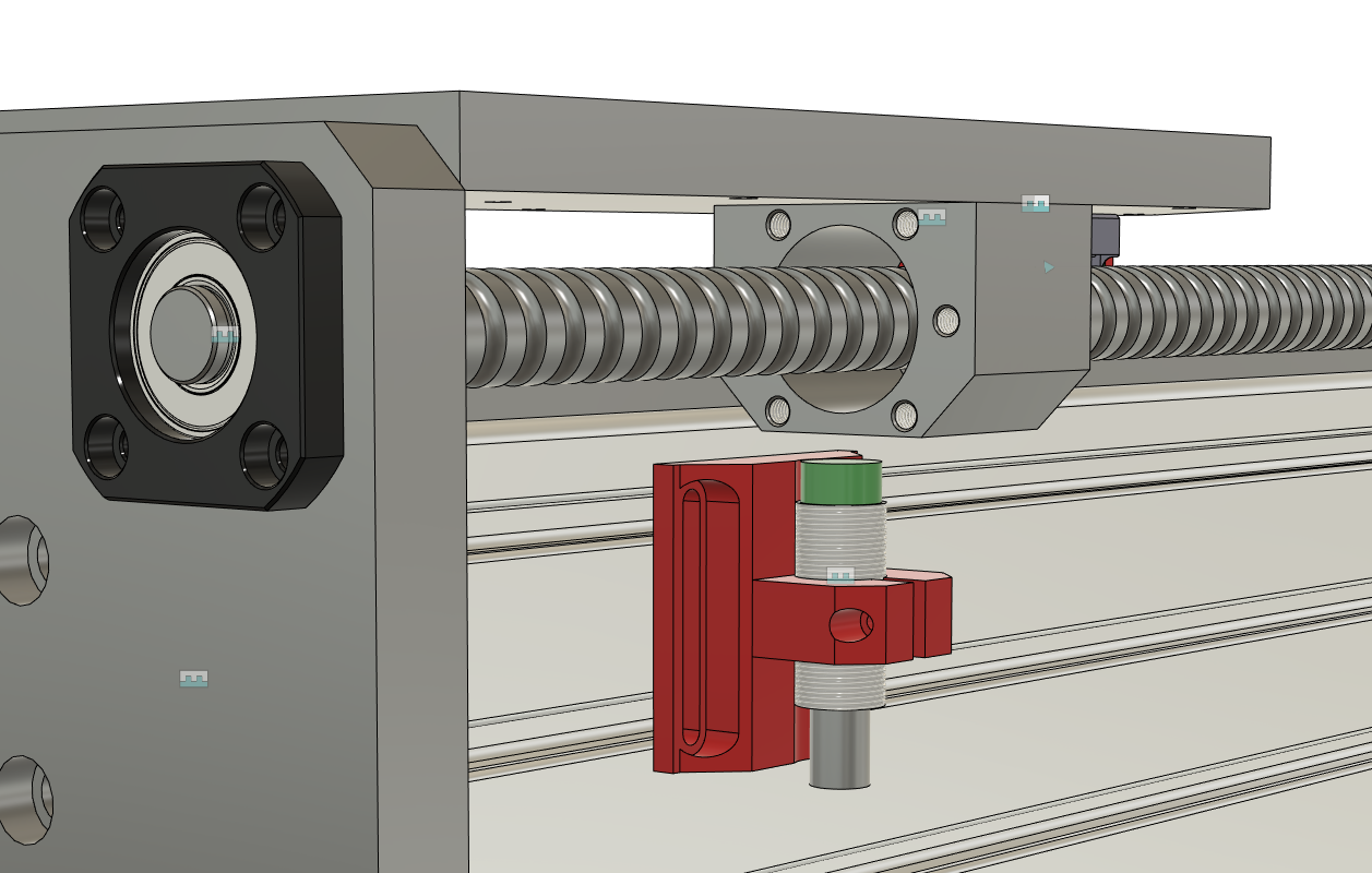

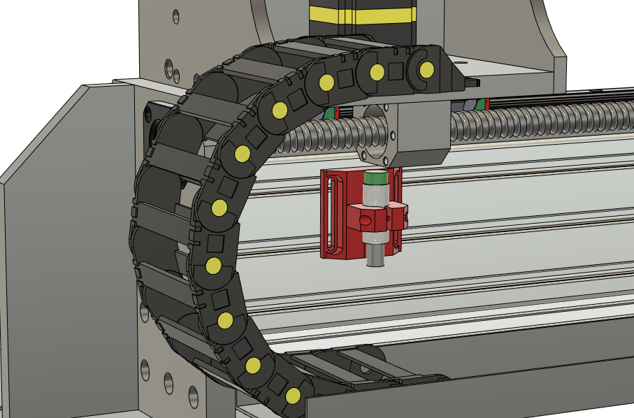

    I've been busy the past few weeks, so unfortunately not too much progress.

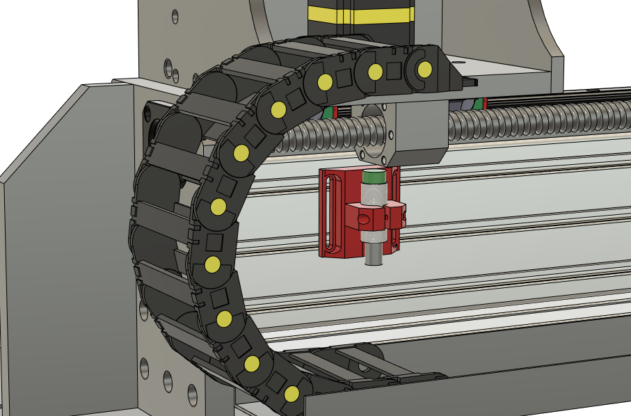

    I designed some simple 3d printed, easily adjustable mounts for the homing sensors.
    On X and Y they will be triggered by the DSG housings. On Z, I'll add a small bracket to trigger the sensor.

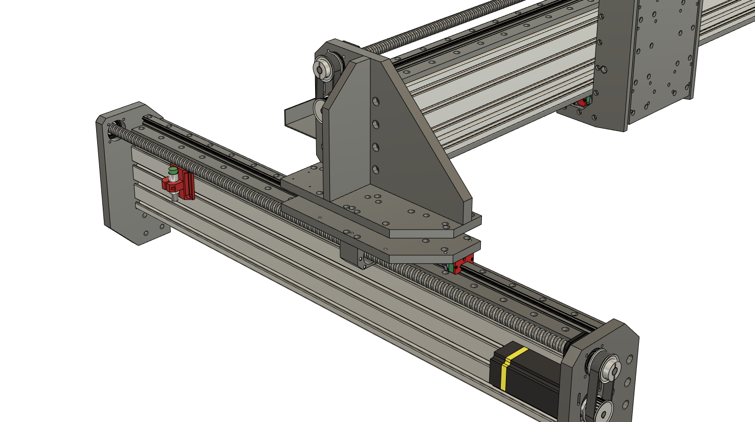

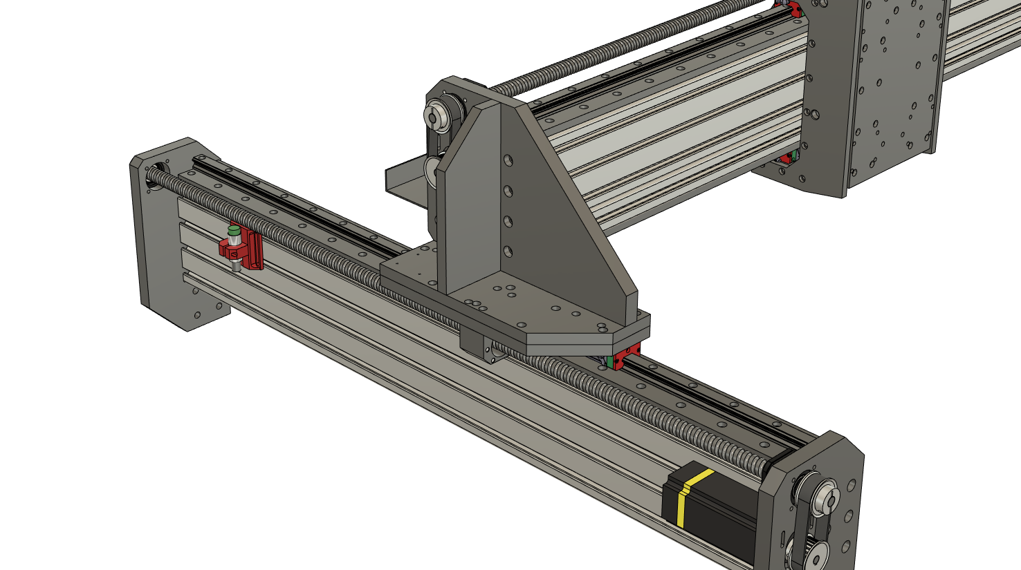

    Detachable Gantry:
ID:	30094Click image for larger version.
    Nice brackets Jeff, very neat.
    Word of caution though, aluminium isn't a good or reliable trigger for proximity sensors, I would fasten a piece of steel or have them sense a bolt head rather than the aluminium bracket
    Email: [email protected]
    Web site: www.jazzcnc.co.uk
    Will do. Thanks!
