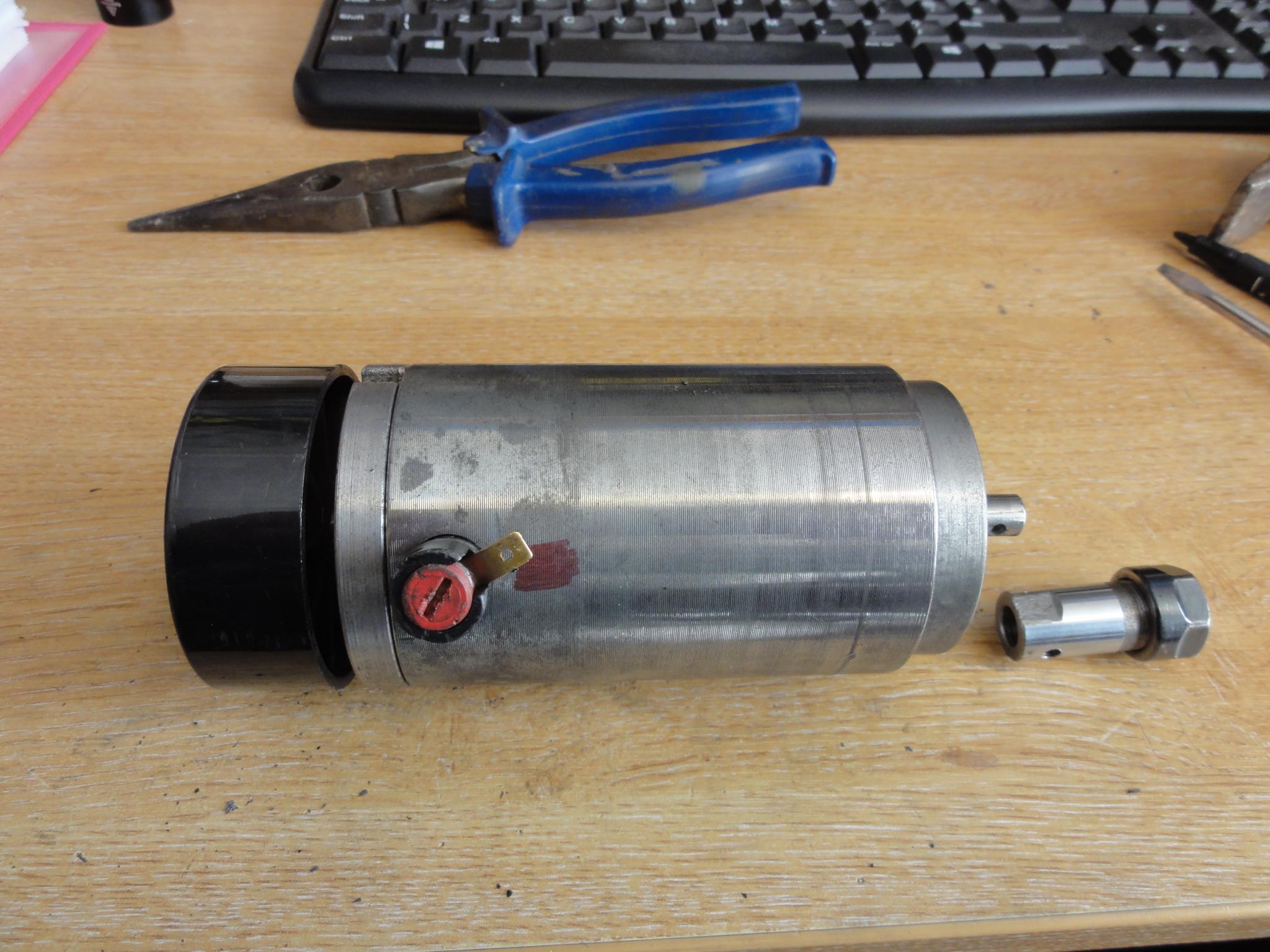

    Many thanks for your reply, I have taken the motor apart and what appears to have happened
    is one of the brush container parts (the positive side) has somehow made contact with the
    comutator, you will see from the photo that the motor is without a doubt dead.
    I have also attached a photo of the motor body which measures 178mm long including the
    ER11 tool holder and 57mm diameter it is 200w dc (I think) with a speed range from 0 to 8000rpm.
    It has 2 power cables connected by spade connectors one on each side (positive and negative)
    I have been unable to get a motor matching the above but I would like a slightly better one if at
    all possible? I hope I have attached the pictures correctly.

    Yes, that looks like a brushed DC motor. Are you convinced that the drive is still OK? If there was a short inside the motor, it may have popped the drive.
    I know nothing about these router machines and motors but perhaps somebody who does will pipe up.

    I have searched AliExpress but I can not find a replacement motor (57mm Diameter) Most seem
    to be 52mm diameter. If possible I would like to upgrade the motor for something a little more
    powerful and also brushless. Past experience with brushes has left me very with very little faith.
    Electrical systems are impossible for me to understand so do I go from 200w to 300w or 400w
    I have no idea how to do this and what I am letting myself in for?

    Here's a 52mm one with a bracket included
    https://www.aliexpress.com/item/3234...archweb201603_
    And - here a whole page of 57mm ones but they incude a bracket anyway
    https://www.aliexpress.com/af/57mm-d...20210508155638
    And - here are the brushless ones
    https://www.aliexpress.com/af/57mm-b...tiative_id=SB_
