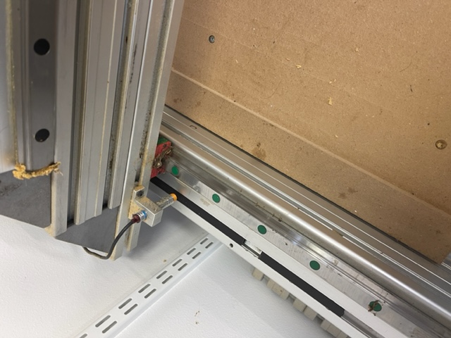

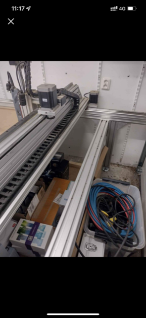

    I was looking at an CNC machine in Sweden that I maybe buy. The problem is that the owner died in Covid so the wife don’t know anything about the machine more then it was bought from England.
    The stepping motors has CNC4YOU on it the Z axis is Nema 34 8.7Nm and the rest is 23 3.1Nm. But i cant find the machine on that site, and there Z axis not look like this machine.
    Im little worried that I cant get parts to it the rack and pinion rassle little so maybe I need to buy new. Any clues how built this machine?
    Should be good to also have support for files and that thing.

    Maybe a home-brew using their components?
    Doddy's Avatar
    That Z-Axis has a whiff of Marchant Dice about it. The rest - plenty of witness-marks from obvious hand-finished components/assembly.
    Agree with both your points Doddy.
    Super Box and Tonman (BoB and Drivers now obsolete!) stink of Marchant Dice.

    I would get the machine moving first then you can see if you need to change them, you don't need to fit the same racks and pinions.
    The Z axis could do with some work on it and fitting a 2.2Kw W.C.. spindle and VFD
    Rack and pinion will be Chinese. Have a look on AliExpress. If you open up the controller box and find that the BoB and drivers are connected by IDC ribbon cables and the Bob and drivers are made by Tonman they are obsolete. If you have any driver problems send me a picture of the driver showing any model number and I will look in my keep boxes. I have three of them somewhere if they are the drivers I suspect they are. If you need them, you can have them for the postage costs. Otherwise you would have to go the route I went when the BoB fried and replace the lot with standard kit. If you are running 48v then you would probably be better off going to a higher voltage at the same time.
    Everything You have is usable.
    Everything You have could also be better.
    Rack/p is easy and cheap.
    Steppers and drivers are easy and cheap.
    Find what you want to do.
    And how much you want to do it.
