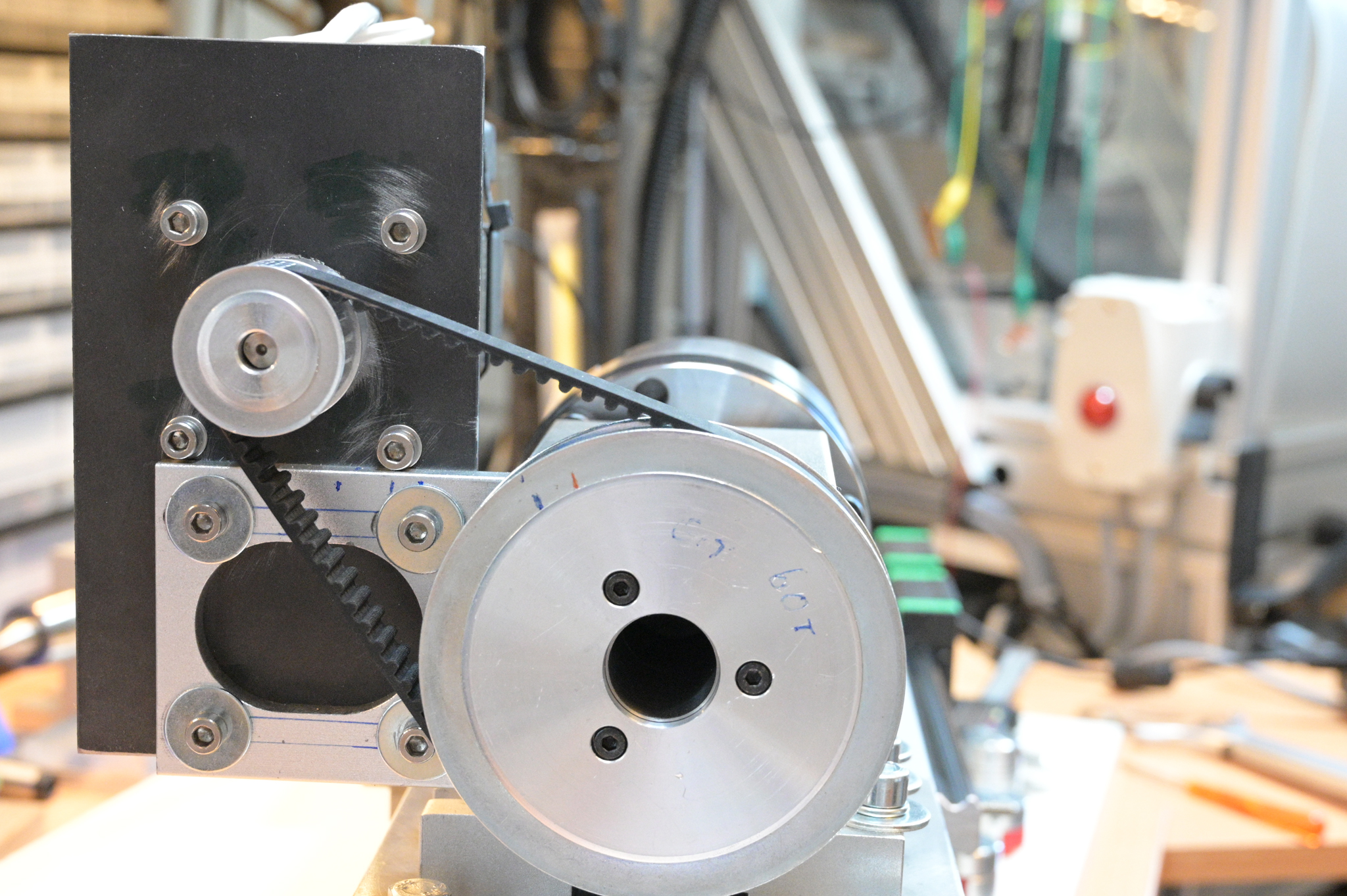

    Actually, I guess that my comment was a bit too emotional. Here is the sound of the stepper at 380 chuck rpm (2280 stepper rpm).
    Somehow I expected (hoping for) some sort of miracle regarding noise, which didn't happen, but that's OK, I am fine with that for this experiment. In the end, if the whole lathe thing is going to work I may decide for a better solution and a more powerful motor. I think that a larger motor would also be more quiet, but that must wait for now.
    Also, if you are saying most of that noise is from the belts then you need to look at the setup/pulleys/belts because they shouldn't make that much noise. I connect most of my motors to ball-screws with timing belts so have fit 1000's of belts and they make a fraction of the noise you have there.
    I don't know the sort of installation you are doing, but I think that you don't build your motor holder the way I did here, which is the original 8 mm aluminium plate plus a 3 mm steel plate.

    The reason for this solution is that I could not for my life come up with a way of removing the original motor holder plate, so I could not replace it with a new, single 10 or 12 mm thick plate, which I intended to do from the beginning, and also because I only had 3 mm steel plate at home, and I have lots of that, and don't want to get other. Of course, I could visit a local workshop and they would most probably free of charge make such a plate for me, or could give me a piece of scrap plate which is thicker, but for now I am happy to be able to do it this way. I also needed longer belt, the 350 mm is been changed to 420 mm long.

    I also had to add some spacers otherwise the shaft would have ended up too far back. So I think the reason why you don't hear that noise is, apart from the fact that you probably don't run the motor for such long time, is that you also don't have such weird installation, which probably creates a lot of the noise also. With that in mind, plus the fact that my servo is also quiet on the table without load and with a dampening mat underneath, the comment I mage in the video is not fair, the motor is indeed quiet, but my own installation is generating a lot of noise.
    So for the future, if I will otherwise be happy with this, then I will remove the original plate through cutting it off and replace it with a thicker aluminium plate in one piece. I think I can do that, but right now I don't want to destroy any part of the machine. Of course, if anyone have an idea about how to remove the original plate without cutting, I'd be glad try and do it that way, but I could not find any video or description in explaining how it was installed the first place or how it can be removed without removing the whole spindle assembly and risking the pre load of the bearings, or causing damage to the spindle or the spindle housing. All I know is that removing the chuck and the large pulley plus the four screws is not enough, the plate can still not be removed.

    I agree, it does sound like steppers, but again, that's only with the belt and everything attached. Regarding the driver, actually, my driver can start to buzz with some configuration. I did some experimenting and at one point it sounded like an old cheap Chinese built Toshiba 6560 chip based driver I had when I started my very first CNC build. That driver was also buzzing a lot when the motors were standing with the holding current applied.
