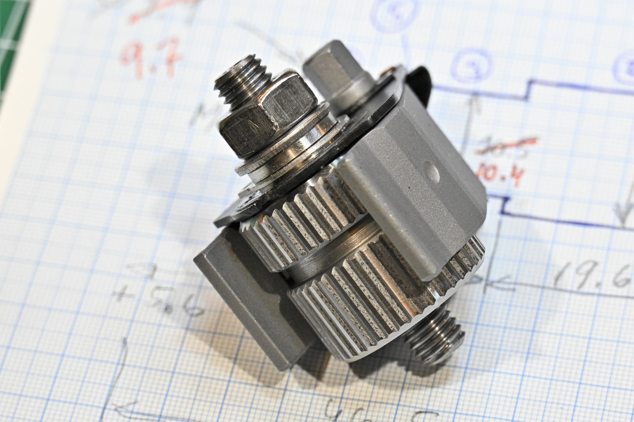

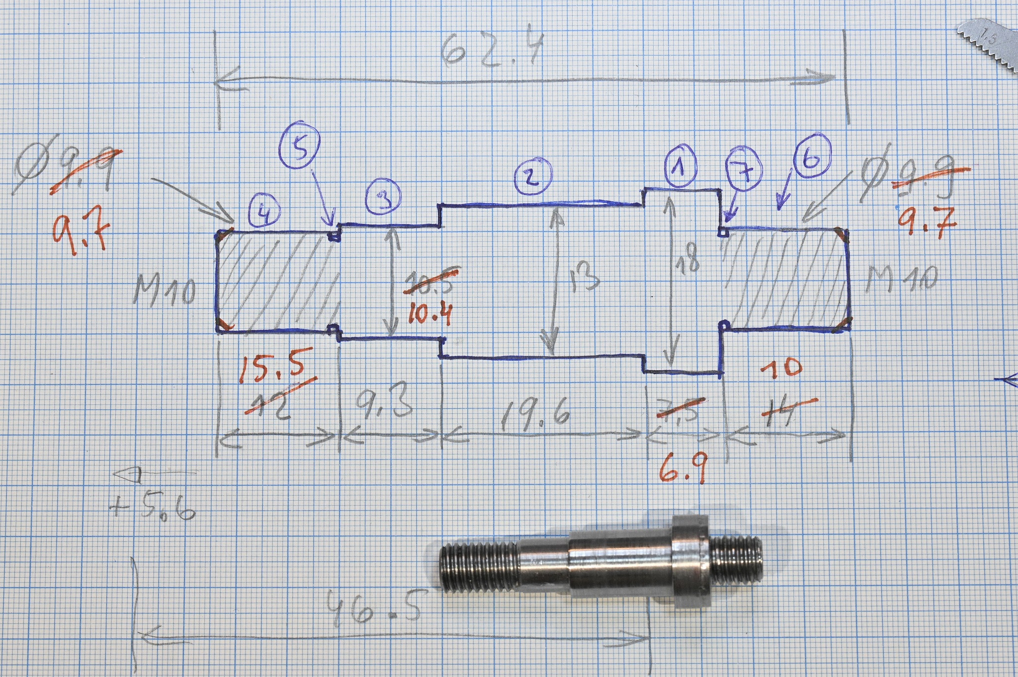

    My Multifix type tool post arrived and I used it also. It is way better than the aluminium quick change tool post I used before even if it is just fixed with a simple M10 bolt. However, the first use I made for it was to create a tool post holder screw. I measured all the dimensions, found a piece of steel rod in a hardware shop near me which I could use and made the tool post holder. It took some time and not without mistakes, but finally it is ready. It is not perfect, but will be much better than the threaded rod I used originally. I will probably make a new one without the mistakes, now that I learned something while making this one.

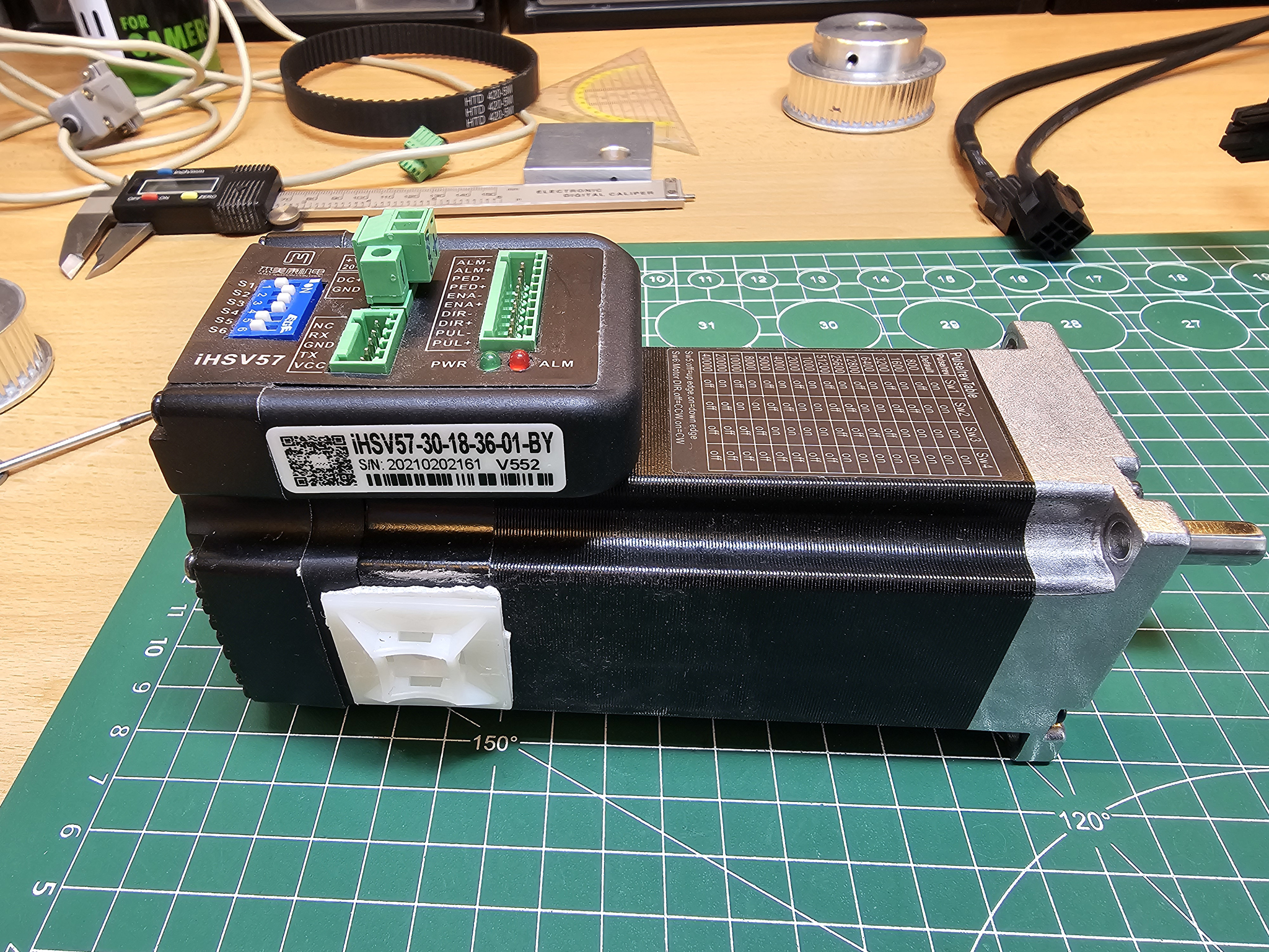

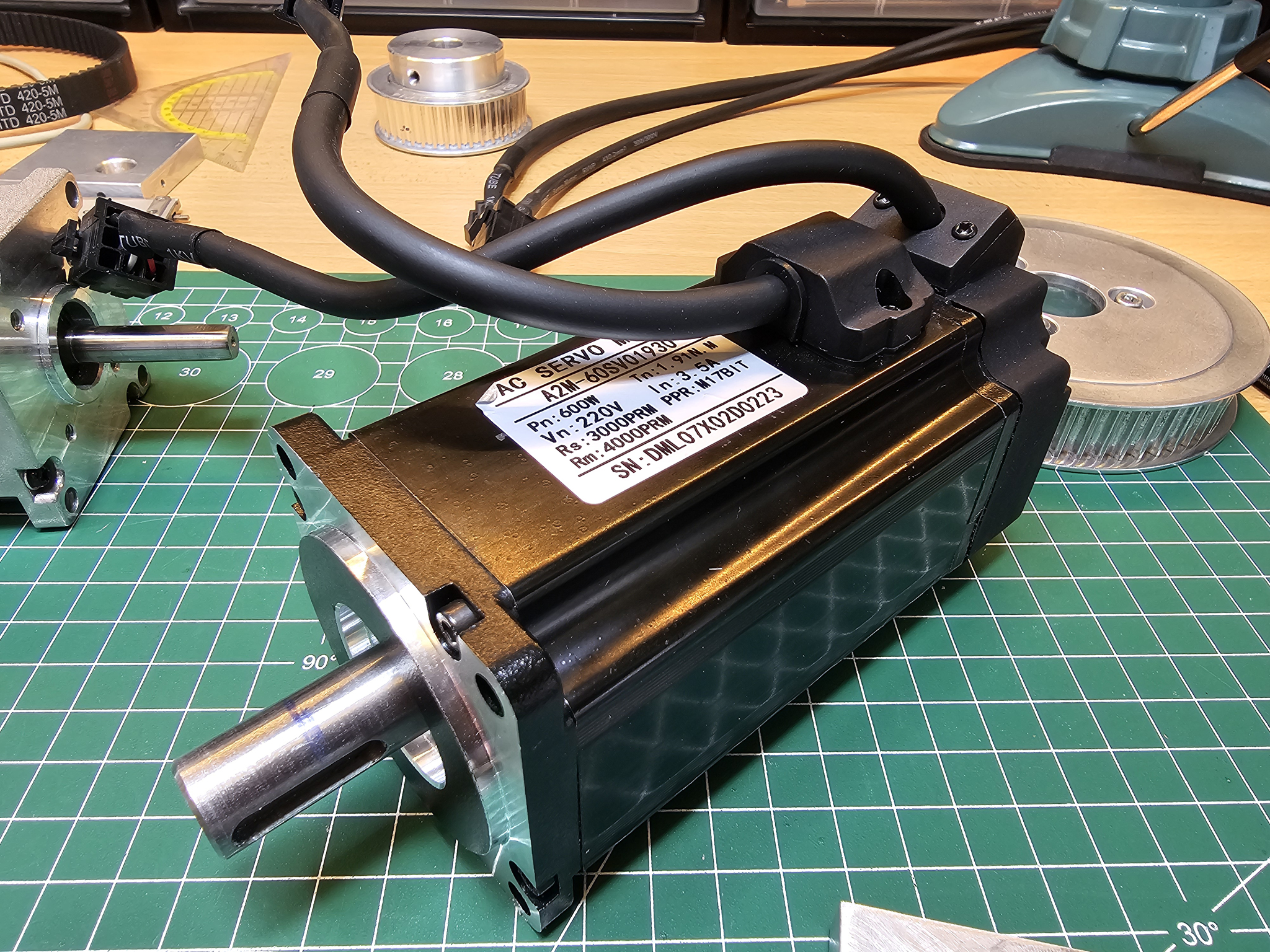

    I decided to make an upgrade (actually more than one...) of my CNA lathe.
    Number one update is to change the spindle motor.
ID:	32276 Click image for larger version.
ID:	32277 Click image for larger version.

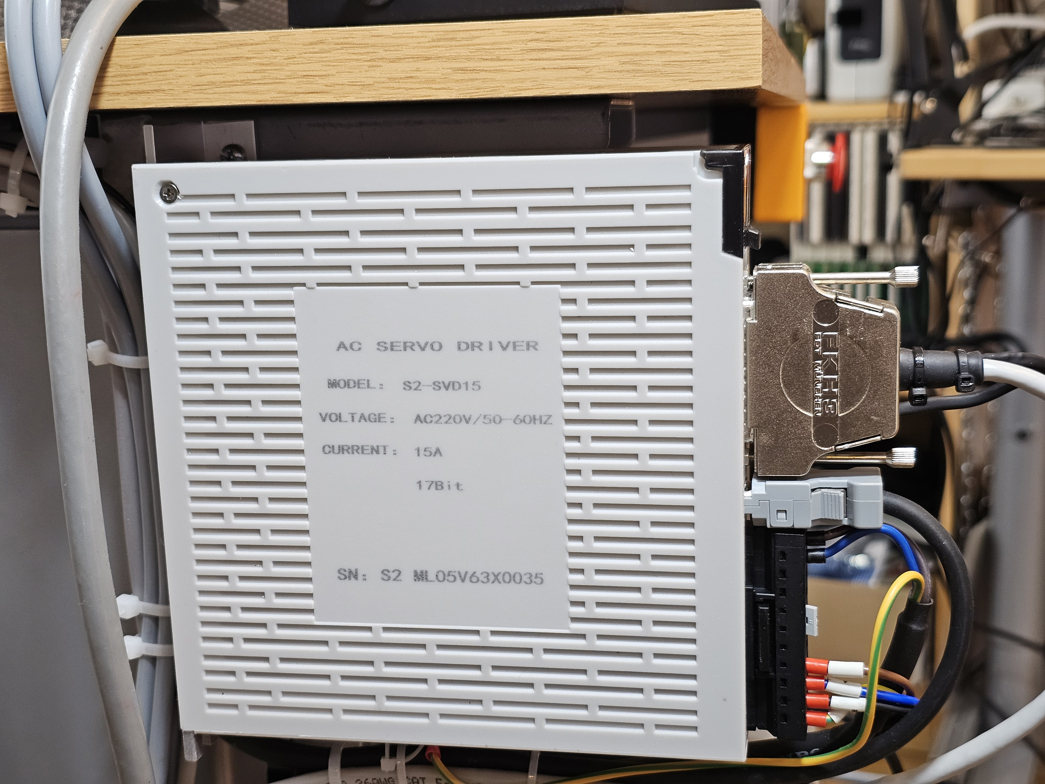

    While the 180W 50V DC servo works surprisingly well, I want some more torque and higher RPM, so I bought a 600W AC servo. This motor will allow me to change the gearing from 1:3 to 1:1.5 so I will get a maximum chuck RPM of 2000 instead of 1000. I think the motor will be strong enough for me at that speed.
ID:	32279 Click image for larger version.

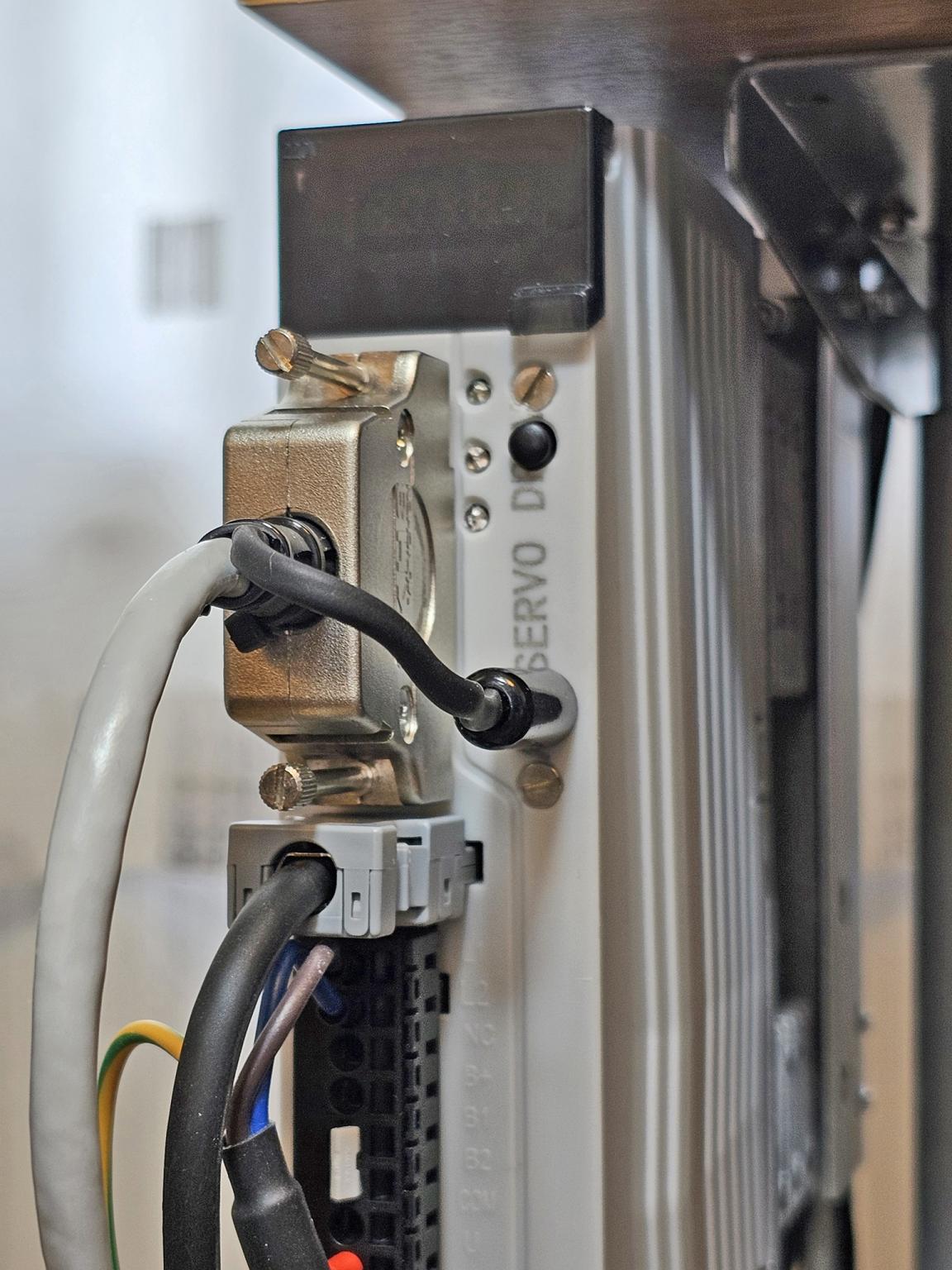

    I made some modifications to the servo driver, added three LEDs and a small relay to the four outputs, and also a button to one input. Inside the driver there is more than enough space for the small PCB necessary for this modification. The parameters are set according to the following for this modification:
    LED 1: Servo ready
    LED 2: Servo motor power on
    LED 3: Zero speed
    Relay: Alarm detection
    Button: Alarm reset
    The relay NO output is connected to a 3.5mm contact, which in turn is connected to my eStop so that when everything is fine (no alarm) the relay is energized and the contact is shorted.When there is an alarm from the servo driver the relay will break the circuit and UCCNC will stop the G-code execution and all motors and halt. When the error condition is back to normal, by pushing the button the error flag is reset and the servo driver is ready again and UCCNC can start again. Of course, this condition is emergency stop, so the code can't continue from the same spot where it stopped.
    This is all in theory and after bench tests. I can't run real tests yet, since I must make a new motor holder plate, and I won't have time to finish that work the coming weeks, since tonight I will be off to Hungary and Austria for two weeks.

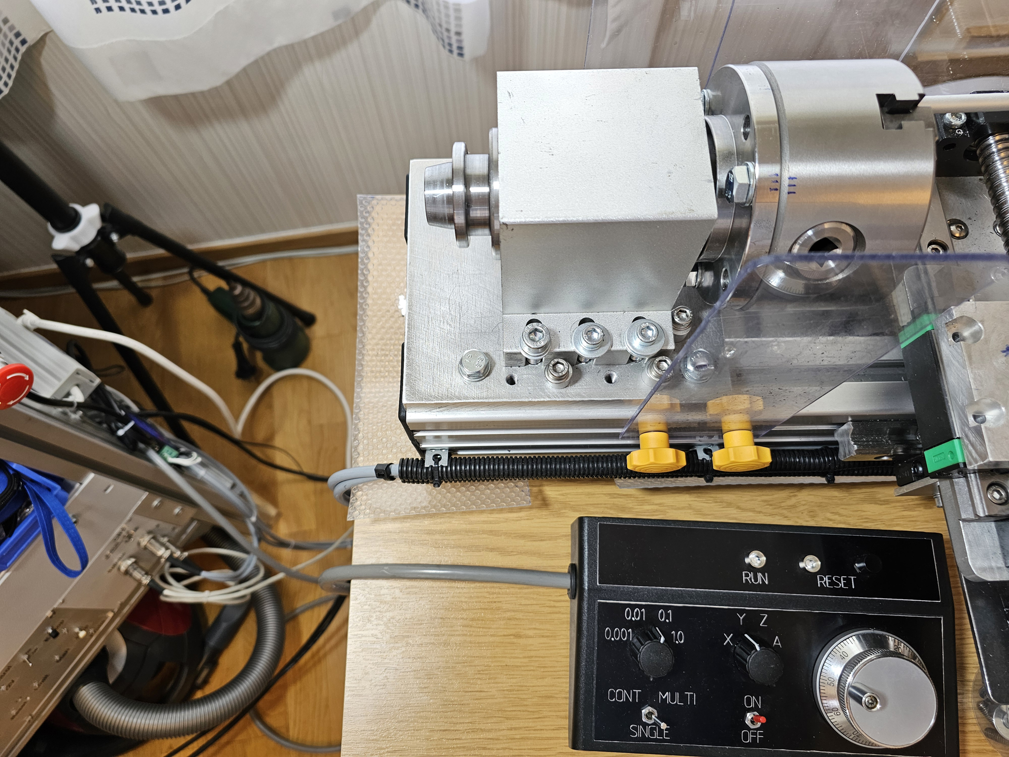

    The recent updates of my lathe turned out to be really worth wile, the 600 W servo is really making magic. Cuts steel as I never could do before and not really thought it ever will. The new servo is also a lot quieter, which is good as well, so I am very happy with it. I also changed the tool holder saddle plate from aluminium to steel, and I think also that improves things. My next plans are to actually make it a bit wider and maybe also taller. As it is, the "throat" (the space below the chuck) is too narrow, it does not swallow as much chips and swarf as I want to. It is fine for very small jobs, but as soon as I want to make something bigger, it needs to be cleaned a bit too often. Anyway, using it is a real joy now.
    This is what I made on it this week:
    The round bar was not turned down, it was a 12 mm diameter 48 mm long piece readily available, but most of the work is done on my DIY CNC lathe.
