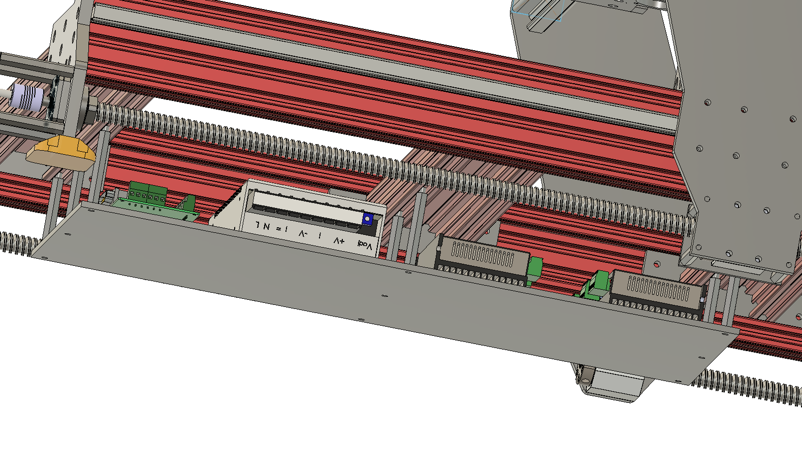

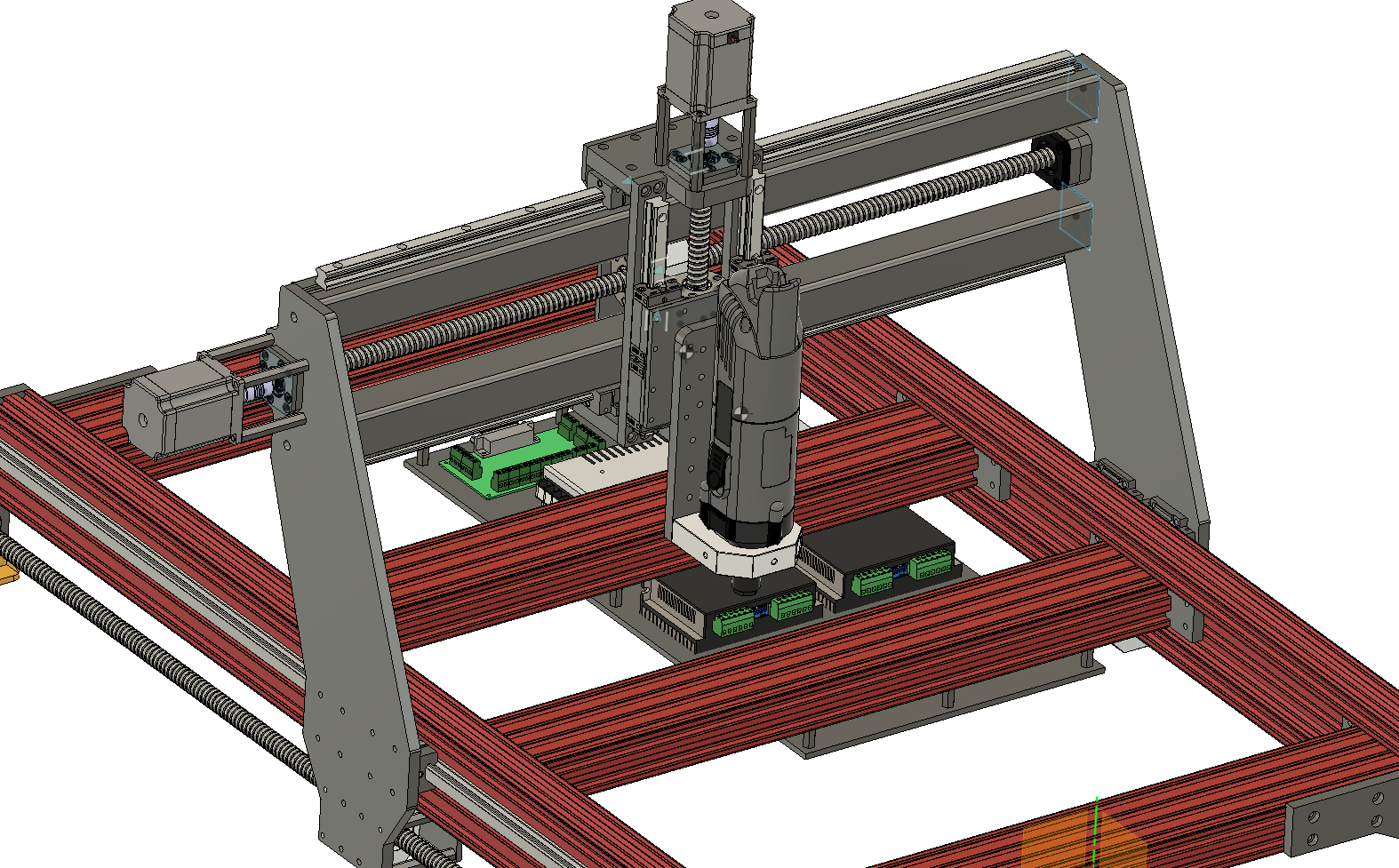

    Added design for housing electronics under the machine, I am going to put a drag chain from the gantry ballscrew to the electronics.

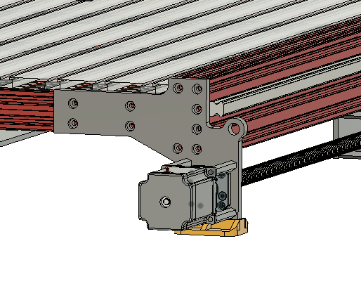

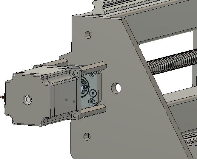

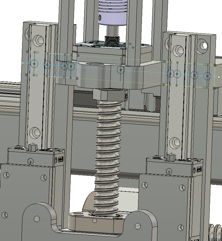

    Some minor updates, I have decided to use proximity sensors instead of mechanical switches for the limits / homing so Slight change to each axis to have mounting holes

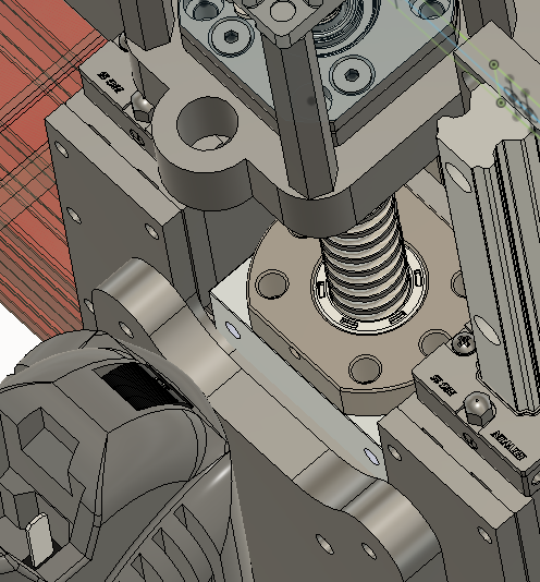

    I have also increased the length of the z axis rails to allow a accommodate 4 blocks and give me ~ 110 mm travel, and redesigned the spindle mounting plate to allow access to the grease nipple on z axis

  4. #14
    In picture 1 if the is the hole for the home switch it might be better to not hit it end on but have the target passing across the face.
    They tend to get crunched the way you have it.

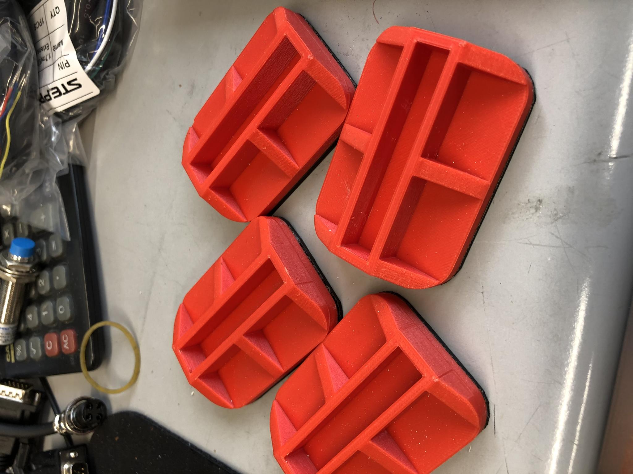

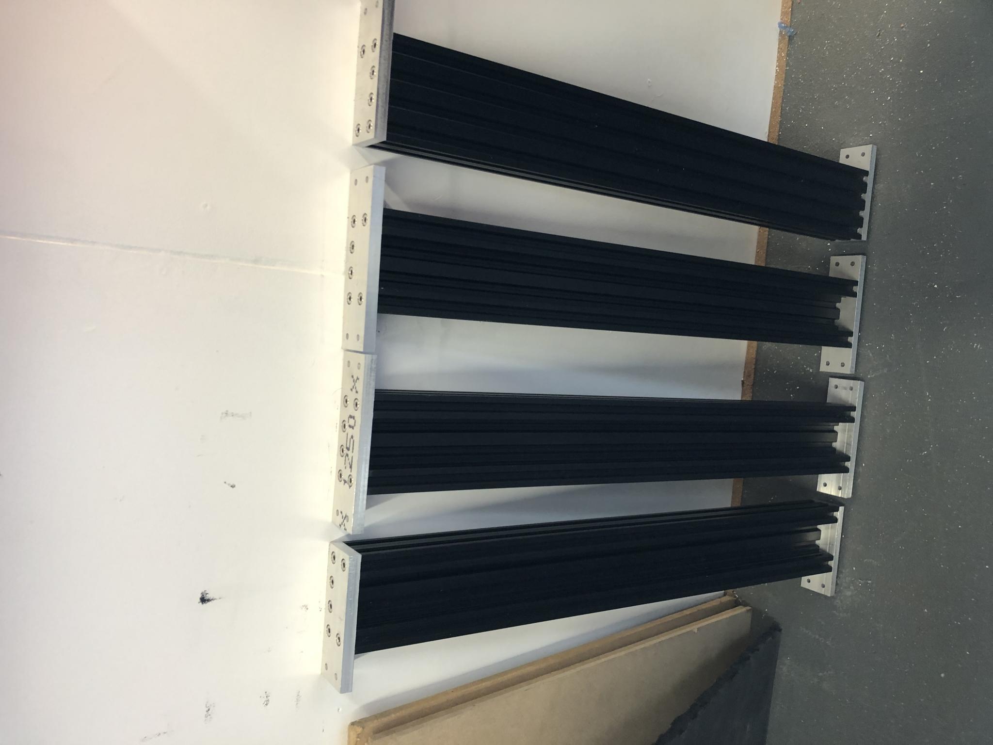

    Started the build today, small steps, 3d printed the feet and stuck rubber pads on the bottom

    Cheers for the info, I have only ever used mechanical limit / home switches, I will have a think how I can mount them
  7. #17
    I have proximity switches mounted inline - can confirm crunching....
    Definitely mount the switches at 90 degrees / not in the path so a crash / run away cannot damage them.
    Use physical stops to prevent running off the end of axis.
  8. #18
    Soyb's Avatar
    Lives in Leominster, United Kingdom. Last Activity: 12-11-2024 Has been a member for 3-4 years. Has a total post count of 38. Received thanks 5 times, giving thanks to others 2 times.
    I have the option of using mechanical switches that have enough travel to react in time to a crash / runaway so I will use them but have a play with the proximity switches to learn how they work, every day is a school day!

    Cross Beams finished, starting on feet. Once I have the base frame assembled I will start on a test setup of the electronics so I can drive the twin Y axis and limit switchesClick image for larger version.

  10. #20
    Quote Originally Posted by Soyb View Post
    Proximity switches are much better, even the cheap ones, than mechanical switches unless you buy expensive high-quality mechanical switches.
    They react faster and are more reliable, a long time ago I did a test showing the repeatability of the cheap proximity switches to show how repeatable they are, it's on youtube and this forum somewhere. But since that time I have literally fit 1000's to machines I build and I have very few issues, probably 2-3 in every 100 will arrive faulty and I rarely have any fail when in use on the machine, I can't remember the last time I had one fail on a machine.
    However, everyone I've fit slides by the target rather than face on. They sense and repeat just fine when sliding past the target and you don't risk crunching them if crashing the machine at high feeds where inertia will cause overtravel even though the switch reacted quick enough.
