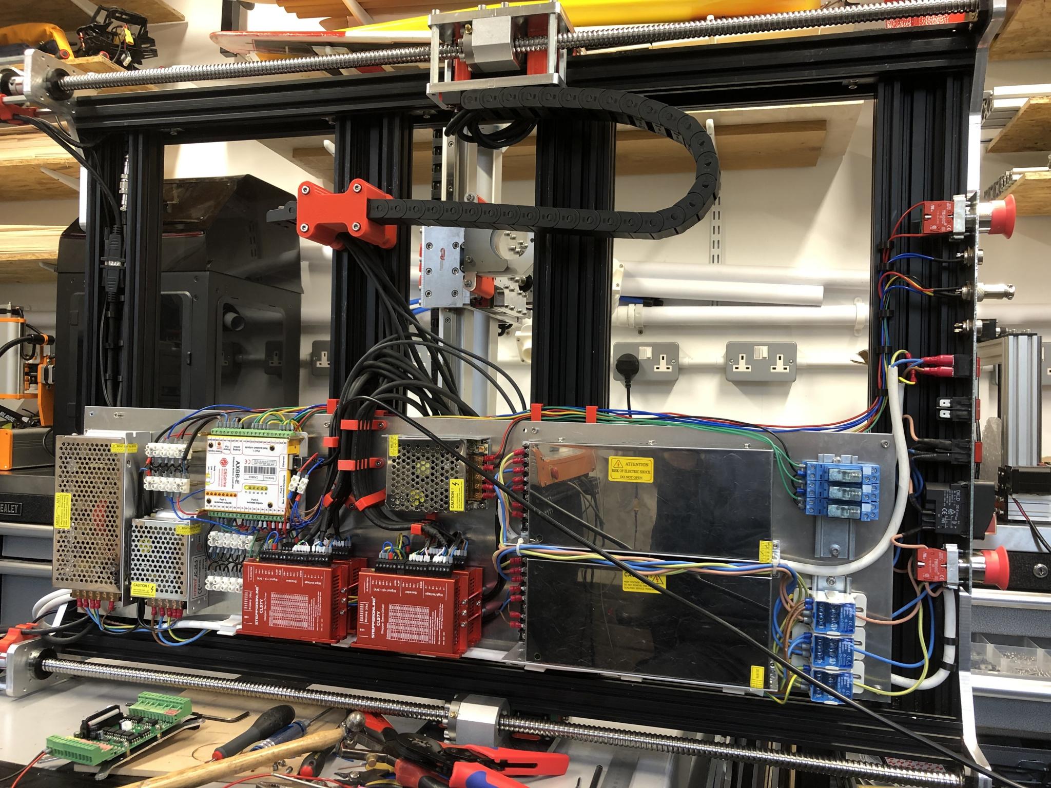

    Latest up date, just finished the electronics, tested limit switches, working on feed rates.Will have it the right way up tomorrow.

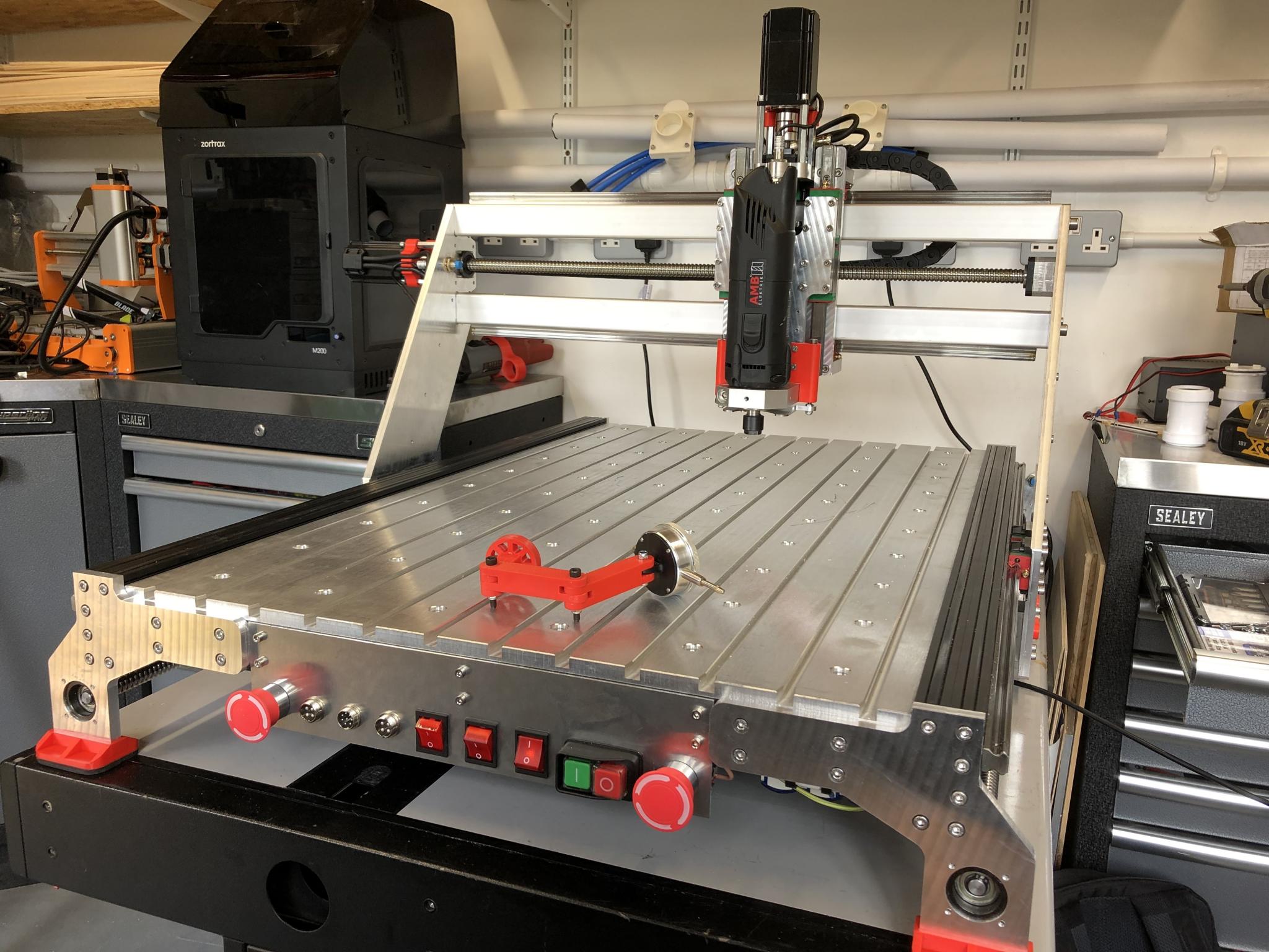

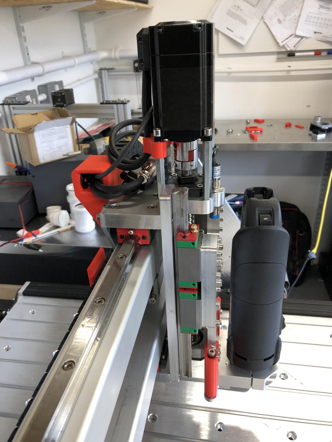

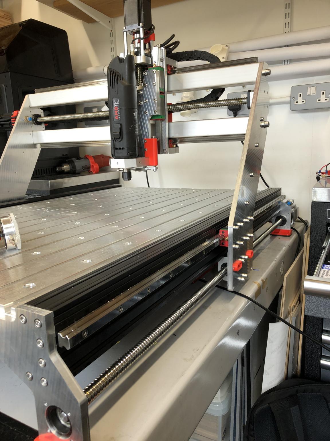

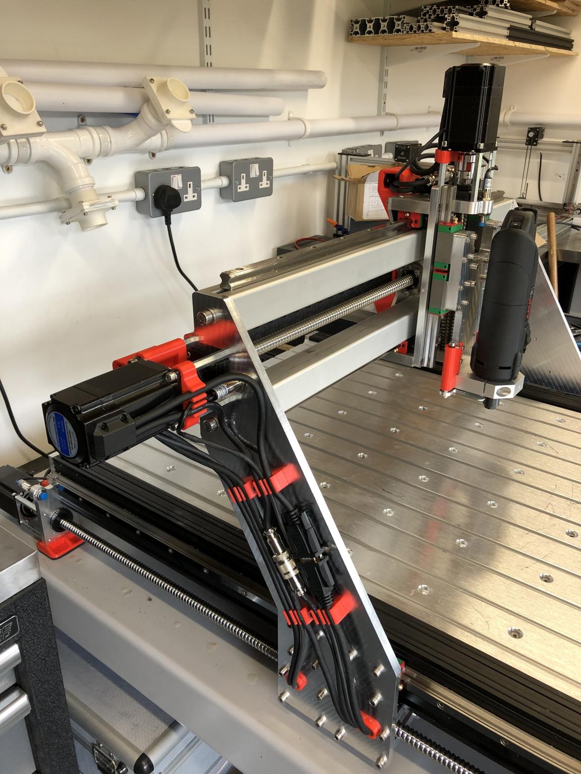

    Finished (albeit a bit of fettling). Waiting for a optilaser to clear cutoms, need to re cut the rear panel for power connectors, need to decide if I am going to use the AXBB-E to power spindle, need to to replace 1 proximity sensor on the Y axis after a issue homing with two sensors. I have now set it up to use use the same sensor to home the Y axis and slave C axis and manually square the Y axis. I have closed loop steppers so there should not be an issue with alignment. I have added the USCB so I can add a 4th axis if required.
    I think the machine has cost approximately £2000, and for that I have a CNC machine that is capable of cutting all the materials I use with an accuracy / reliability far greater than my Stepcraft. Compared to most machines on this forum it is in toy category but it is ideal for what I want it to do, I can use a laser attachment, vinyl cutter etc.
    Thanks to the forum for all the help, now to actually start doing some cutting!

    It looks like a nice clean machine, well done.
    If you can I would put a WC spindle with vfd on it.
  7. #36
    I am making similar machine 610x1220mm working area (1/4 of full size board, but with wide gantry so half size board can be supported by bed.
    I like your design - got very similar on 30x60 IR profiles from KJN
    Wonder if your side gates gives enough stiffness/rigidity?

    Hi Tom, I was using 10mm plate for side plates but replaced them with 15mm. What size spindle are you thinking of using? My machine was designed for making RC planes so I only cut wood, and thin aluminium. I use a 1kw AMB (Kress) spindle. This adequate for my needs. I have been using the machine in a small workshop and haven't had any issues with it, accuracy is about 0.01 mm.
    If you are going to use a bigger spindle then you might want to redesign the side plates by doubling them up. I only had a Stepcraft D800 to make parts for my machine so I was limited to what I could cut and accuracy.
    Have you thought of using
    https://vallder.com/product/cnc-x-ax...rofile-200x96/
    I used C-Beam but only one rail, if you are going for a beefier machine then you could add another rail and 2 x 10 mm side plate
    I hope this helps
    Ian
