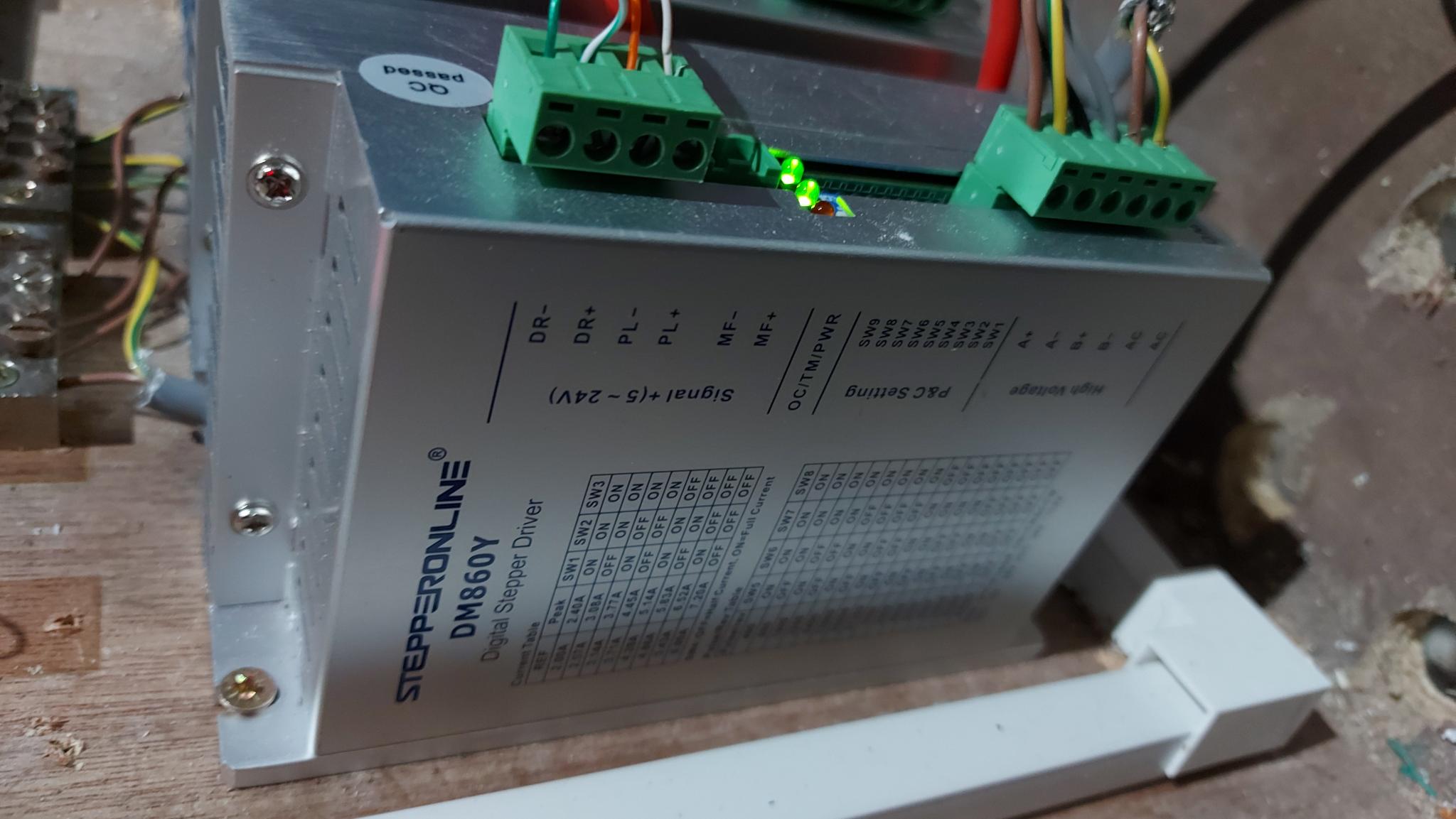

    hi all, im after a little help. i recently upgraded to uccnc and two motors on the x axis. i cannot get movement from them. my y and z axis work perfectly. i am using a uc300 eth, with a stv2 breakout board. i have two matching drivers:
    https://www.omc-stepperonline.com/di...-34-motor.html
    Attachment 29658
    everything seems to be right, but i get no movement. i am getting the correct voltage to the drivers, and the dro's move correctly. all the settings seem correct and the motors lock when powered on but still no movement.
    I'm at the point of pulling my hair out now, please help

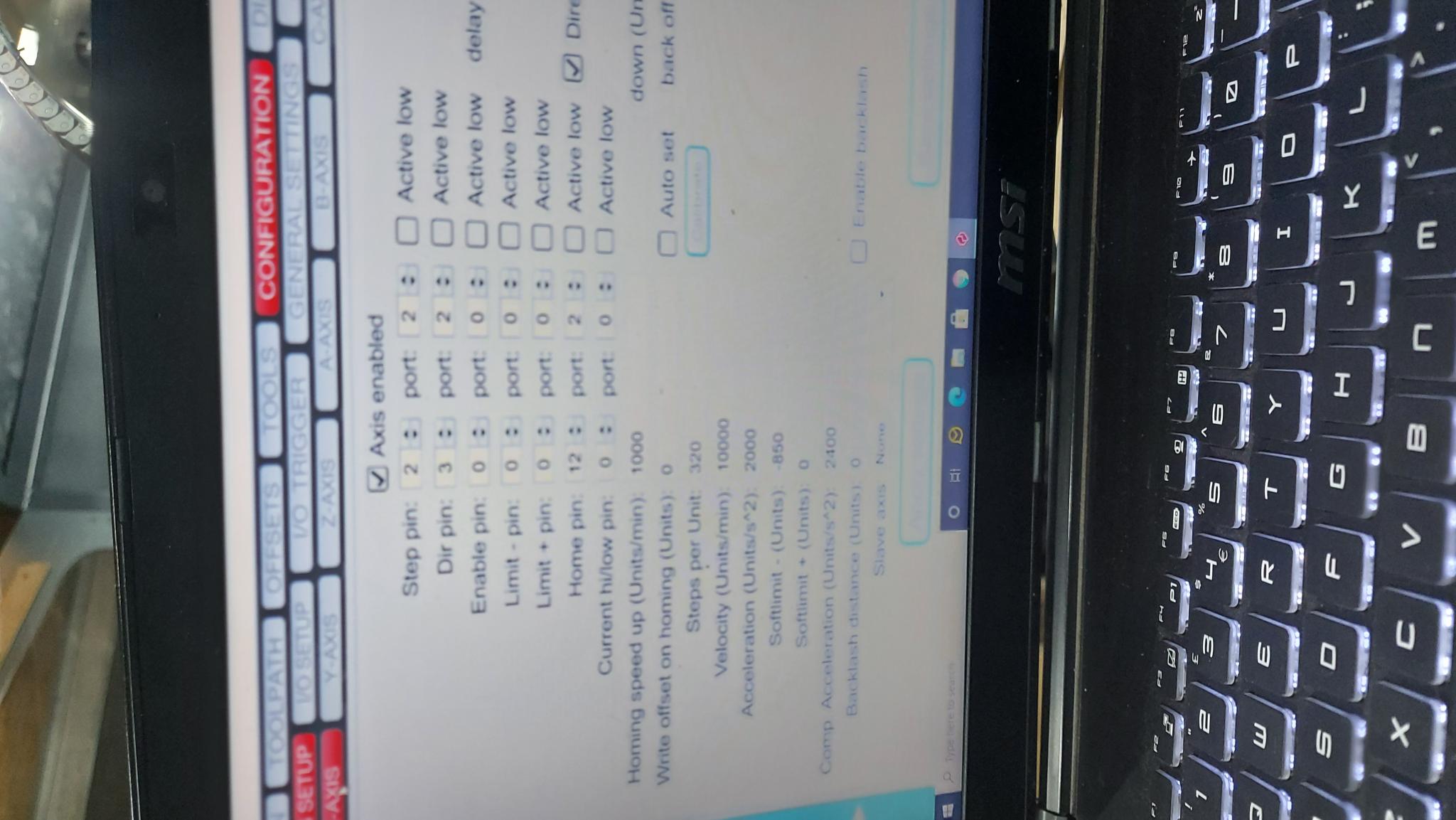

    Do you have a diagram of how you've wired these drivers? - it might help find your problem. I also notice on the first screen that there's no enable pin listed, could this be an issue?
    yep im not using enable. maybe i should, im not using it on my y and z and they work. i have x step pin 2 to step- on the driver x dir pin 3 to dir- on driver and +5v to step+ and dir+. motors are 8wire 4nm nema23 from cnc4pc which are wired bipolar parallel

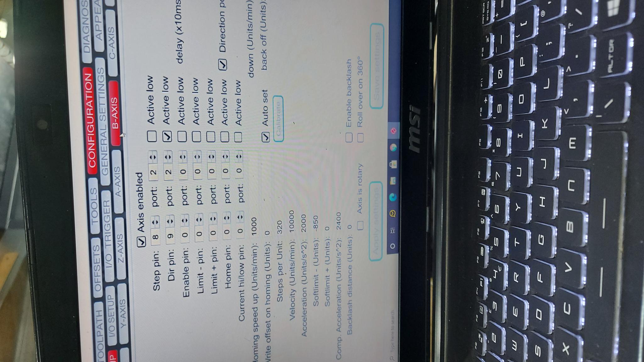

    Looking at the manual it seems that the MF input on the driver is more of a disable than enable function, so maybe that's not an issue. On your screenshots I see that the B axis DIR is ticked as low active, whereas X axis isn't and neither of the STEP outputs are set as low active either - have you tried setting these?
    Had a play around this afternoon and I have my x and b axis working. I set both to active low step and all of a sudden they work. Unfortunately my y axis now doesn't, even though it did yesterday.
    No settings have changed, I checked all the wires are still connected, but I just get a faint click when I try to jog the y.
