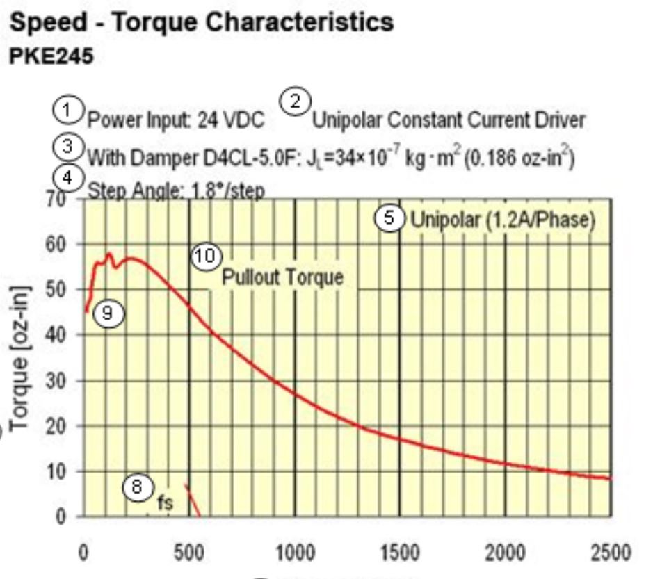

    Have a look at the torque-speed curves for the stepper motor you are considering. If you fitted a 2:1 reduction gear you'd double the stall torque perhaps. But if the torque at a new, doubled operating speed had dropped to half of what it was, you'd have gained nothing - you'd now have the same final torque at the same speed but you would have halved your max speed (the all important "rapids"!). My conclusion is that you might as well go direct drive with steppers.

    Here's a randomly chosen image from Oriental Motor, showing a typical torque speed characteristic for a stepper motor:
    https://www.orientalmotor.com/steppe...er-motors.html
    If you gear down the output by 2:1, you might move from eg 500rpm to 1000rpm and in the process you'd drop from a pullout torque (loss of position) of ~45oz-in to 27oz-in (forgive the Mercan units). After the supposed doubling up of torque through your expensive reduction stage, you'd actually end up with ~54oz-in. That's an increase of ~20%, not 100%. See what I mean? Some of the Chinesium steppers have even worse torque curves. Sure, you double the stall torque but unless you plan to use your machine as a press, that's not much use to anyone.
