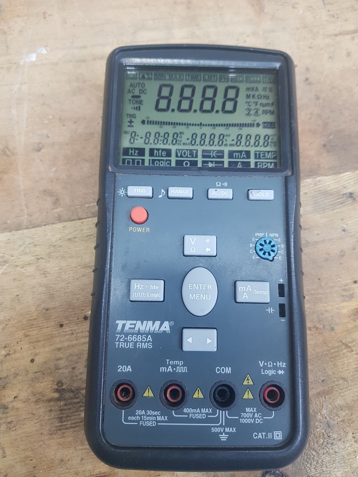

    I recently got a bulk salvage auction win and this was one of the meters which has a lovely large screen. I got it running and went to test it on a socket to test how accurate it was and blew the 500ma glass fuse in the back. Replaced it and still on pressing the on/off button this is all the meter will display, I've checked over the components inside for damage and checked the ceramic resistor too but that is also fine.
    Un-able at all to find any information on this specific meter, almost like it never existed to a point.
    Has anyone at all ever come across this situation or any knowledge with where to look next?

    Rob,
    Only thing I can suggest is that you give it a hard reset by removing the battery completely, not just switch it off.
    Kit
    RobC's Avatar
    Lives in Leeds, United Kingdom. Last Activity: 10-04-2026 Has been a member for 8-9 years. Has a total post count of 118. Received thanks 16 times, giving thanks to others 21 times.
    Sadly still no change, left it out for a few hours but nothing.
    If there's no obvious other damage then I can't think what else to try.
    Kit
    Hate to say it but I'd be thinking of "letting go".
    There'll be one chip that does all functions including the LCD drive - if that's borked then....

    I've tried all sorts, I've managed to get a sporadic reset to where it reads but doesn't actually do anything but on a power cycle reverts back to the issue. We tried but no worries, cheers for the help guys!
