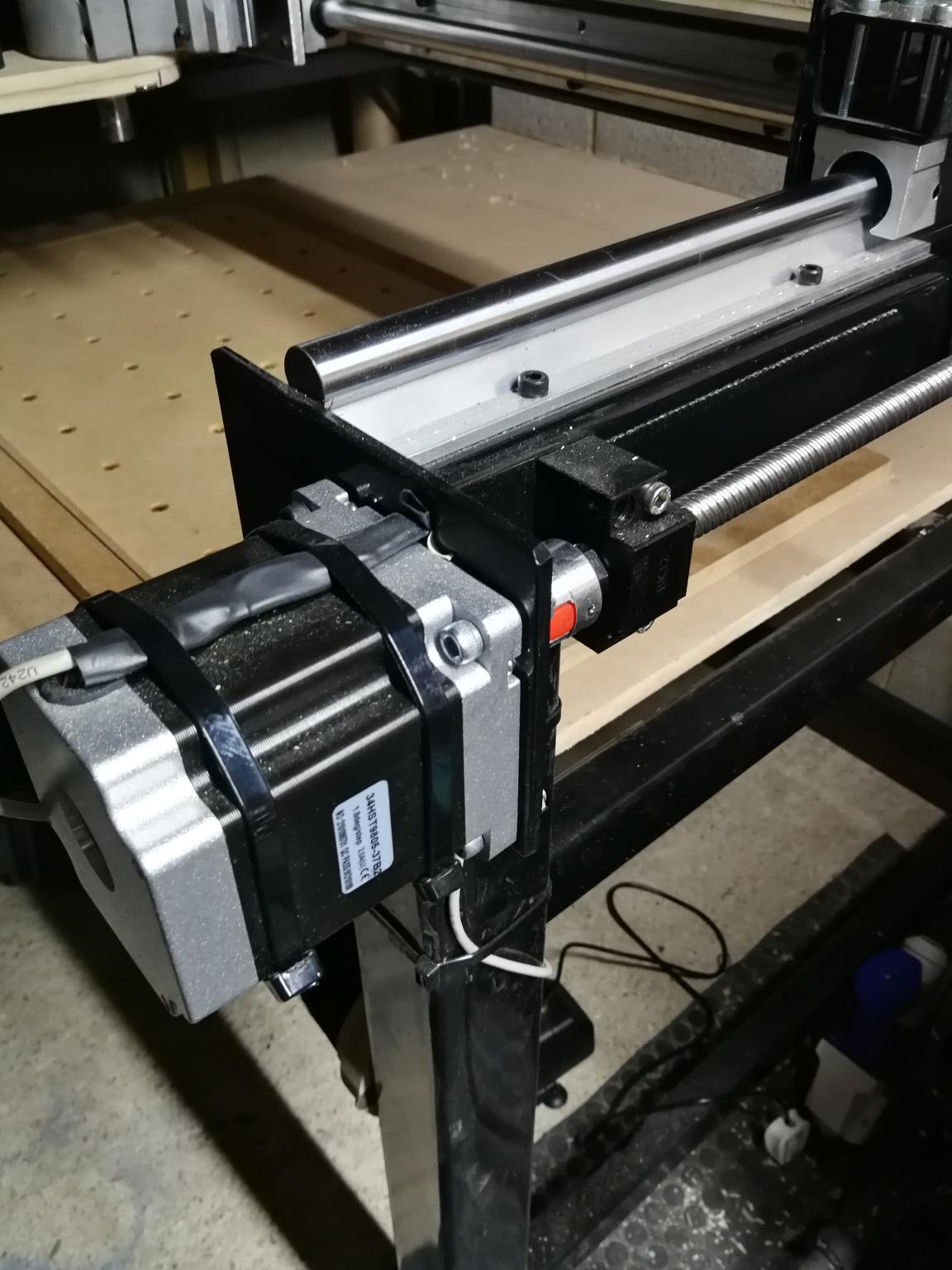

    I've tried attaching a few pics of the machine but I cant attach more than one for some reason.
    His advert on Ebay says I can return within 2 weeks but the problem is that I didn't pay him through ebay - it was done privately.
    The power supply is a Meishiie S-1200 -60
    Output 60V and 20A.
    Drive controllers are all DM860A

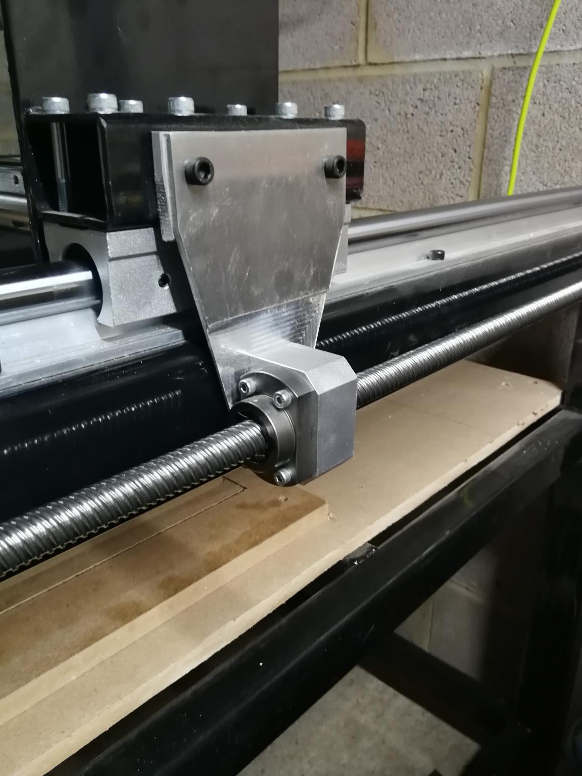

    Frame seems very sturdy. There is no play or axial movement between rails and ball screw blocks.
    What do you think is the best way forward from here?

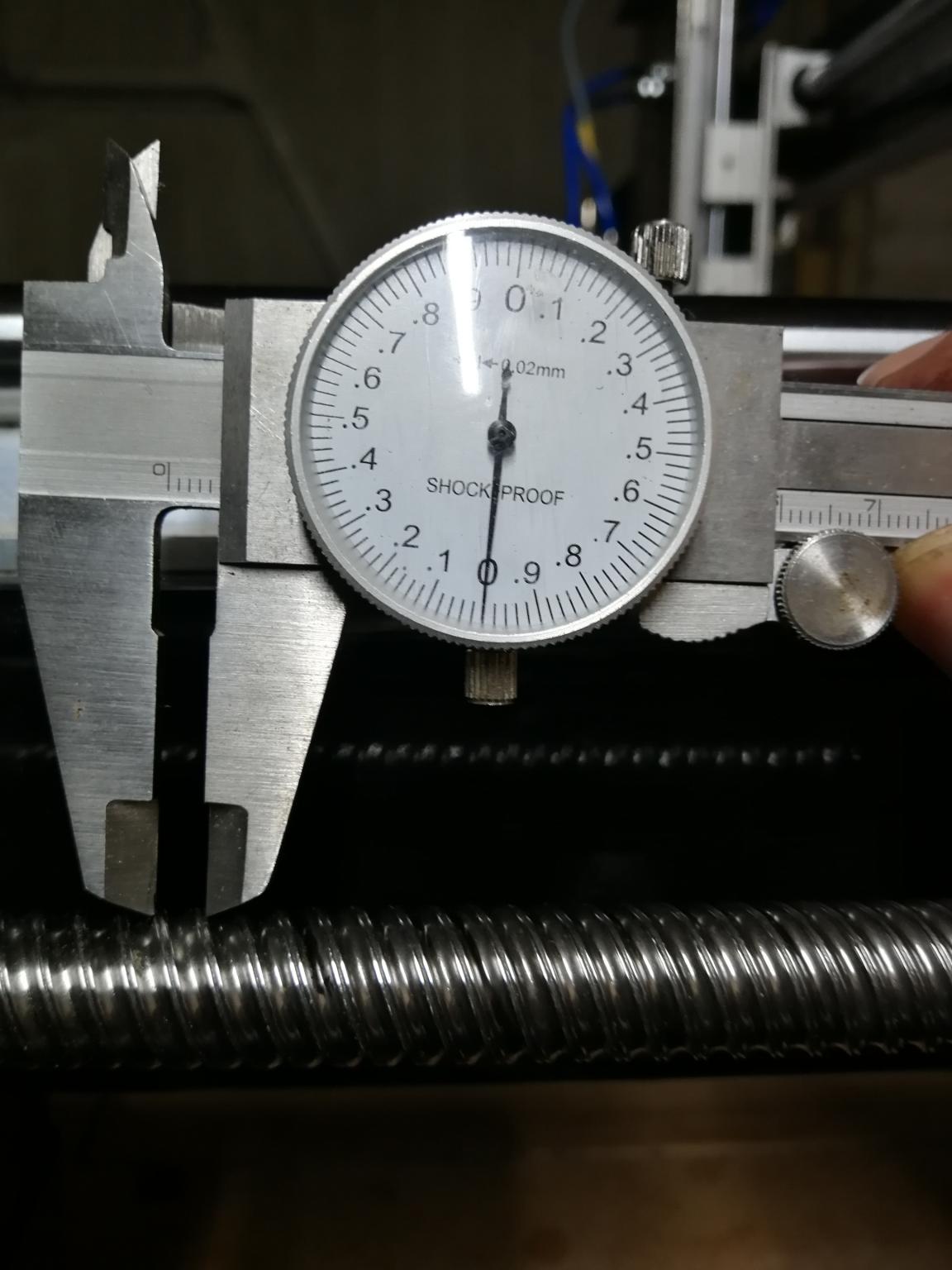

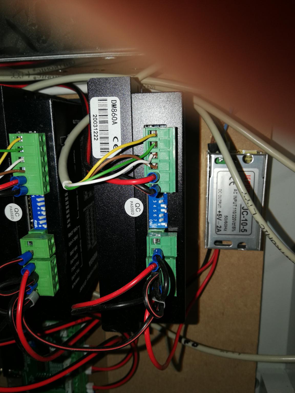

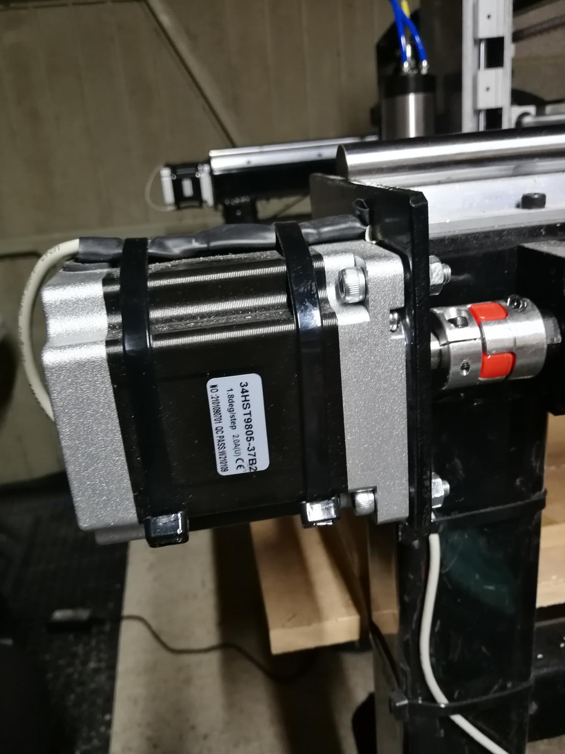

    Here are a few more pictures.
    5mm pitch lead screw
    34 Nema
    Drivers showing jumper positions (Off - On - On -Off)
    Measuring like that can be misleading because the screw could be a twin start so that would be 2 x 5mm starts making it a 10mm pitch. This is why I said rotate and measure the distance it moved as that is the more accurate method.

    Quote Originally Posted by grantx View Post
    Ok with those settings using the manual I'm looking at the micro-steps are set to 2000. This doesn't ring true to the mach3 steps per setting because it should be 400 if 5mm pitch and 200 if 10mm pitch. You have mach3 set at 125 Steps per which means you can not possibly be moving the correct distance unless the screw pitch is different to 5 or 10mm which I very much doubt.
    The motors are 1.8degree so 200 steps per 360degree's and clearly direct drive so there are no ratios applied so that only leaves the screw pitch which can affect the movement and I'd be very very surprised if it's anything but 5mm or 10mm. This means it can't possibly be moving the correct distance unless the dip switch settings are wrong.
