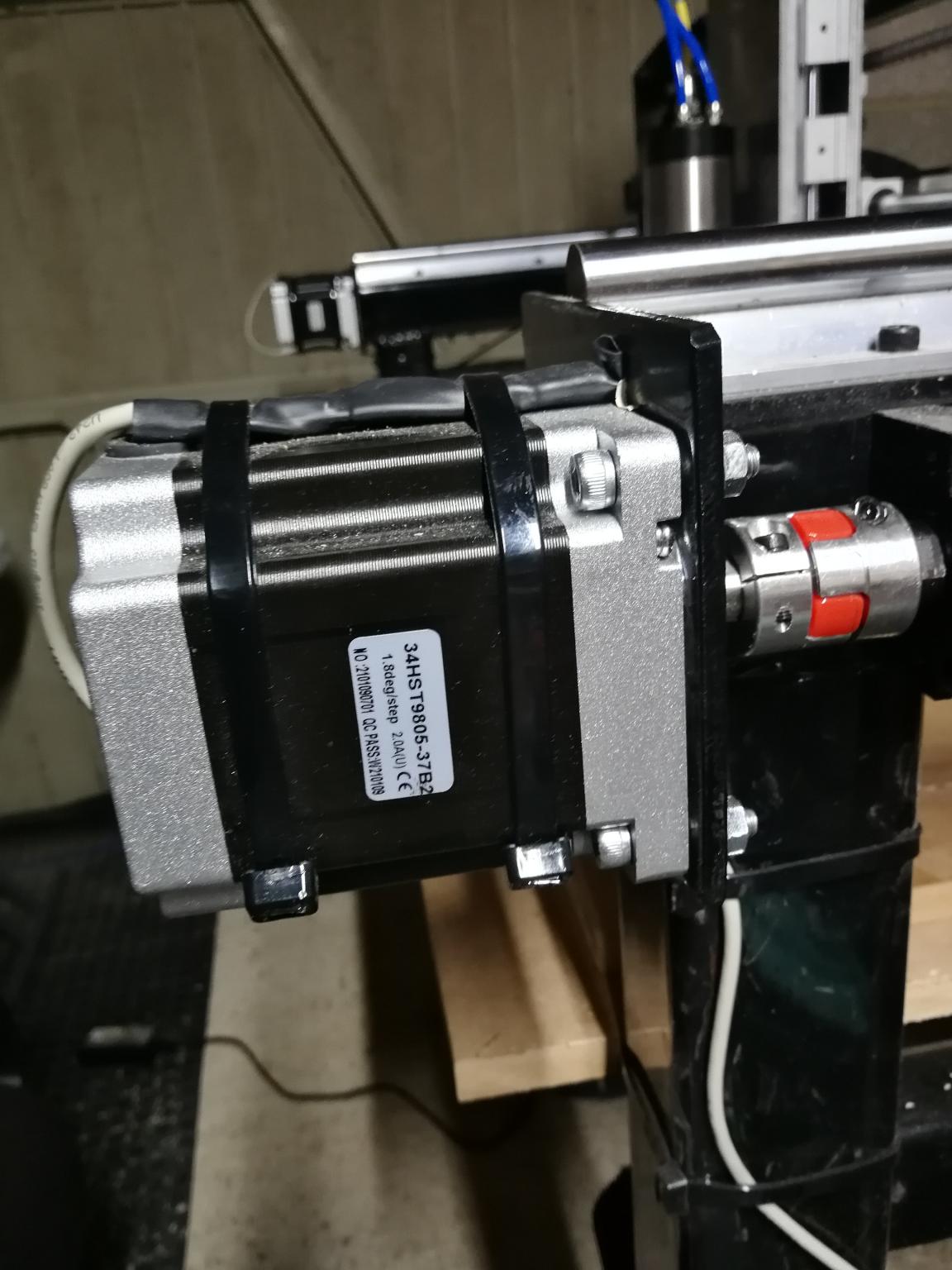

    Oh, here we go again, I'm truly sorry to have to say this but for that particular machine then yes it's about right.!! That doesn't mean it's correct, it's very wrong.
    The problem and the noises you are hearing won't be from one thing, it's a mixture of things. I have had plenty of experience with these machines bought from eBay and they are so badly engineered and constructed that a good percentage of the noise will be from poor alignment and setup of the ball-screws.
    The next issue is that they are never set up regards motor tuning and micro-steps etc, don't know if you bought it directly from the guy in Peterlee or not but nearly everyone I've encountered hasn't come with Mach3 setup at all.
    The third issue is that they use Nema 34 motors and often with a low voltage PSU which when combined with cheap drives or poorly setup drives they perform like a can of marbles due to resonance, this resonance is mostly what your hearing as the drives are either setup wrong regards micros steps or just not dealing with the resonance, which is also compounded by the poorly aligned and setup ball-screws. Resonance can and does cripple the performance of a machine and not to be underestimated.
    The first port of call is to check what micro-steps are set on the drives.?
    Do you know the voltage of the PSU feeding the drives.?
    Is this using the UC100 controller.? ( This connects to the KK01 and goes to the PC)

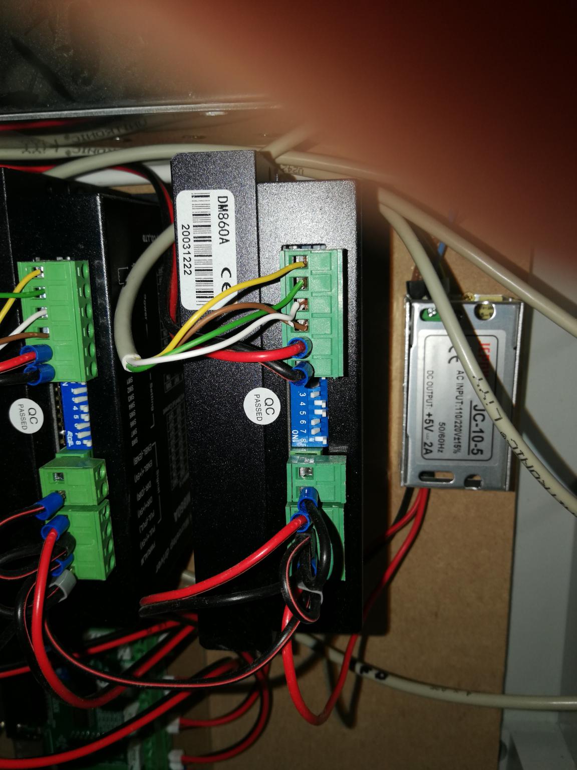

  9. #6
    Ok well, straight away I can see something is odd because 125 Steps per setting doesn't add up.? The DM860A doesn't offer a micro-step setting that matches this setting when used with a 5mm pitch ball screw driven direct from the motor like what you have. 5 * 125=625 and the nearest micro step setting in the manual I'm looking at is 640.
    This is even more confusing if you are 100% sure that it moves the exact amount because it shouldn't unless the drives are using a different setting to what the manual I'm reading says or the ball screw pitch isn't 5mm.?
    Both these are easily checked, the drives will show the dip switch settings on a sticker and you should be able to match the dip switch positions on the drives. To find the screw pitch then just jog or manually turn the screw one revolution and measure how far it moved.
    However, If I'm correct and the pitch is 5mm and you are correct that it's accurately moving the distance told then at best the micro-steps setting must be 625 and this could be the problem.?
    These drives I think are the cheap nasty analog version and they will at best only have basic resonance handling built into them, Analog drives are notoriously bad at handling resonance and to be honest, should be gone the way of the dodo by now.!
    You will find if you change the micro stepping on the drives to 1600 that the motors will run a lot smoother, you will also need to change the Steps per in the motor tuning to match.
    This is done by dividing the Micro steps by the ball screw pitch ie: 1600/5=320.
    Doing this will change how the motor operates and hopefully will shift the resonance into a range the drives can deal with. You will instantly hear the difference.
    Analog drives are old technology and it was common to have to play with micro-steps to try and find a sweet spot, esp if used with cheap motors which these probably will be.?
    All this said though your problem could still be a mixture of mechanical and low-quality electrical that is poorly set up so if you are thinking to send it back then I wouldn't touch it.
    Also, if it does run smoother you still have a machine that isn't fast enough to cut at the correct feeds n speeds for most materials and while you think the frame is sturdy I can tell you it isn't really and the way it's constructed means it cannot be accurate which you will come to realise in time as you try to do more intricate work or complex work.
    So again my strong advice is to try to return it because you'll will still have a lemon if you get it running smoother.

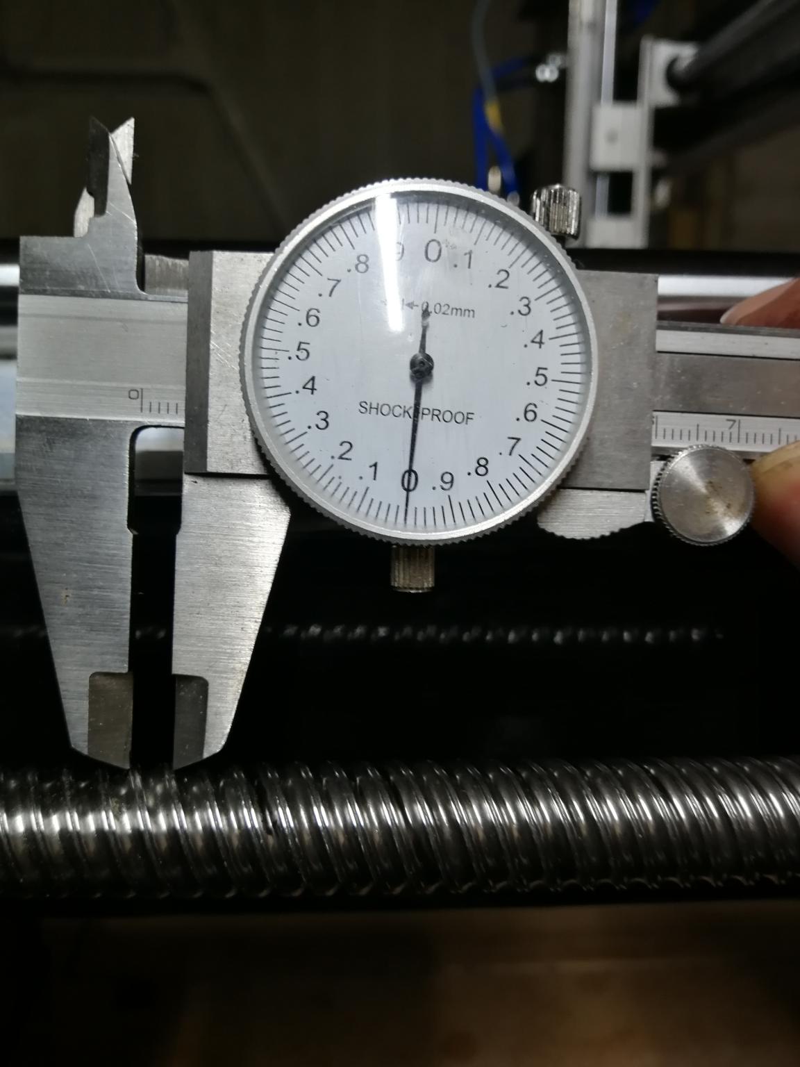

    Here are a few more pictures.
    5mm pitch lead screw
    34 Nema
    Drivers showing jumper positions (Off - On - On -Off)

  12. #8
    Quote Originally Posted by grantx View Post
    Measuring like that can be misleading because the screw could be a twin start so that would be 2 x 5mm starts making it a 10mm pitch. This is why I said rotate and measure the distance it moved as that is the more accurate method.

  13. #9
    grantx's Avatar
    Lives in oxfordshire, United Kingdom. Last Activity: 2 Weeks Ago Has been a member for 4-5 years. Has a total post count of 23.
    You are right. I dont know what I measured before....
    1 revolution gives 15mm travel on the Y axis (I havent measure the others)
    When I tell it to move 100mm (G0 y100) it moves 150mm.
    EDIT: Ok I remember how I measured it before. Using the auto-calibrate in Mach3 I get it to move 100 on the y-axis and it moves exactly that. It tells me the steps are 125, So that must be correct.
    I dont know what that G0 y100 command is doing ...

  14. #10
    Ok well, 15mm isn't a common pitch size but they do exist. However still, things don't add up.?
    The drives are set for 2000 micro-steps and your direct drive to the motors. 2000/15=133.333333 Steps Per mm.
    If we work it backward just in case the drives dip switches are telling porky's then from the Mach3 Auto calibrate setting 125 steps per with 15mm pitch this would give a micro-step setting of 1875.? I've never seen drives that allow this setting and the manual doesn't show it either.?
    So something isn't adding up here at all.
    Regards the G0 y100 command then it will move to y100 coordinate position which doesn't mean it will necessarily move 100mm. If you Zero the DRO then it should move 100mm.
    To move a set amount without worrying about the coordinate location then you need to switch to incremental mode, try this next time.
    G91 G0 y100 and it will move the amount asked for from the current location. When finished type G90 to put back into absolute positioning mode.
