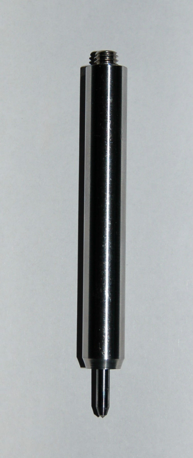

  1. Hi All,
    On Ebay:
    http://cgi.ebay.co.uk/ws/eBayISAPI.d...m=150838094505
    Drag engraving tool for half inch routers. I made half a dozen of these but it seems no ones interested.

  3. Hi George,
    A proper CNC engraving tool is not just a pointy bit of metal. The depth of cut is very small. This makes deviation in the height of either the job or your table a real issue. To compensate you require to spring the engraving point so that it can move up & down. This in turn requires that the fit of the engraving tool in its holder is nuts on as any sideways movement will show up on the job.
    The amount of compression has to be adjustable and that means a method of adjustment plus you need to start with roughly the right strength of spring which means having a large selection or making your own (which is what I did).
    Now we come to tip geometry. The tip should be machine ground to 120 degrees. Not the tighter angles you see on scribes and pointers etc.
    So, you could make your own for less than a tenner but you couldn't buy one that'd really do the job for a tenner.

    Hi Wilson
    Will it cut steel or is it only sprung for Al?
    Will it cut deeper if I go around again?

    Robin: The tool will cut glass, so yes, it'll cut steel, stainless, DO1 tool steel, you name it. If you want a deeper 2nd pass, add a bit of Z. Maybe 10 thou but you should, with a bit of experimenting, be able to get the depth you want in one pass.
    The spring rate is just one parameter. There is a pre-load grub screw in the end, plus you've got the Z to think of. The spring is *very* stiff. You need almost no pre-load at all for acrylic & ali.
    BTW, just so we're clear, this is a 'drag' engraving bit. It does not rotate. You basically push it in as far as you need and 'drag' it around the surface.
    Lee: I think I've covered your points. One additional thing though... as the tip is sprung you can engrave curved objects like pens, buckles, golf balls, pool cues, etc, without having to program in their profiles. Which is nice.
