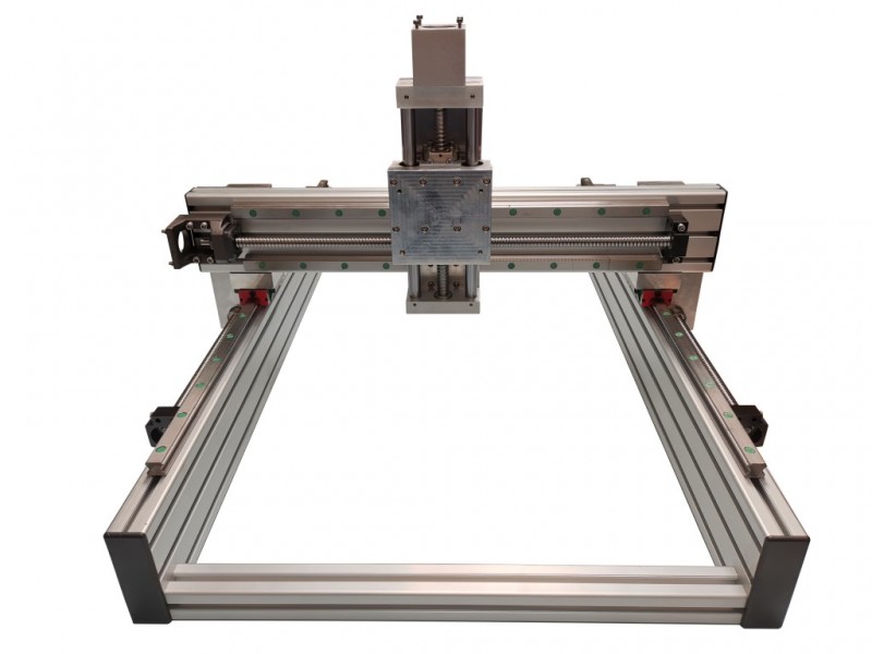

Ok first off I wasn't having a pop at you or trying to discourage you with negative comments. Most of what I said was and nearly always is said for the sake of others who are thinking to build and reading this. It saddens me that I have to do this and use you as an example of "How not to do it" and I know with 100% certainty, because been here many times before, that if you had done more research and made at least minimal drawings this wouldn't have happened.
Regards learning CAD then how do you think you are going to create parts to cut without even basic CAD.?
These things would have happened on those kits as well, they just don't tell you these trivial details.
Ok well nobody's giving up on my watch.! . . .So if we can't make a stubborn bugger listen then I will just have to help him get it sorted out and working..
You probably won't need to scrap the ball screws and I'm sure we can make something to extended them if your only 40mm short, you may lose 40mm travel but won't cost you anything.
However, before we or I can help you further will need to give me a detailed list of what you have and the length and dimensions. Either post it here or drop me an email and I'll help you get this together. YOU ARE NOT GIVING UP..
