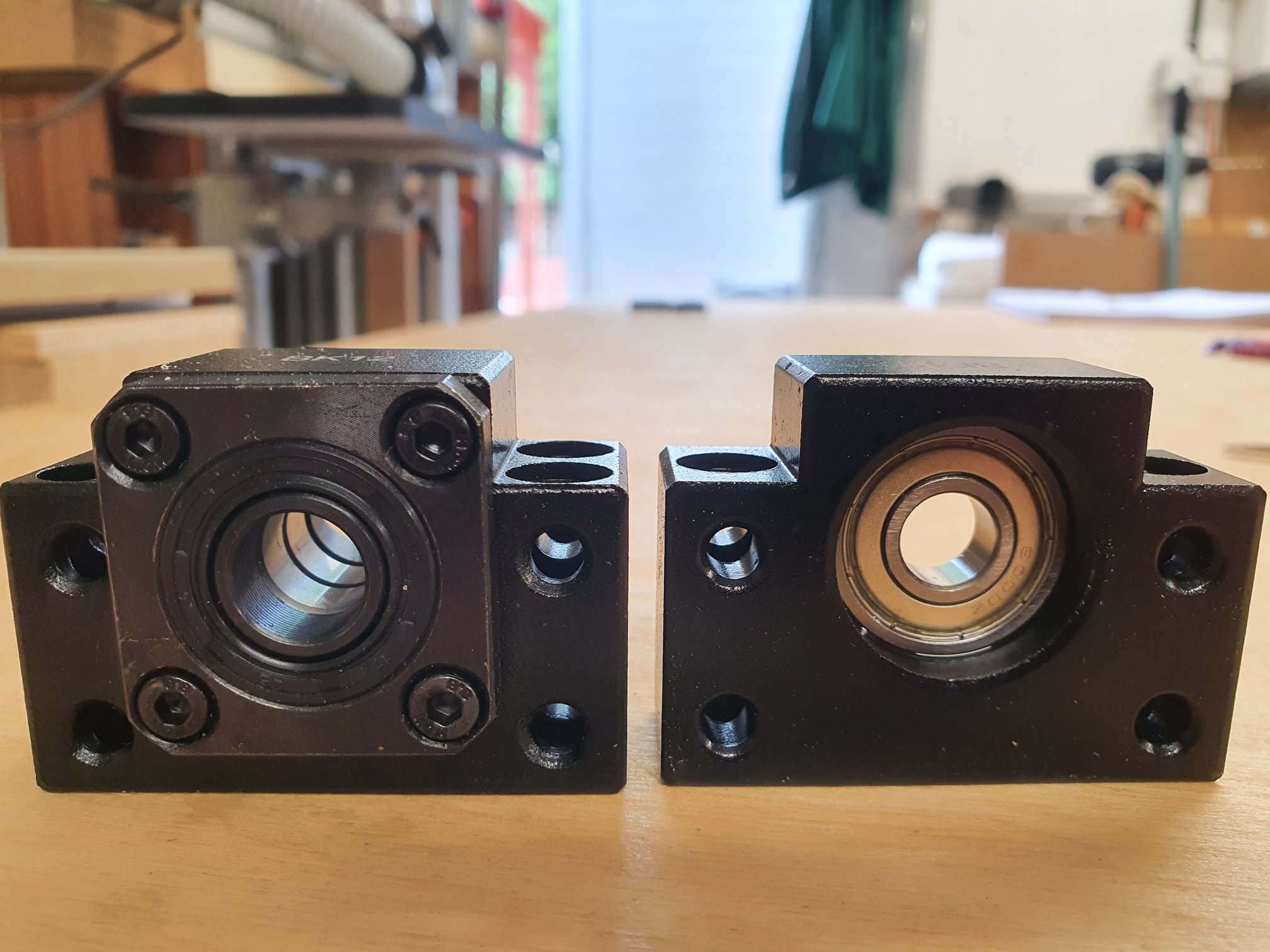

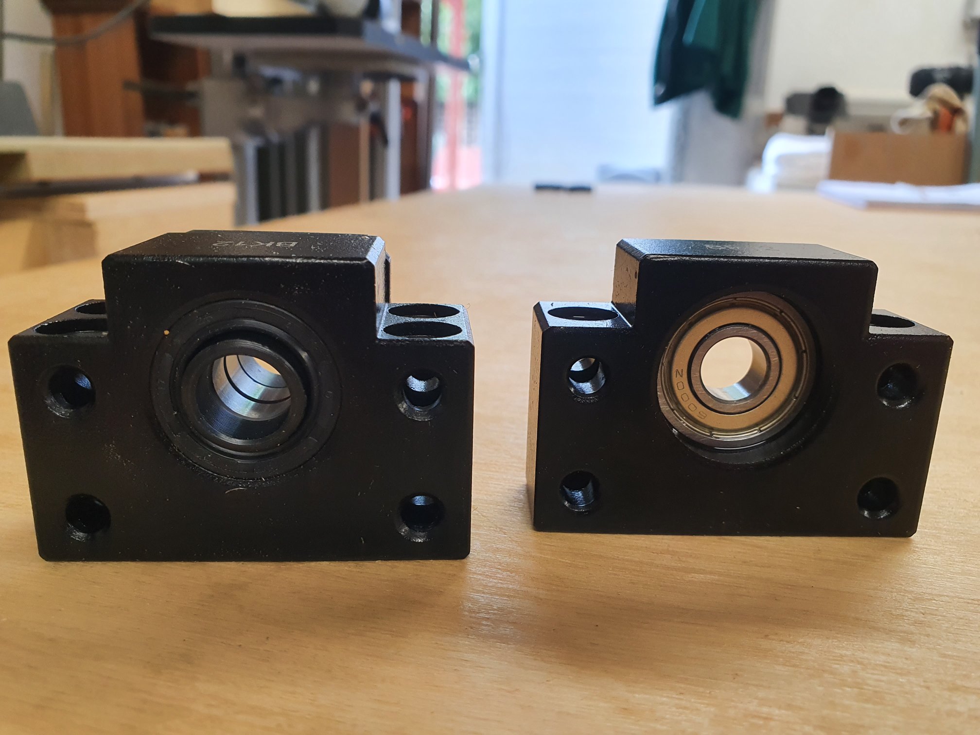

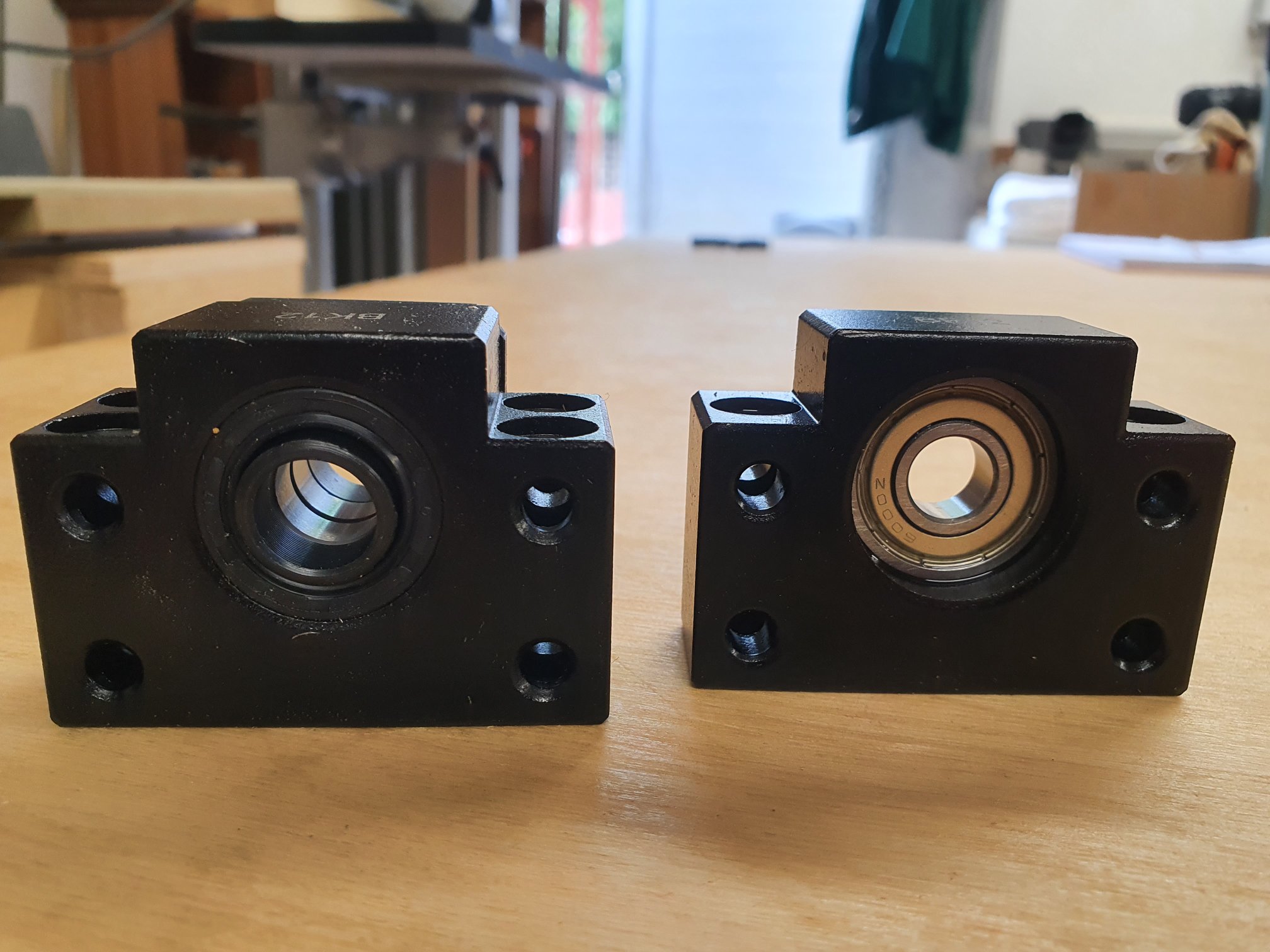

    Good evening Jazz, images as requested.
    Just about to take my daughter on her driving lesson
    Attachment 30182Attachment 30183
    Attachment 30184
    Sorry, I thought this post went out much earlier
    WoodKnot
    Carpe Diem
  5. #45
    Let's try again
    WoodKnot
    Carpe Diem
  6. #46
    And finally JAZZCNC, the base is sat on 2040 profile
    Thanks again
    WoodKnot
    Carpe Diem
