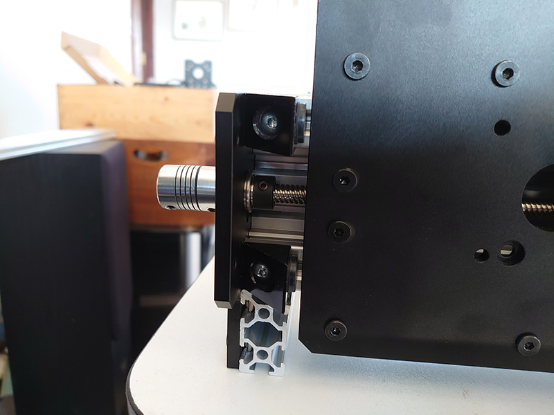

    Some of the new chips use soft-limits - works on voltage drop.
    Or you could hard stop it save wiring like mine :)
