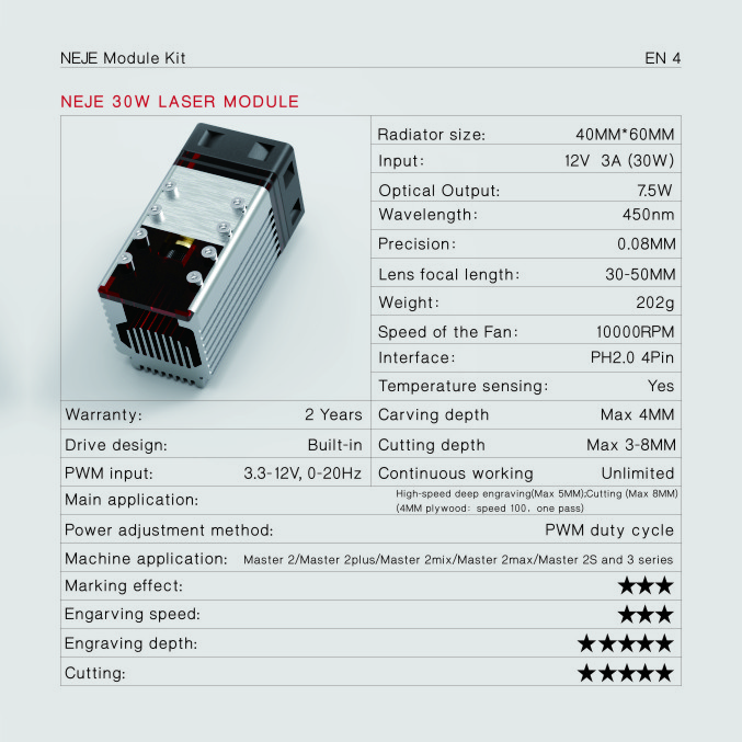

    Specs
    30W General Specification:
    Model:NEJE Module 30W
    Heatsink Material:Aircraft Aluminum + Brass Shell
    Luminous Color:Blue
    Section Size:40mm x 40mm
    Cooling Mode:Temperature sensor intelligent control + 10000 rpm 40mm cooling fan
    Dimension:60 * 40 * 40mm
    Adapter Plug:5.5 2.1 port
    Can Engrave:MDF/Balsa/Paper/Wood/Fabric/Plastic/Leather/Plywood/Foam Paper/Anodized Aluminum
    Can Not Engrave:Metal/Glass/Stone/Ceramics/PCB/Stainless Steel/Reflective Material/ Transparent Material
    Technical Parameters:
    Module Input:20-30W
    Optical power output:7.5W (7500mW)
    Wavelength:445-450nm
    Beam Shape:Dot (Focusable)
    Working Voltage:DC 12V
    TTL&PWM Modulation:YES, Compatible with Both TTL & PWM Modulation
    Input Voltage:DC12V 3A
    PWM/TTL Input:DC3.3V-12V
    Input Interface:PH2.0-4Pin (+,-, PWM/TTL, Temperature), 3Pin (+,-, PWM/TTL) , 2Pin+2Pin (+,-) + (PWM/TTL,-)
    NOTE:Temperature interface can be disconnected,NEJE provides text instructions for temperature acquisition on wiki.
    Drive Mode:External ACC
    Safe temperature range:<60 ℃
    Module weight:202g ( The lighter the weight, the smaller the move inertia, the better the performance )
    Life Time:10000-20,000 hours

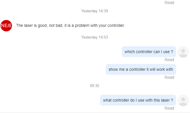

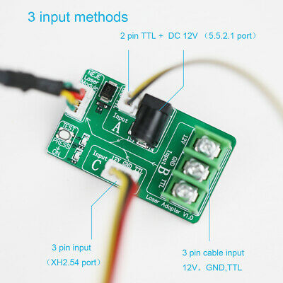

    So just to bring this up to date.
    It looks like these lasers only work with NEJE's own controllers.
    Which they don't state on the sales page on AliExpress or Amazon for that matter.
    They are simply an upgrade.
    Waste of $100.. be aware of this.

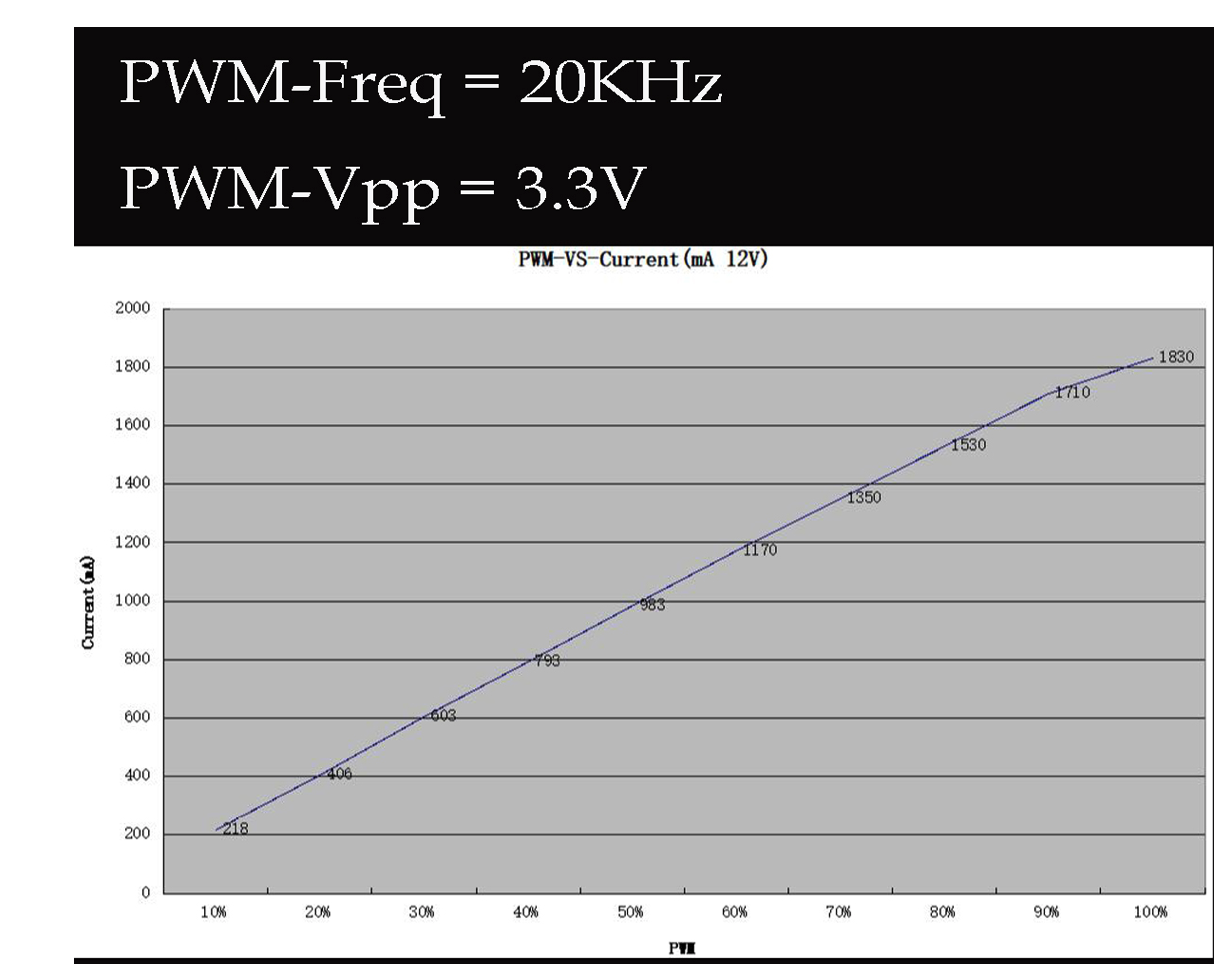

    I thought (only 5 minutes casual googling) that the laser was controlled either by a TTL or PWM signal? But I'm struggling to find the spec of the PWM signal (frequency, and active level, 0%/100% reference pulse widths)
    What are you driving the PWM from? (e.g. a PWM output from a BoB?) In which case there may be a general sensitivity to the PWM frequency (and you might need a mini interface to take PWM of one frequency, and re-present that at another). That's all do-able and a cheap ardi (that you already have) could be brought to bear to achieve that.
    Any documentation with the laser?

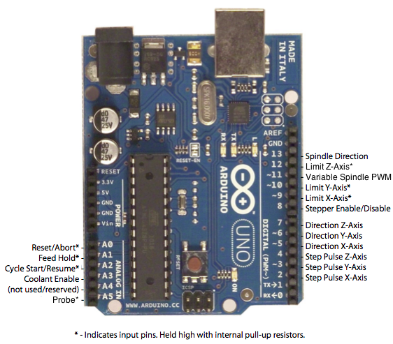

    I understand

    It's hard to assess performance and operation from a web-based forum. That you can test-fire the laser fire suggests a constant demand generates full optical power (and absence is off), and that suggests the laser diode itself is "working" (and for the supplier, that's probably the position they're aligned to). The only question I would have is the operation of the control circuit built into the laser assy - that allows the diode to be modulated with the TTL input. It **should** be a case that "on" is lase, "off" is don't-lase, and that is simply and exactly what an Arduino PWM output will produce. If the laser assy is questionable, then that can be assessed with passing a variety of signals into the laser and observing the resulting laser output. Similarly, you should be able (with equipment) to monitor the PWM output from the Arduino, that under GRBL it generates a pulse with variable mark-space ratio up to full-on (or near-as-dammit). Without testing these it's difficult to throw blame at either the laser or the arduino/GRBL.
