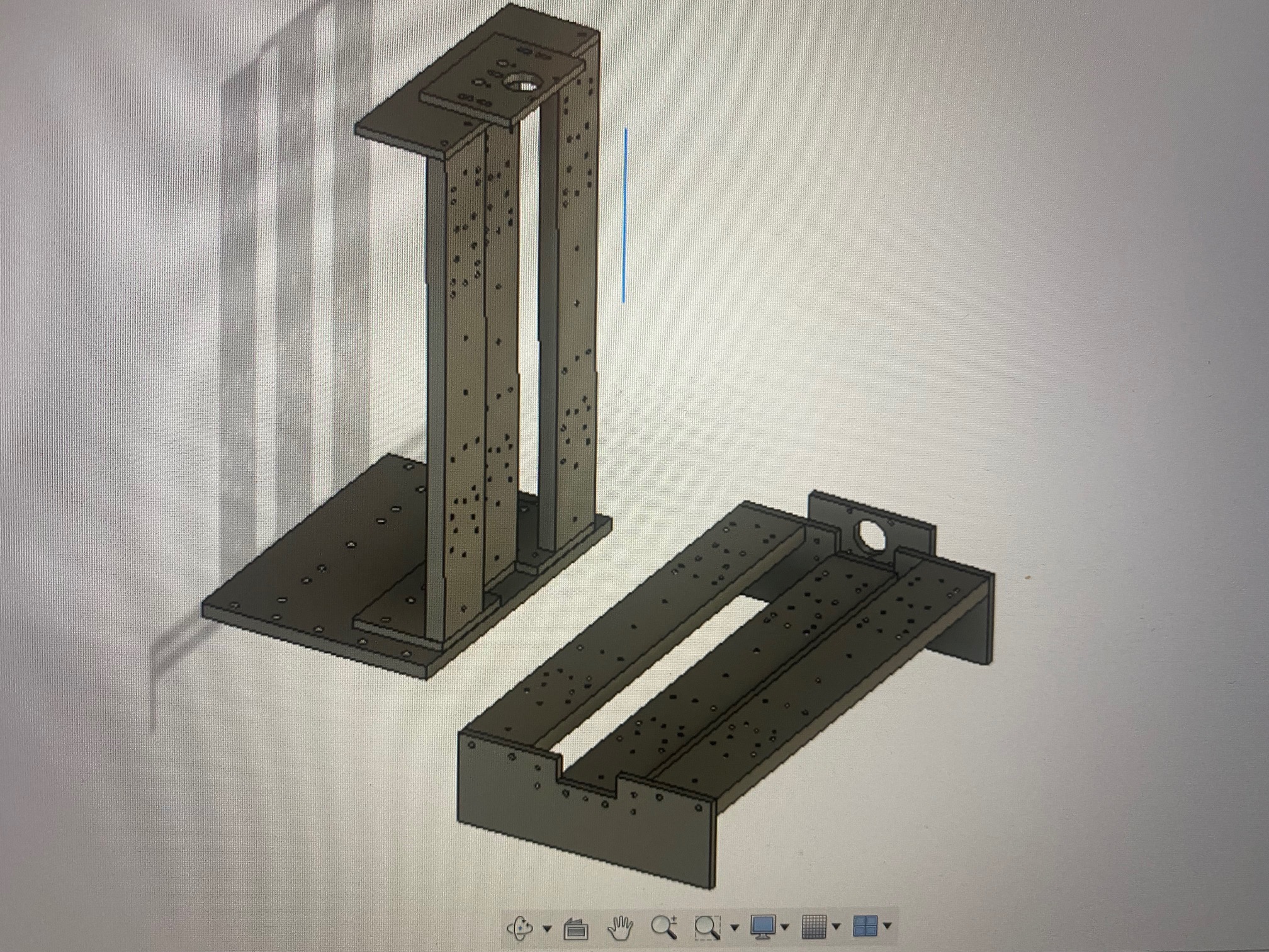

    I am looking for a bit of advice on a cnc mill I plan to build. I will be getting the XYand Z beds made from either aluminum 6082 or From steel. I then plan on embedding them into epoxy granite.
    Would there be any benefit with going with steel over aluminum the steel is a lot more expensive than aluminum. The X and Y travel will be 200X150 mm. Will be cutting aluminum and brass and sometimes steel. For steel I will only be cutting small parts.
    The mill will be used for making some parts for watches. I have attached one of the Axis beds that will be embedded into the epoxy resin. Any advice would be welcome.

    Why don't you type XY Table into Amazon and go for cast iron?
    Forget alu.
    99.9% of all tools in the world able to cut steel, are cast iron or steel.
    If You wanna make watch parts, it´s not hard but a bit expensive.
    Everything needs to be upsized 3x vs a wood router, and preferably 10x the mass.

    You *can* cut brass and alu parts with anything light, like a chinese barebones router.
    But they wont be round or cylindrical or repeatable to watchmaking standards or metrological standards.
    You will need to mount adjust and finish every part individually, to size, flatness, square, cylindricity, etc.

    Potentially, changing the screws (ground c0), mounts (ac bearings abec5+), linear guides (heavy preload precision class), and using industrial epoxy to fix a granite base under the bed You would get a good tool out of a basic router.
    Then change the router to
    1. high-speed spindle, water cooled, == 800w (you don´t need power),
    2. Nakanishi NSK.
    Another idea for you as you seem to require a small but very accurate machine - ever thought of starting with a "granite" surface plate? Whilst heavy, they often go quite cheap at machinery auctions.

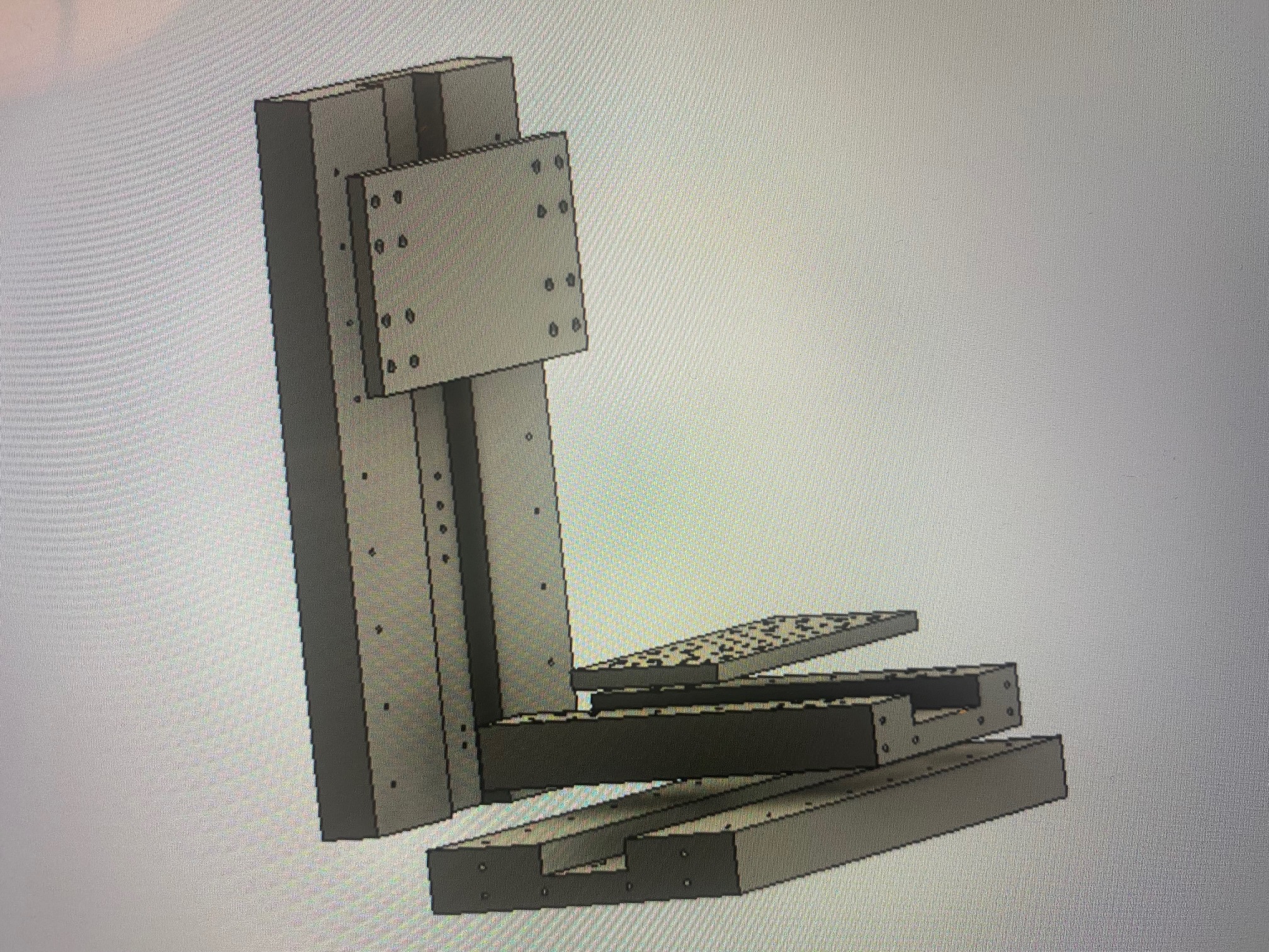

    I am leaning towards getting the rails and plates made the rails will be 20 X 500mm and embed them into the epoxy granite. I will post a pic of what I am planning so there is a better idea of what I’m thinking.
    I have a G penny 2.2kw metal cutting spindle ordered, for now that will do but I do plan to upgrade the spindle down the road.
    To get the rails and plates made it’s coming in at around 1500 euro so I sappose I am looking for a bit of input on my design before I spend the money on the steel.

    Pic of the structure that will be in the epoxy resins, threaded bar will also be added. The steel will be 1.7225 and with a surface roughness of .04um RA.

    Bl00dy hell. 0.04um Ra?? That is superfinished, almost mirror-like. What are you going to use to achieve that?

    Pointless and not required machining to this level to achieve what you want.?
    Pointless because having the plates machined before embedding into the epoxy will distort them due to thermal expansion and pressure, plus the extra machine time to achieve 0.04um Ra is wasted just for fastening rails onto.! You will be paying extra for this level of finish when it's not required.

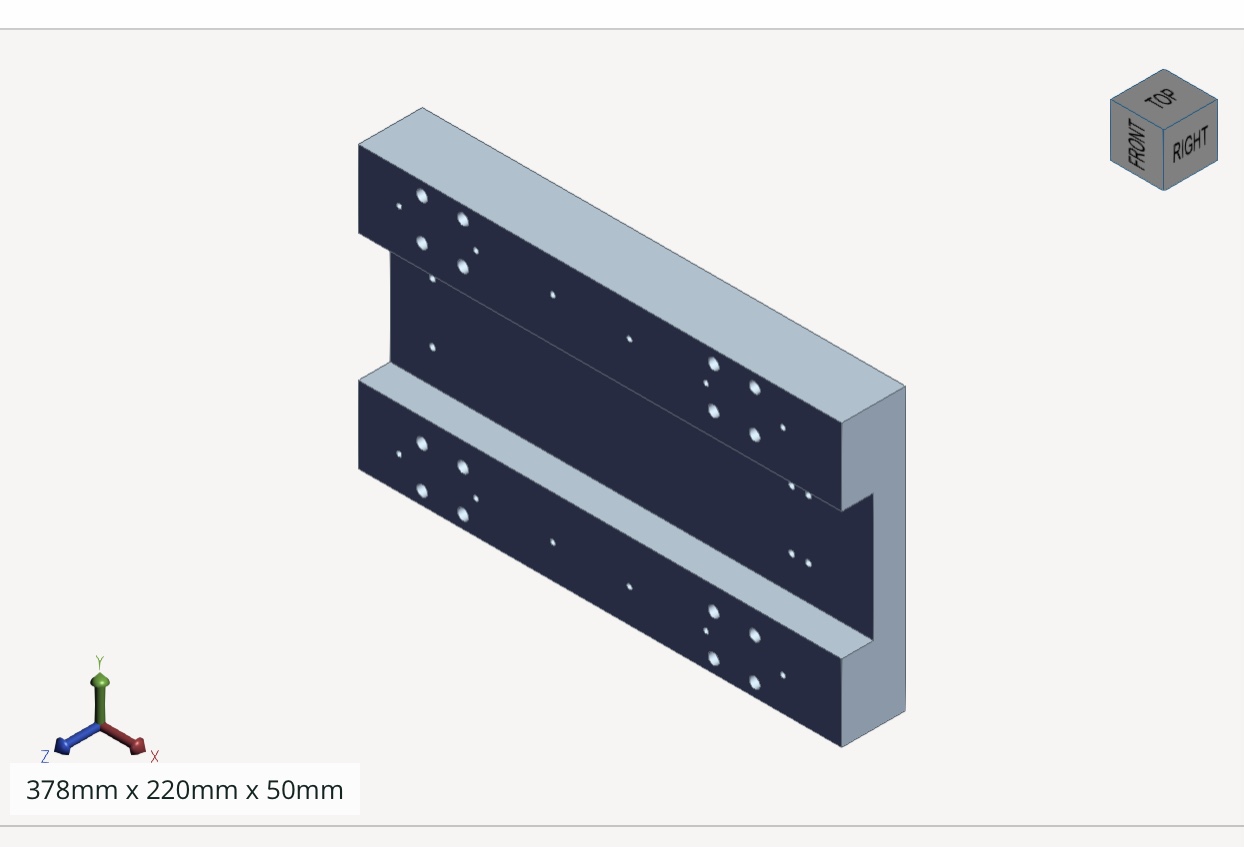

    Thanks for the input, I never thought about terminal expansion on the rails. The other option I was going to go was to either anchor or bolt the beds to an epoxy base I have attached an pic of the beds.
    You are probable right with the .04 um Finnish, I probably don5 need to go to that level.
