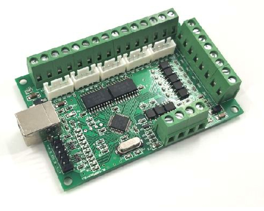

    My Mach3 5 axis controller board came today and although there was a lot of documentation supplied with it, there was not enough to setup the board properly.
    All the stepper motor settings are shown as 0 for all the steps pins and all the dir pins. I know that is not right, but how do I determine which are the correct settings? Can anyone help me with this?

    Board name is JDSW51B

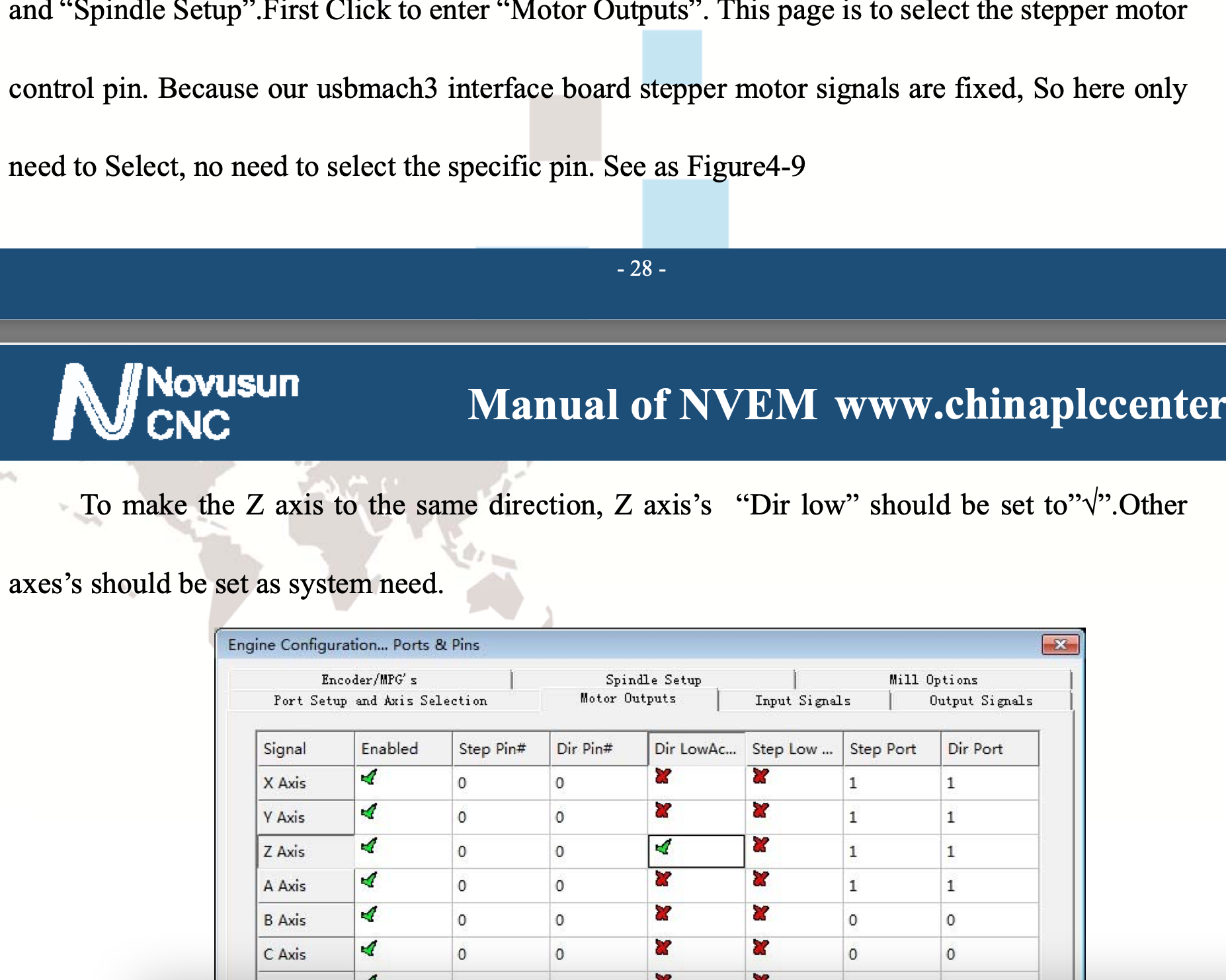

    I don't know your board, but a Chinese NVEM controller specifies in the manual that the X/Y/Z/A/B/C ports are hard-coded in the driver and you don't need to specify them in Mach3 (defaults to port/pin 1/0). Try it and see.

    First google hit I found on that board number confirms the above.
    https://www.duxe.ru/upload/iblock/40...c4d2421927.pdf

    Doddy, where are you getting that he's using an NVEM controller from.? That picture is of a standard BOB.!

    Thanks jazz, read page 5 of the link you provided, same as the link I provided from the Russian site to back off the analogy i first posted. My first post clearly started the info from the different card and was what I had to hand at the time.
    My recommendation remains, try it as is, the provided driver software hard codes the output mapping

    That's my point it's just a standard BOB, not a motion controller like the NVEM so the MOTOR OUTPUTS will need to be set up. Not having a pop just wondered how you thought it was a NVEM or motion controller.?
    A note for REGPYE: You will also need to apply 12-24V for the inputs and outputs to work, it basically power the optos. See Diagram on page 2, just above the inputs you have 12-24v connectors.

    Mach3 knows nothing about USB, so definitely the board is an motion controller.
    On the picture:
    http://www.mycncuk.com/attachment.ph...811440&thumb=1
    is clearly visible a micro controller (no matter which type but looks as some STM32Fxxxx).
    So, motion controller with BOB :)

    Hi ZASto, No not the pub but I am not myself today, poorly sick and dying from food poisoning, ate some dodgy fish I think..
    To be honest I didn't look that close to see it only had USB and no PP. I don't use BOB's these days and most I've seen like this have a USB port so just assumed it was standard BOB,!! , , , , You know that they say about assumptions being the mother of all FKUP's ...
