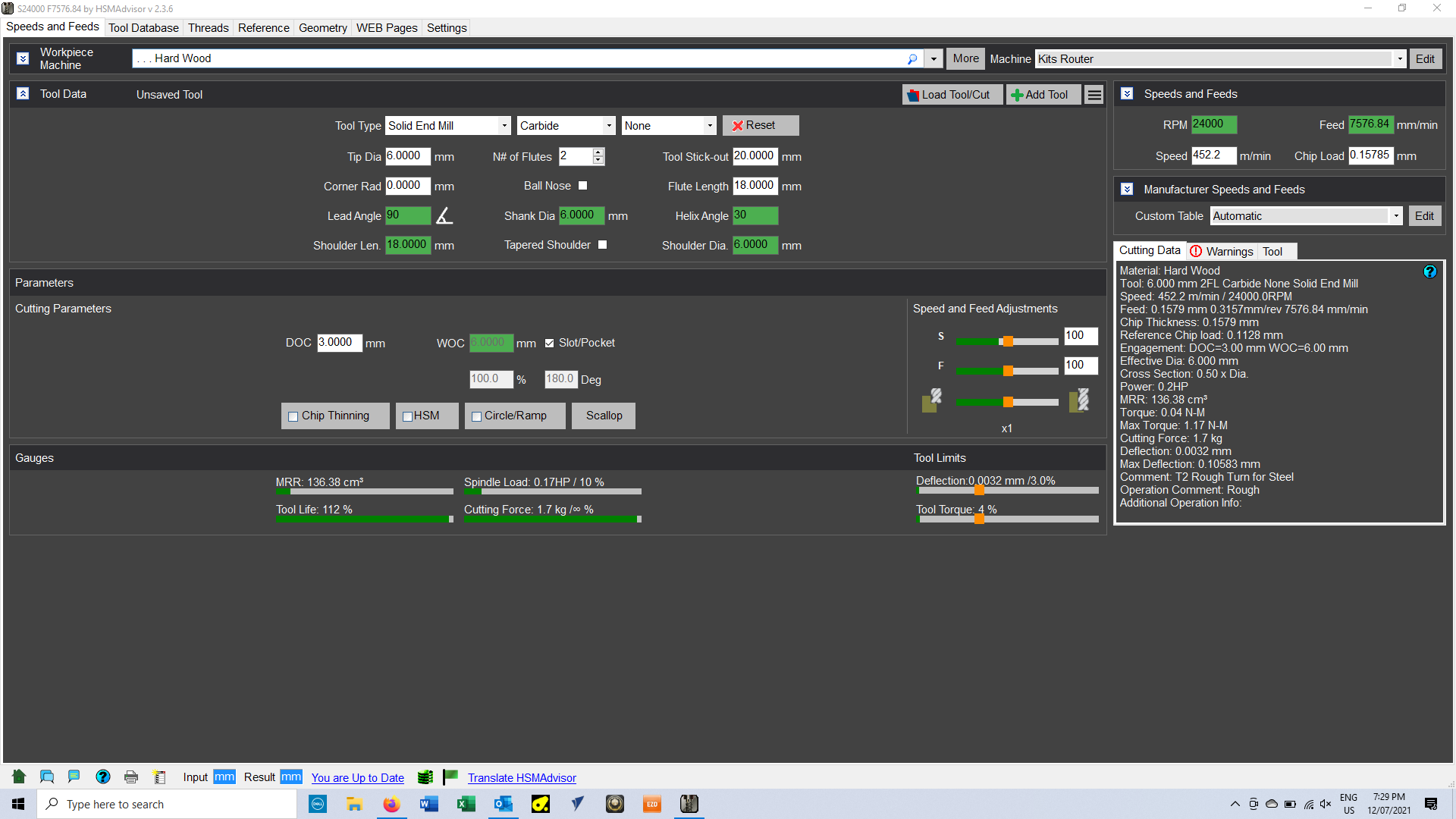

    how can i estimate the force that the spindle applying on the gantry during cutting?
    (lets say aluminium 6061 is cut with HSS tool with diameter of 10mm, feed 100mm\min and depth of cut 2mm)
    HSMadvisor calculates this for you. It's in the 'Cutting Data' tab.
    https://hsmadvisor.com/

    Strange that they quote it in kg (mass), rather than N (force). Not a big deal to x10 though !
