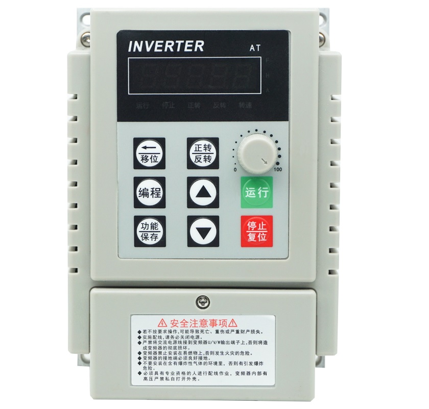

    I had a problem with my CNC where the VFD appeared to have died so I purchased a AT1 0.75Kw single phase to three phase VFD off Ebay.
    I have a problem, I think it is configured to operate correctly with my Perske VS 31.09.2 but when I try to run it I get an error where it starts to turn but then trips showing fault ERR 1 Short Circuit/Current overload/ Power Module Protection.
    Is there something I have set wrong or is there a fault with the spindle or VFD.

    Hi Guys.
    The spindle is 240V 2.9A 0.75Kw 300Hz 17140 RPM.
    The VFD is an AT1 - Single to three phase details below.
    Item specifics
    0.75kW Single To 3 Phase VFD Variable Frequency Drive Inverter
    Output voltage adjustable method: PWM control
    Brand: Unbranded
    Power supply phrase: Single phrase
    Control method: V/F open loop
    Power supply voltage: Low voltage
    DC power supply: Voltage type
    Rated current: 5A Filter: NO
    Rated voltage: AC 220V
    Model: AT1-0750X
    Suitable motor power: 0.75kW
    I hope the above helps, I can start the motor spinning really slow but as soon as I get above 19Hz it trips with Err 1 code.
    I'm only turning this up really slowly but always with the same result.
    I'm really grateful you guys are helping me with this.
