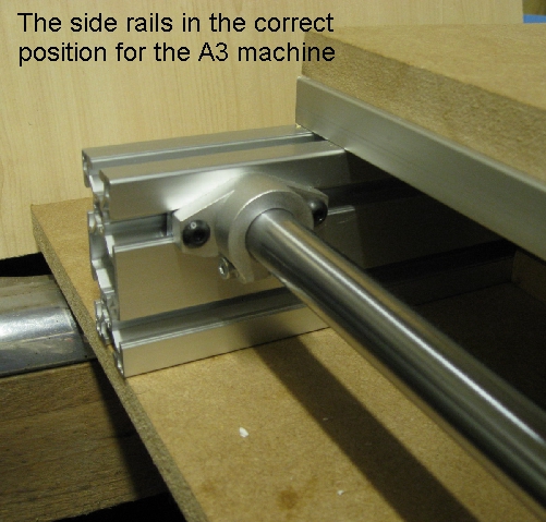

    Before the missing parts were sent, building the base was not without its challenges.
    Remember there are no instructions which to be fair is not a major
    problem, it really is fairly straight forward to construct, although a mechanical mind should help.
    However, the trouble was the Y axis base didn't seem to fit together properly and I just couldnt work it out. The Z, X axis top section went together relatively easily, but I based the building of the base on what I'd learnt with the top part and this turned out to be where I was going wrong.
    It became like an insolvable puzzle as I tried to put the side rail fixings into the same diagonal position as seen on the top part. in fact the more convinced I became thats how it should be attached, the more impossible it became to attach the cross member. It simply wouldn't fit and I couldn't see the wood for the trees.:confused:
    After much cursing and wondering if I should have bought a crate of beer instead
    I had a brainwave of looking on the internet at some pictures I'd seen on good old ebay when i was looking at buying the unit.
    I recalled that the listing for the CNC in question had a link to some photos of one already built.
    There was a series of photos in closeup of a tour around the machine. In one photo it clearly showed the base side rails fixed in the same diagonal postion as the upper part.
    What I didn't realise was this was a photo sequence of an A4 machine, I'd bought the A3 machine and unbeknown to me it had subtle differences!!:heehee:
    By trial and error I started to fit the rail fixings in the same slots as themselves and it was only then that I could succesfully fit the cross member to join the two parts together.
    Unfortunately I wasn't convinced I was doing it right afterall the photo sequence shows them to be diagonal.
    It was only by looking closely at a smaller photo of the A3 machine that I could see the rails were indeed fitted in the position which I was now using. I was right but boy did my head hurt trying to solve the krypton factor!
    Once I realised I was on the right road I was happy to tighten the screws up and complete the base unit.
    The photos also had another advantage in that one photo also showed the elusive missing specialised nuts.
    I now knew what was missing all I had to do was wait for them to arrive
    Neo
    part3 to follow.....

    The thread seems to have gone a little off topic but here's part 3 for the holiday season to keep you going...
    Part 3 Missing you already.
    The parts to join the two sections together arrived about a week later.
    unfortunately, those four missing specialised nuts were not the only parts that were not sent in the main box: The bracket to attach the spindle was also absent and so were two extra colletts for the Kress.
    just to add to the experience the mach3 software was also missing....killed in action maybe! ((Mach3, speed of sound? jet fighter?..ohhh please yourselves Frankie howerd))
    It took a while to dawn on me that all these parts were not included, remember there was no packing list. Fortunately the original invoice had the software and Kress colletts listed but they most definately wasn't in the box of packaging, I know I emptied it onto the lounge floor several times!
    After hoovering up the mess, I was back in my wife's good books!
    I kept my calm and duly emailed a list of the missing parts and they added them to the package containing the specialised nuts.
    I can't tell you if there's any more missing parts....'cos there's NO CHECK list! (you can add any expletives between the words NO and CHECK at your discretion!......I did!!
    So after a short while, all the parts arrived and we set about joining the two main parts together. It didn't take long and all of a sudden it started to look like a CNC machine.
    The most noticeable thing is how heavy it was becoming, which on the one hand is great as the weight provides rigidity essential for precision, the downside is it becomes awkward to move about.
    This is not a problem of the design, its the consequence of having a large machine: the bigger they are the heavier they become and this will affect DIY and commercial units.
    It really is surprising how much they weigh.:surprised:
    Subsequently, adding the bed to the machine increased its weight even more, it was becoming increasingly difficult to move, and I started worrying about my back! I began to wonder if I could leave the bed off and add other bits whilst I could still move it.
    In the end I did a number of dry runs, keeping the sequence in my mind, only to conclude that adding the bed now was the most sensible step as it didn't have to be turned on its side anymore.
    Neo
