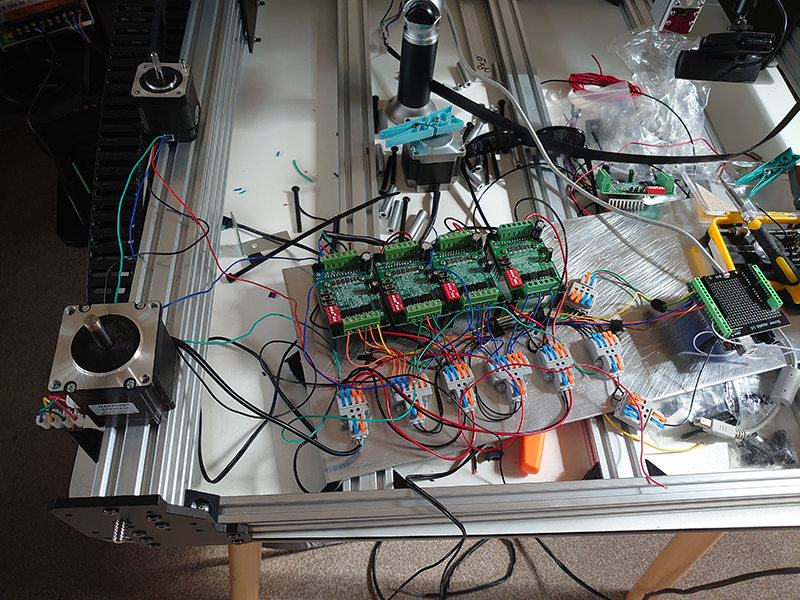

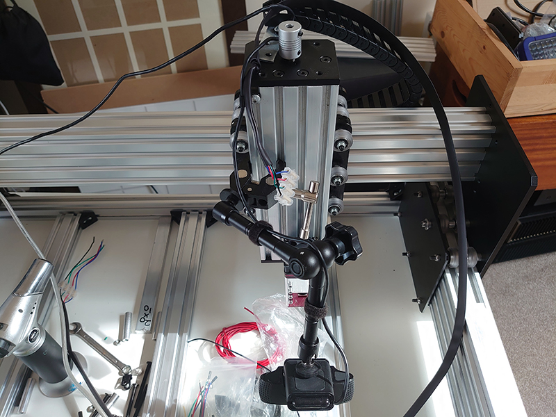

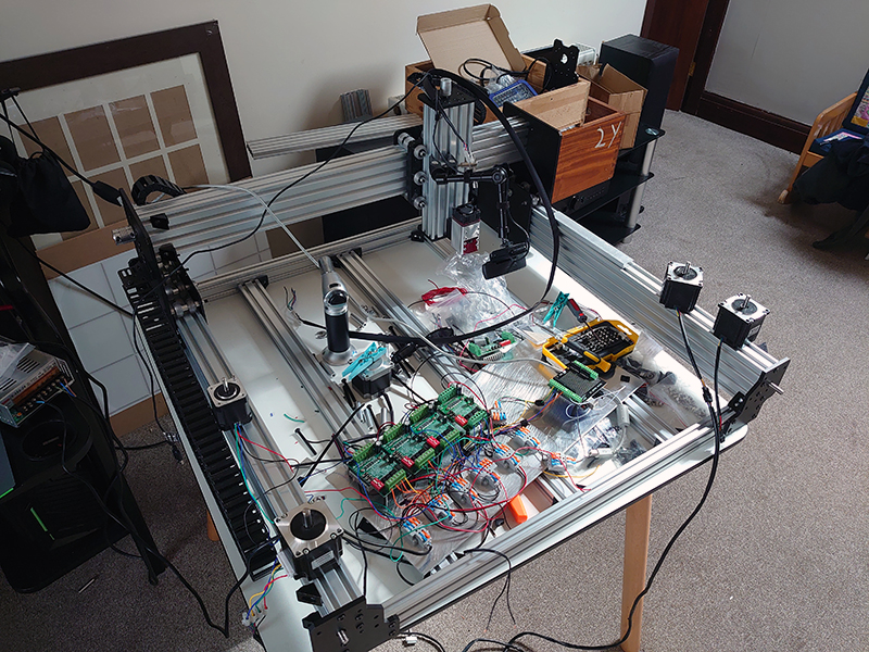

    This started 5 years ago !! I'm determined to finish it this year.. no matter what lol
    @JAZZCNC look away, the next picks may offend you lol :)
    As I achieve some minor victory during this war of attrition, I'll post details of - what it is, specs etc and my thoughts on it.
    its footprint is 750mm x 750mm
    working area 600mm x 590mm
    Build cost .. not sure about £1000 by the time I've finished
    It will be capable of Laser and wood milling/routing
    Like I said I'll break it down in to achievements by post and add the details.. but so far not any major problems.

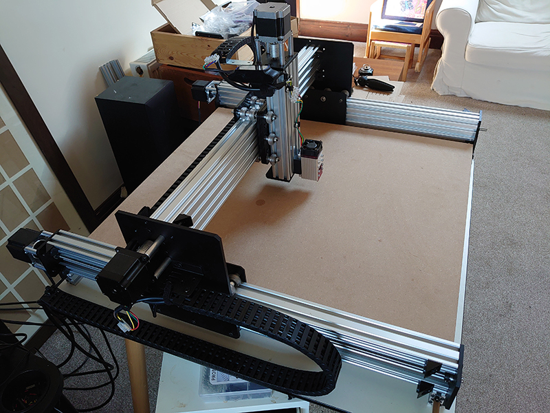

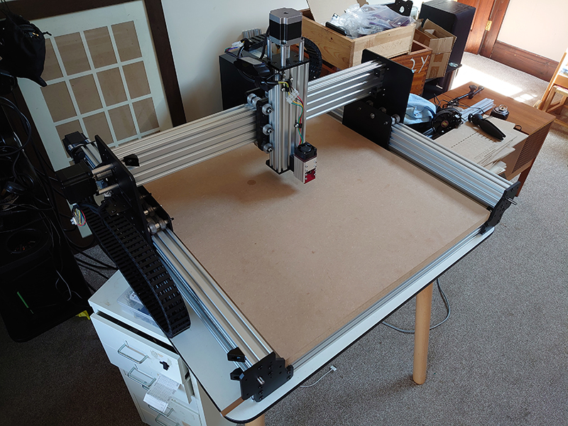

    some updated pics

  11. #9
    Doddy's Avatar
    Looking good. Just a passing, friendly thought - if you've not got/planned it already - it's generally recommended for a little air-assist, particularly with composite materials, so when you ablate the binder/glue it doesn't deposit a sooty film on the lens of the laser. Nothing urgent, but think of it as a potential near-term upgrade.
  12. The Following User Says Thank You to Doddy For This Useful Post:
  13. #10
    Its on the list mate :) I'll be encasing the cnc and making a nice heavy stand for it. I have my eye on a compressor from a you-tube video. Some triple 12v fans off Aliexpress and a home made air filter.
    Fireproofing/cooling for the electrics.
    Some heat and smoke sensors
    the list goes on lol.
    Ralph Waldo Emerson
