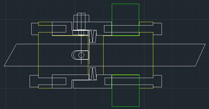

    I prefer to stretch my leadscrews and use two nuts sprung apart with Belleville washers.
    Arranged correctly that gives zero backlash in one direction and no backlash, until the springs are overcome, in t'other.

    Yes, that's a pragmatic solution. As long as the allowable preload is less than the max machining force, it's a neat and simple approach for ballscrew backlash.
