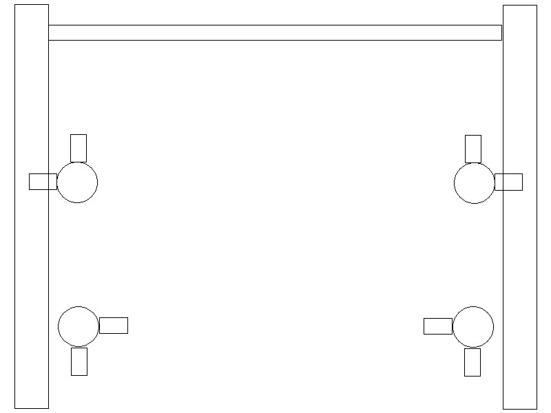

  5. #25
    In the drawing shown 2 bars each side and and 8 bearings each side the bar at top pulls the 2 sides together and will give lateral support.
    Not shown attachement of bearings but this arrangement will allow spacers to be used between rods.
    Peter

  6. #26
    Still not sure where the problem is? The bearing blocks can take loads in all directions, (slightly reduced where the rail is supported maybe, but thats why I put them vertical rather than on their side)
    I see what you mean In your diagram but not sure how that relates to the one I've drawn, dose that use skate bearings and unsupported rail?
    I could put another rail underneath like in your sketch but this will add to the cost, And in that case Id rather use linear rails as they would be the same cost as 2 supported rails but are 4 way loading and much much stronger.
    If Ive made a mistake I want to known, but at the moment I dont understand......
    I have thought about the wall mount option but not sure how easy it would be to use.... Im sure I remember a design that could be stored on a wall tho.
  7. #27
    Its just that I dont think that the sitting of the moving part on 2 rails just like a train then there would appear to be very little stopping it rising up unless you intend to use expensive ball slides which grips on their hollowed sides.
    I thought the skate bearing system is a cheaper option plus use of unsuported rails although I am unsure myself how to fix them to supports without drilling right through them.
    Peter
