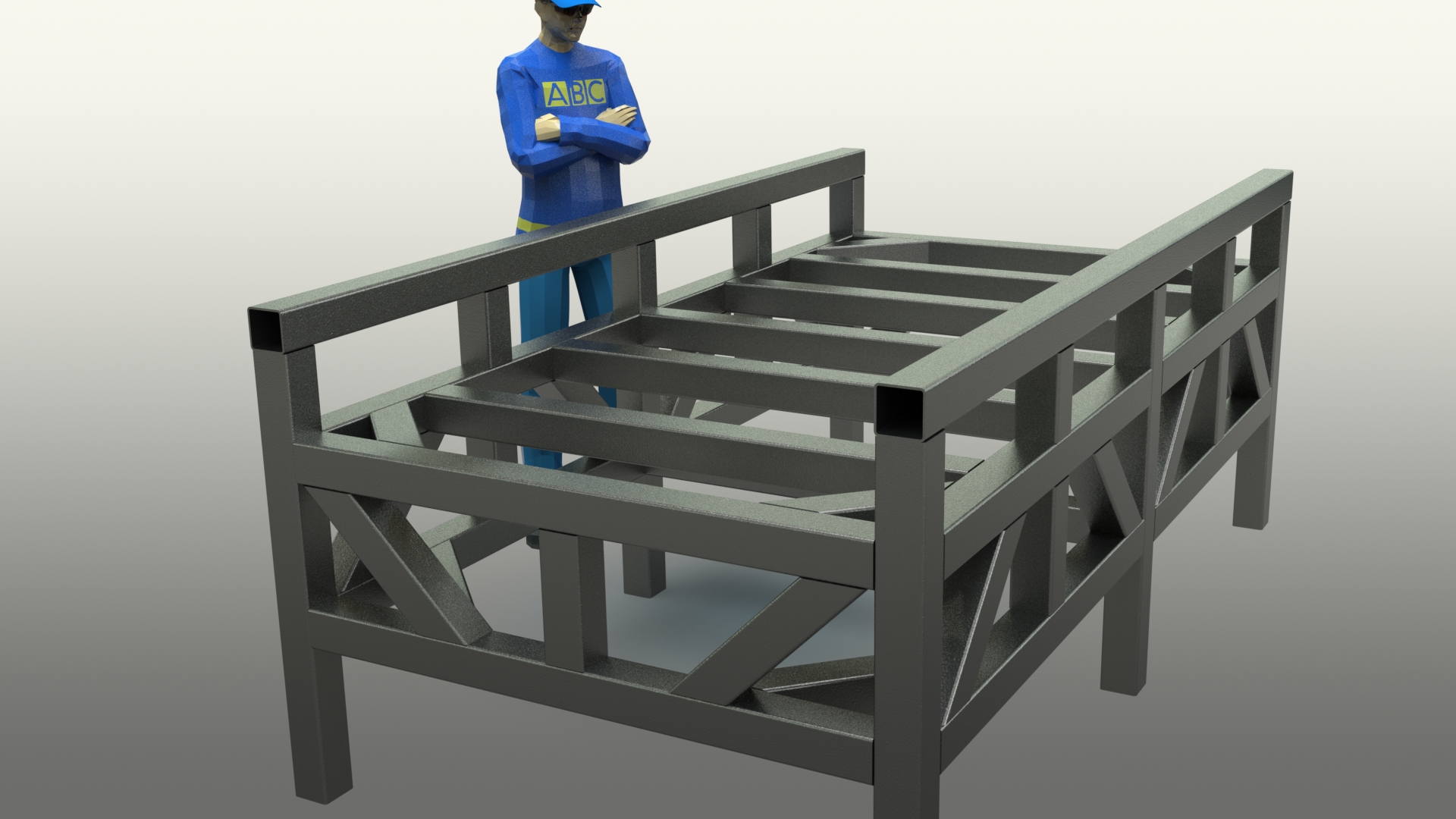

    i have a couple of questions because im actually just going to get it machined for peace of mind.
    1. would it be wise to also have one side of the frame machined flat so when getting the first rail on i can use a dial indicator against the machined side to help align the rail and then i can just use the gantry to slide the second on in place or is this not necessary?
    2. once i get the frame back and levelled how likely would it pull the rails out of alignment when bolting to the floor?

    #1 Not quite sure what your meaning here.? You will have a register machined into the surface for the rails to sit against so won't need to do that.!
    #2 Depends on how well built and braced the machine is, build it right and it will level/setup fine. You shouldn't need to bolt it to the floor as it will be heavy enough it won't walk around any time soon.
    #3 Impossible to answer as it will depend on distance and vehicle size etc. You might find it cheaper and easier to ask a machine mover rather than hiring a vehicle, some machine movers will give you a cheaper price if they can do it to suit them when passing on other jobs or return loads. If you get a decent mover I'd expect between £300 -£500 depending on the distance.
    Might be worth asking the engineering people as they will be dealing with machine and equipment movers on regular basis.

    Thanks Dean glad the first 2 is not needed. i think this frame look good enough although would like to know if 5mm is enough for the rails or should i go 6/8/10?

    5mm will be good enough for the tubes but not the rail surfaces, weld some 10mm flat bar to the top tubes for the machining.
