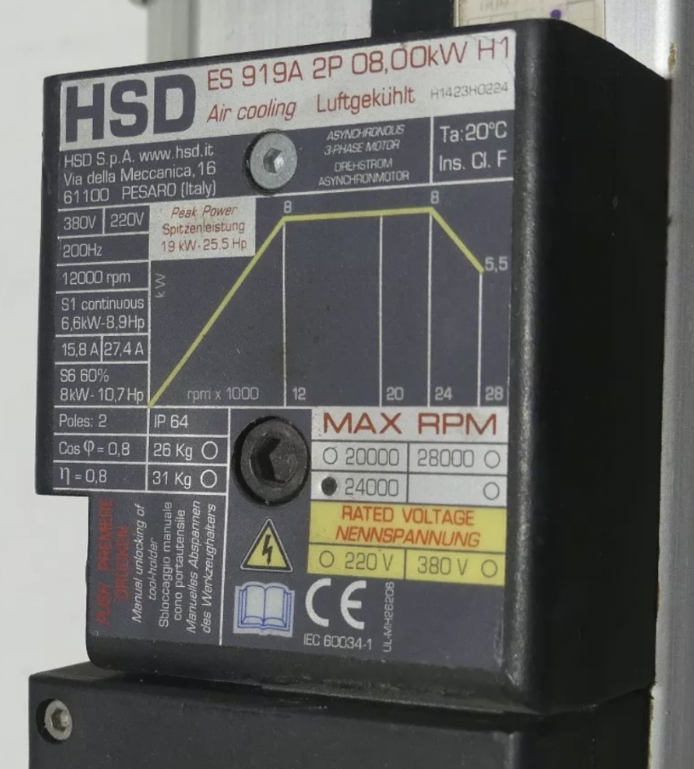

Hi everyone I'm looking for a bit of advice on spindle kw ratings and the impact of using a spindle with a lower rating. I currently have a hsd es919 on my 1980's thermwood and I'm looking for a spare too help me sleep at night. I've found one but the details are slightly different and I was hoping someone might be able to explain whether this would be a problem. The long dusty image is my current spindle
Thanks for looking
