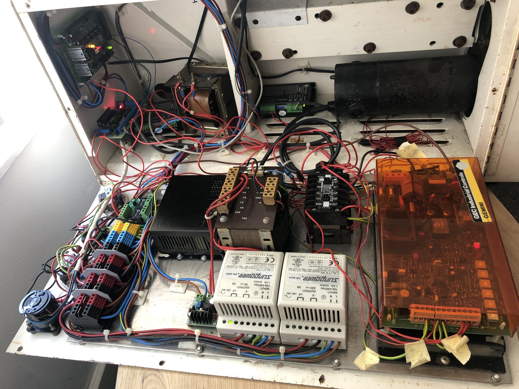

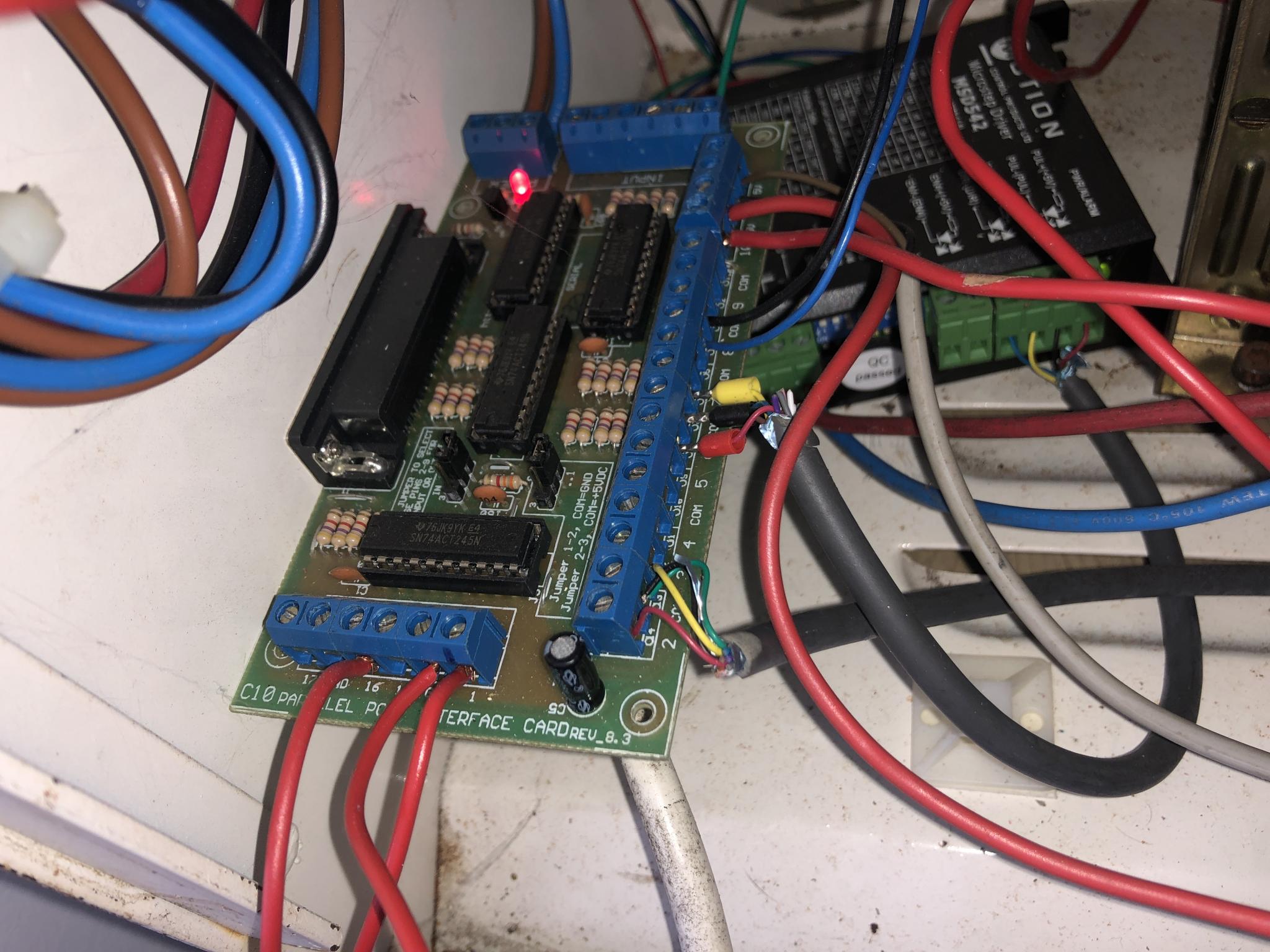

    Hi all, I purchased a Boxford 125 TCL (Mach3 conversion) a little while back with the intention of also buying a Milling machine which has also been converted to Mach3 so I could have a little home machining setup. When I got the 125 TCL home I plugged it all in and ensured everything was working as it should (X/Z axis’ & spindle), and all was fine (I also have a YouTube video demonstrating it working from the seller), so I left it dormant for a little while until I found the free time to delve deeper
    So i recently decided it’s time to start cutting some material and I’m a CNC machinist by trade so the programming side is no issue. So I fired the lathe up and homes the X & Z axis, however when I tried to command the spindle to rotate with a simple “M03 S1000” command, nothing happened. I’m not sure if I was in the correct Mach3 profile at the time, but wether I was or not is irrelevant now as I’ve tampered with the settings so need to go back to basics. I’ve read all sorts for forums and scoured through a multitude of YouTube videos trying different values in ports and pins but so far I’ve had no success
    To be clear, I have no experience with the internal workings of these machines although I am somewhat familiar with basic electronics, and I am just getting to grips with Mach3. Along my research and peering inside the machine I kind of figured out the basics going off the control board and I understand how the pins correlate to the inputs within Ports and Pins, although there are 25 pins on the data cable and only 16 inputs on the board. Besides that my findings for the control board are as follows:
    1. (I think this feeds to the spindle relay but not 100%)
    2. X-axis +
    3. X-axis -
    4. (Empty)
    5. (Empty)
    6. Z-axis +
    7. Z-axis -
    8. (Small cable feeding into another board, which is labelled “step”)
    9. (Empty)
    10. Kill switch
    11. X-axis limit switch
    12. (Small cable feeding into another board, which is labelled “out”)
    13. (Empty)
    14. (Empty)
    15. (Empty)
    16. (I think this feeds to the spindle relay but not 100%)

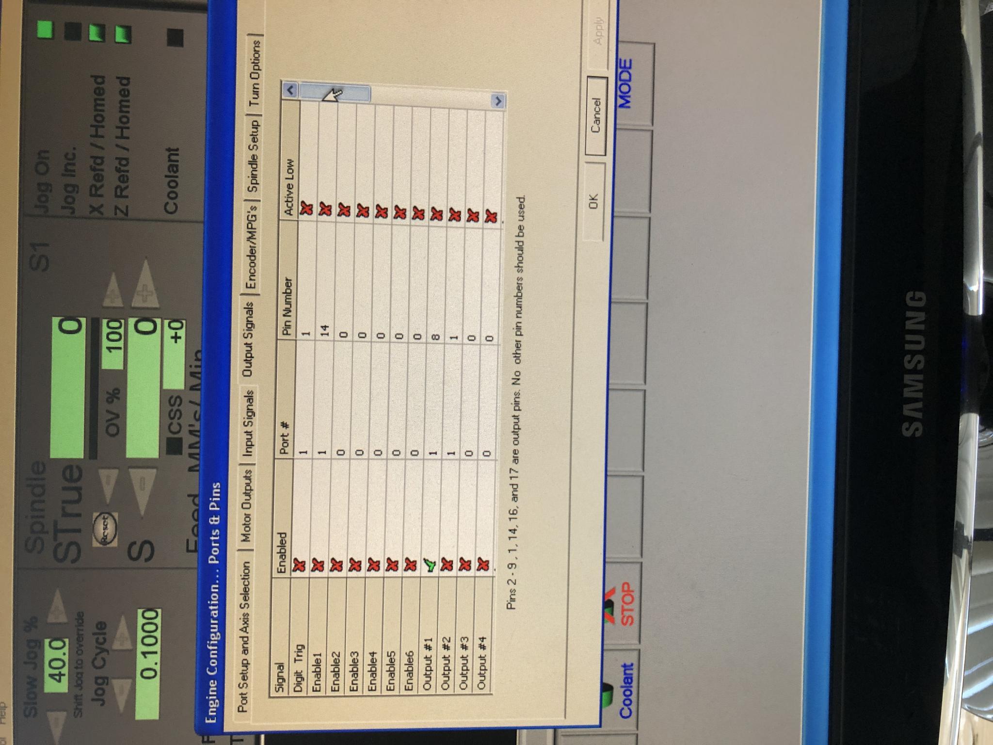

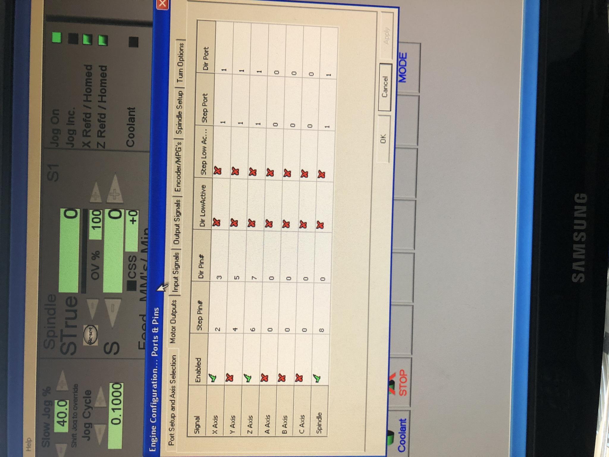

    So, I am happy that the X and Z axis’ are working correctly along with the X axis + limit switch and the kill switch, however I am stumped on the spindle. I assume that ports 1 and 16 are being used to drive the motor as they feed to a large relay which goes to the motor (with a couple of pieces of hardware in between) and port 8 is being used to tell the relay to kick in, but as I mentioned I’m simply a noob and it’s 0 understanding of these machines
    I have attached a handful of pictures, some of the machine and some of the Ports and Pins pages so see if somebody can guide me into the right direction
    Many thanks, Repro!

    Hi Reprobus . Thanks for detailed post .
    Certainly a lot different to mine . See http://www.mycncuk.com/threads/13959...TCL125+boxford Skim through and you will find pic of the guts of mine.
    Doyou know its history ?
    Certainly looks to be very much adapted from original Although original motor , choke and power supply transformer seem to be there . with a few added items of "bespoke" origin.
    My motor drive was a Lenze type and looks at first glance to have been replaced by the gemini contraption on the right . More details of that would be useful.
    Your BoB is a very old style compared to the sort we seem to see more often these days https://www.ebay.co.uk/itm/393334570...cAAOSw-7ZgpVSd
    There may be some info on the underside regarding the functions of the terminals on the near end of your board . but depending on where they are connected this may give us some clues .
    Just beware . I cant see any info to specify whether the Gemini controller is an "isolated " drive . If not there may be some high voltages waiting to bite you.

    Leaving isolated drive for now ( I suspect yours is isolated)
    You may be on the button WRT the white box which appears to be a 24v power supply.
    I am thinking that this would be needed for your spindle to be controlled by Mach 3 and your Bob.
    So test the DC output and report back. If output seems OK then follow it through to the Bob.

    So I’ve replaced the 24v supply, the board has power and the relays are kicking in when I tell the spindle to turn (Relay 1 with M03 and Relay 2 with M04). I count this as a success, however the spindle still isn’t turning…

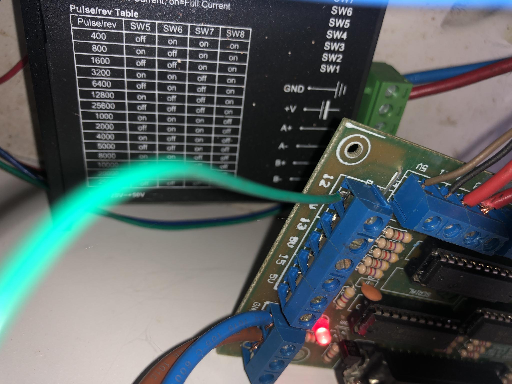

    The only pins which I couldn’t work out on the BoB are pins 8 and 12. As mentioned in a previous post, pin 8 goes to another board where the terminal is called “Step”. Could this be what I’m missing for Mach3 to monitor/control the spindle RPM? If so, where within “Ports and Pins” do I put this value?
    Thanks, Repro
    So it sounds like your forward and reverse relays are now supplied .
    Next thing to check is your spindle DC driver which is board with the orange perspex cover ( GEC gemini) . Do you have any info on it ? I cant raise any online.
    Would also be useful if we could identify the functions of two other boards The small one adjacent to the 5V psu (I am wondering if it could be a PWM generator) and the one at the far left corner by the yellow terminal block which I think will be a simple relay board.
    Somehow these in combination have to supply your DC driver board .

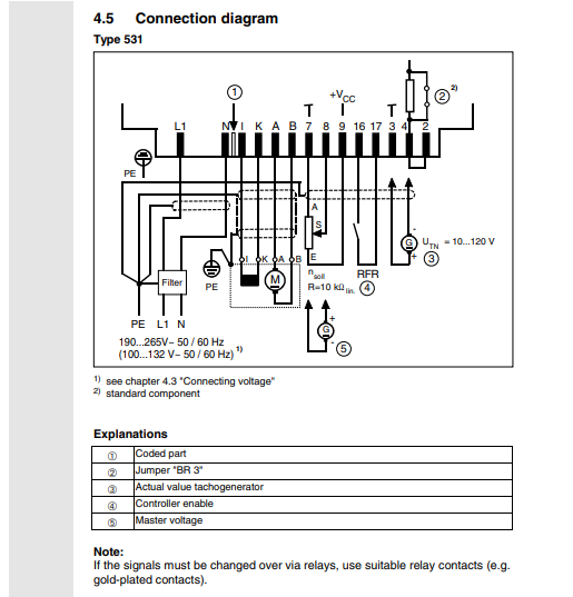

    This is the wiring of the original Lenze board used on some TCLs
Name:	Lenze  connections.PNG

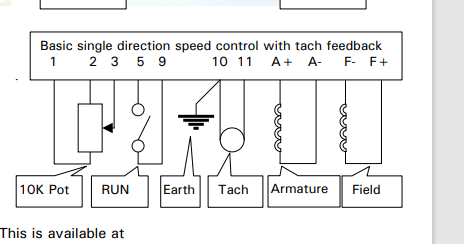

    And I am using a Sprint DC driver with connections as shown here
Name:	Sprint drive.PNG
    You should see common elements here and I am sure your GEC board will have the same functions.
    A run switch, and a 0-10v dc potentiometer .
    On Sprint they are 5-9 , and 1,2,3 respectively
    On Lenze they are 16-17 and 7,8,9
    If you can determine which they are on GEC you should be able to test the motor function separately by connecting a simple switch and a pot .
    With these you should be able run the spindle independently of computer connections and prove its functon. Just make sure you let the spindle stop before selecting reverse .
    If successful you can even run the spindle in this way while you sort out the outputs from the computer in Mach.

    Thanks for your reply, I read it back a good few times on Sunday to try to break it down and understand how the GEC board works, but no unfortunately I have no info on this at present. Indeed my board does appear to have similar connections to your Sprint board although the layout is different.
    I’m up for trying the “switch & pot” although I have no idea what a pot is, haha. I won’t be able to try this until next week however as my schedule for this week is pretty crammed
    In regards to the two other boards you asked about, the small one is a relay board. It feeds relays 1 and 2 for the motor direction. If the other board is a PWM generator that might explain what my next step is within Mach3 > Ports & Pins > Spindle Setup
