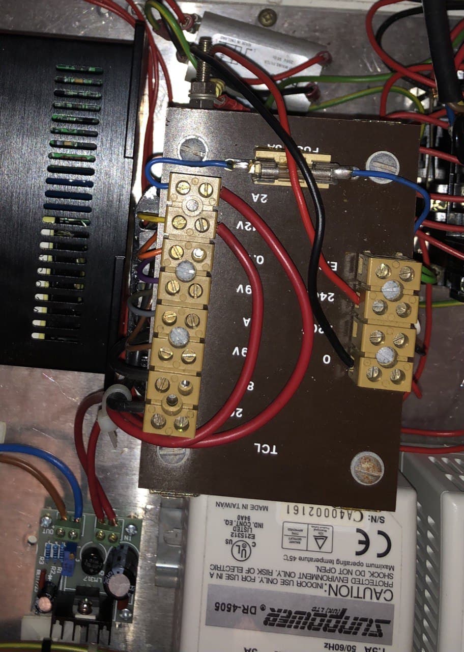

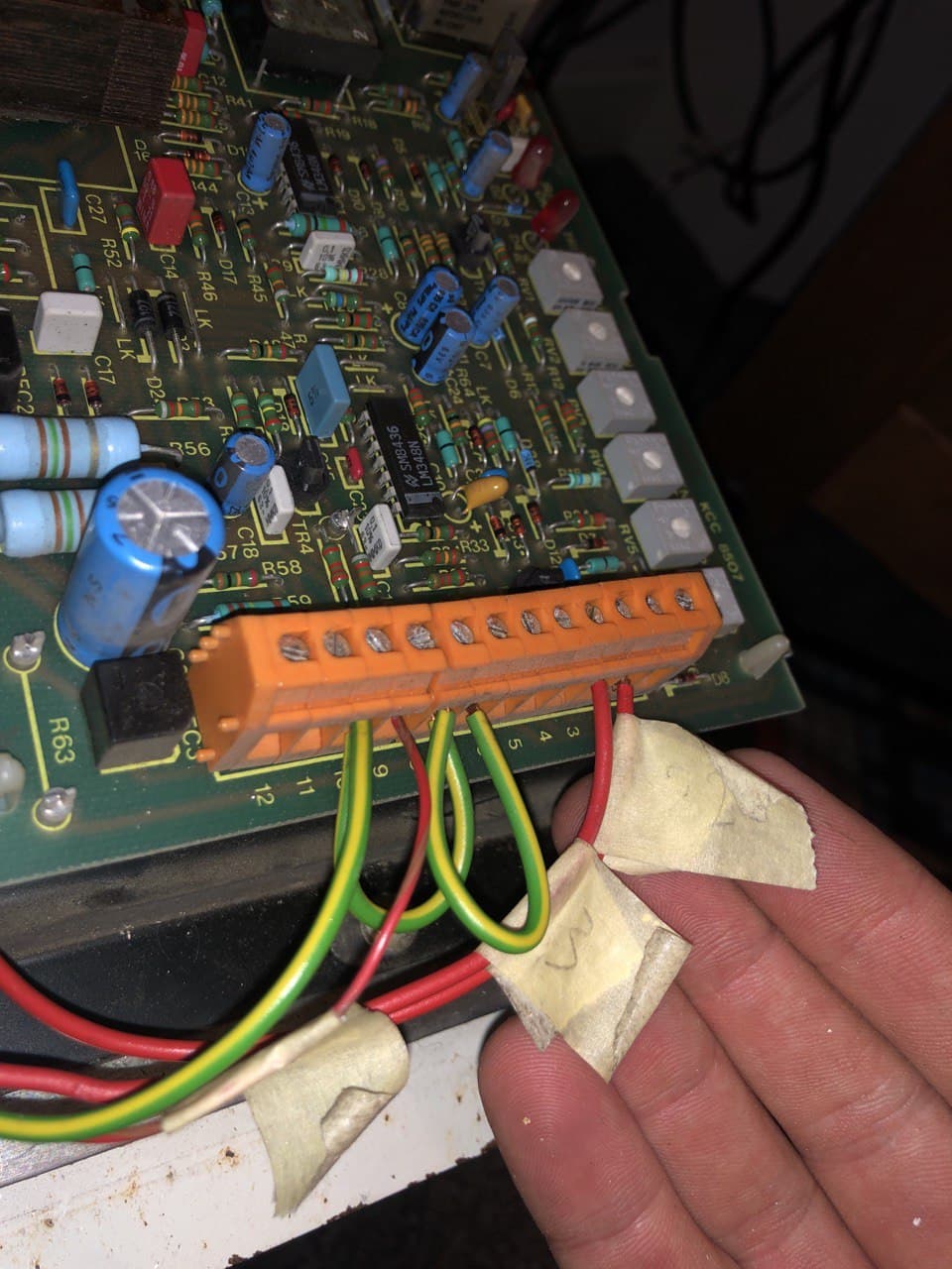

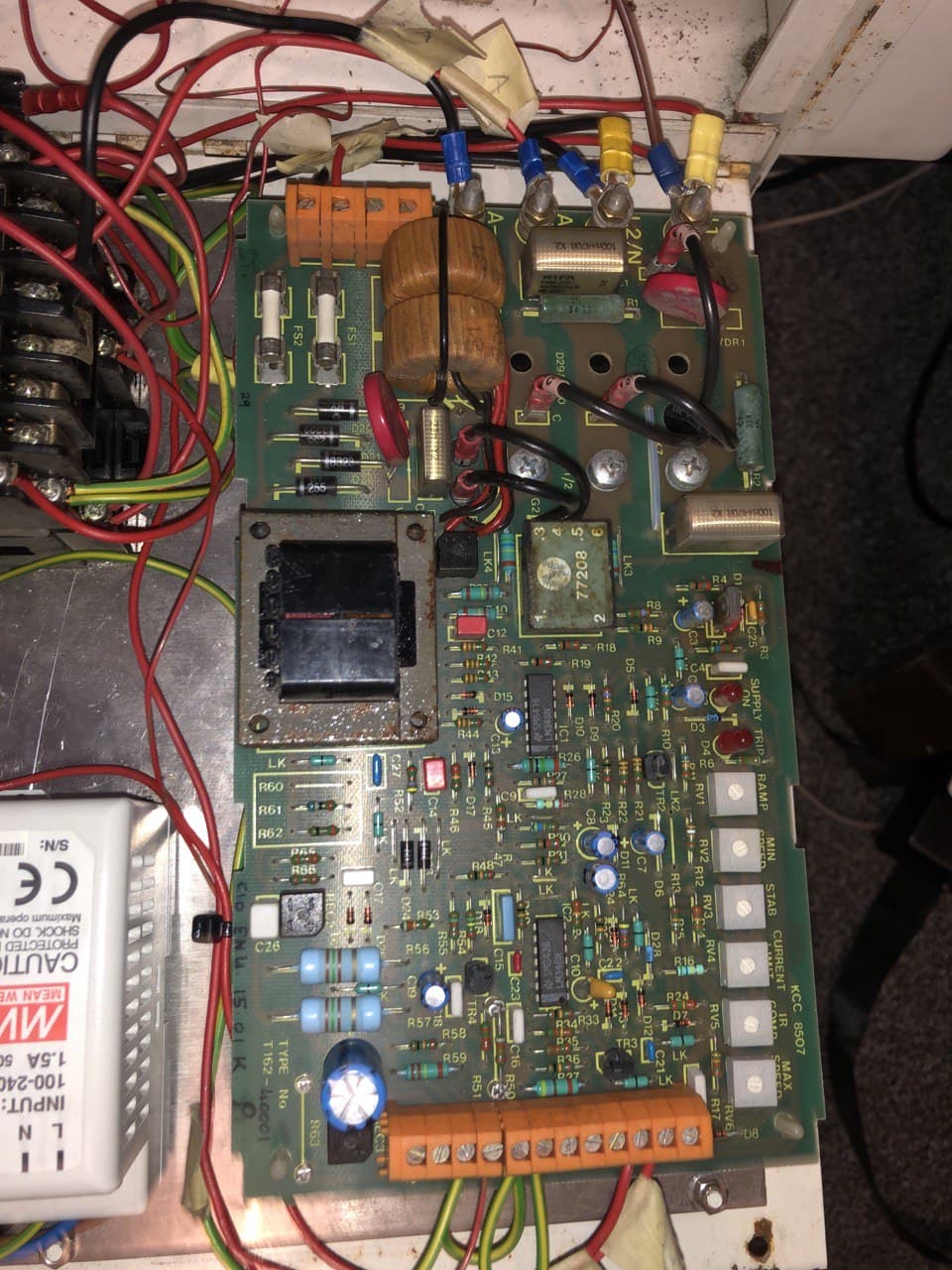

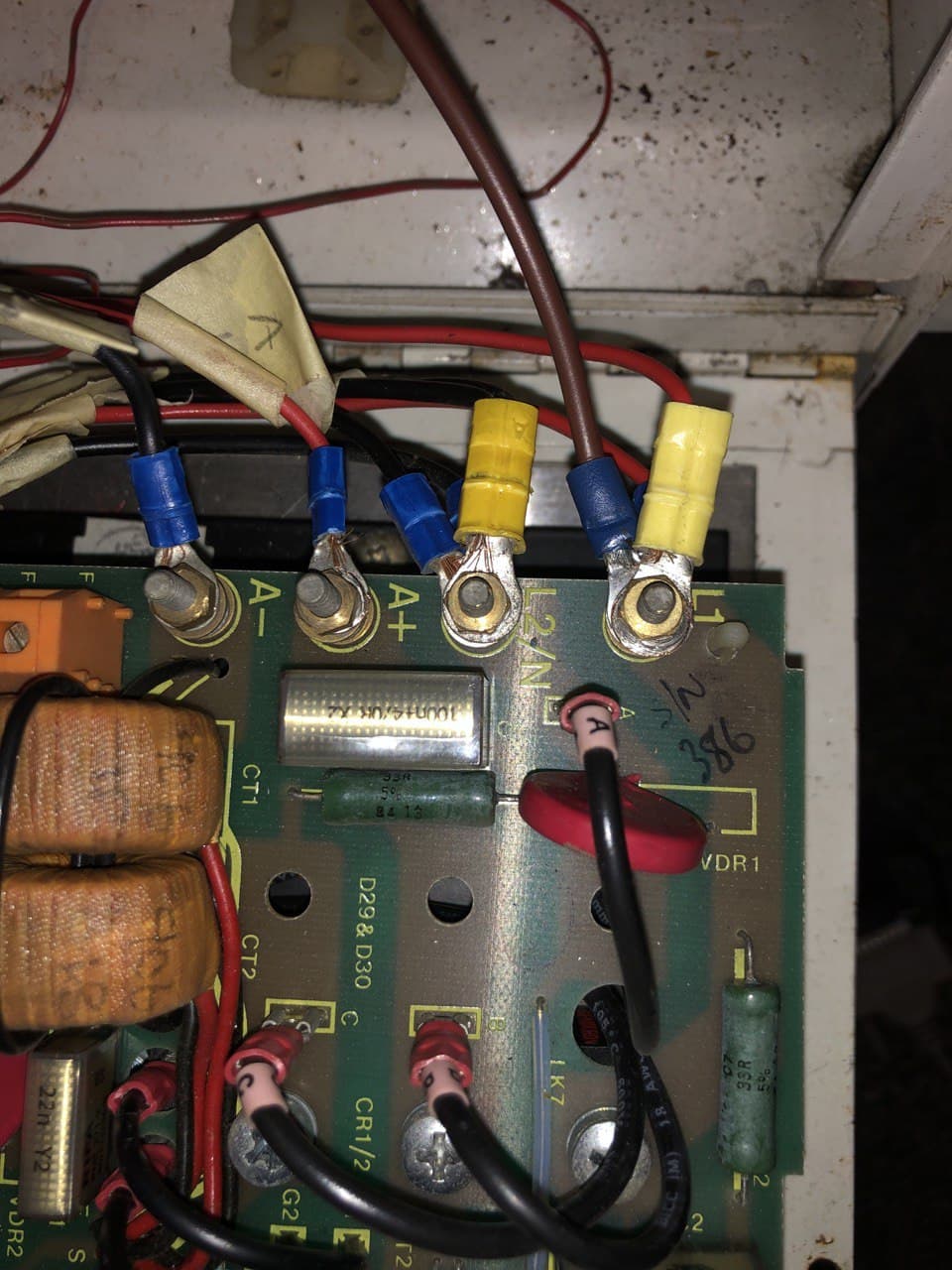

    I've removed the orange cover from the GEC Gemini board (please see pictures attached)

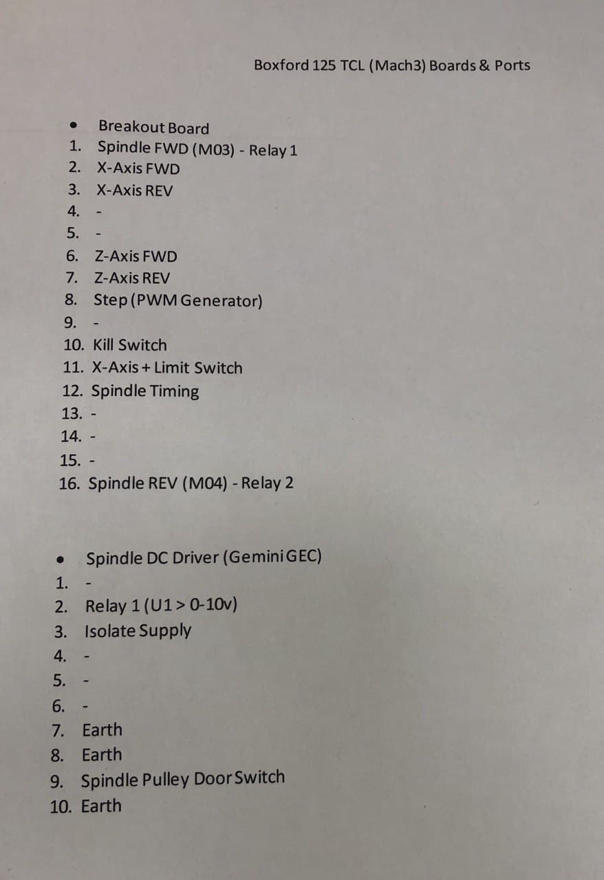

    I've also attached a picture of my "ports" findings for the BoB and Driver boards
