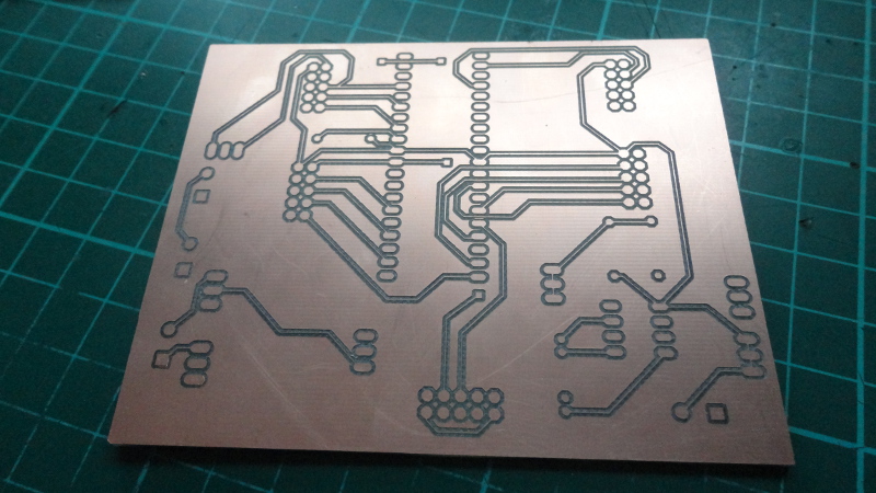

    There are hardly any tracks left and the left side still seems to have some issues, so I think that there is something wrong with his machine.
    There is an auto leveller built into UCCNC also, but I never tried that one.
