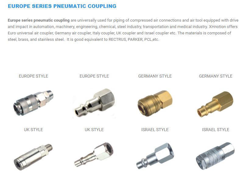

    I can't make sense of the apparent panoply of air line couplings. I have recently purchased a compressor and a tiny pencil grinder from Germany and also a Fogbuster kit from US (although sourced from Sorotec Germany). I need to get some kind of splitter and an oiler for the die grinder. I guess the compressor and die grinder have some kind of Euro fitting and the Fogbuster some kind of US fitting - none of the manufacturers specify which kind - they just seem to assume you'll know. Most of the UK-available stuff seems to be BSP, of course.
    How do I make sense of this stuff ? :) - I've tried a bunch of reading and web browsing - all I'm finding is more connector types - which isn't helping any. For instance for 'Euro' connector, I find this:

    - which is really not helping. Some advice?

    The UK style you can find by search for PCL air connector, as it's probably the most commonly used.
    Some people do prefer the Euro/German styles (I can't remember their proper names)
    I will say if you do go PCL, buy genuine PCL, as there are a lot of cheap copies, that quite frankly are no where near as good, and will fail/ start leaking with little use.
    In terms of fittings, nearly all air tool fittings will be some variation of BSP. 1/4, 3/8 and 1/2" depending on the tool. But it may also be described as G1/4, G3/8, or G1/2, which is just BSP with the inch bit dropped, and a G added to magically make it metric.

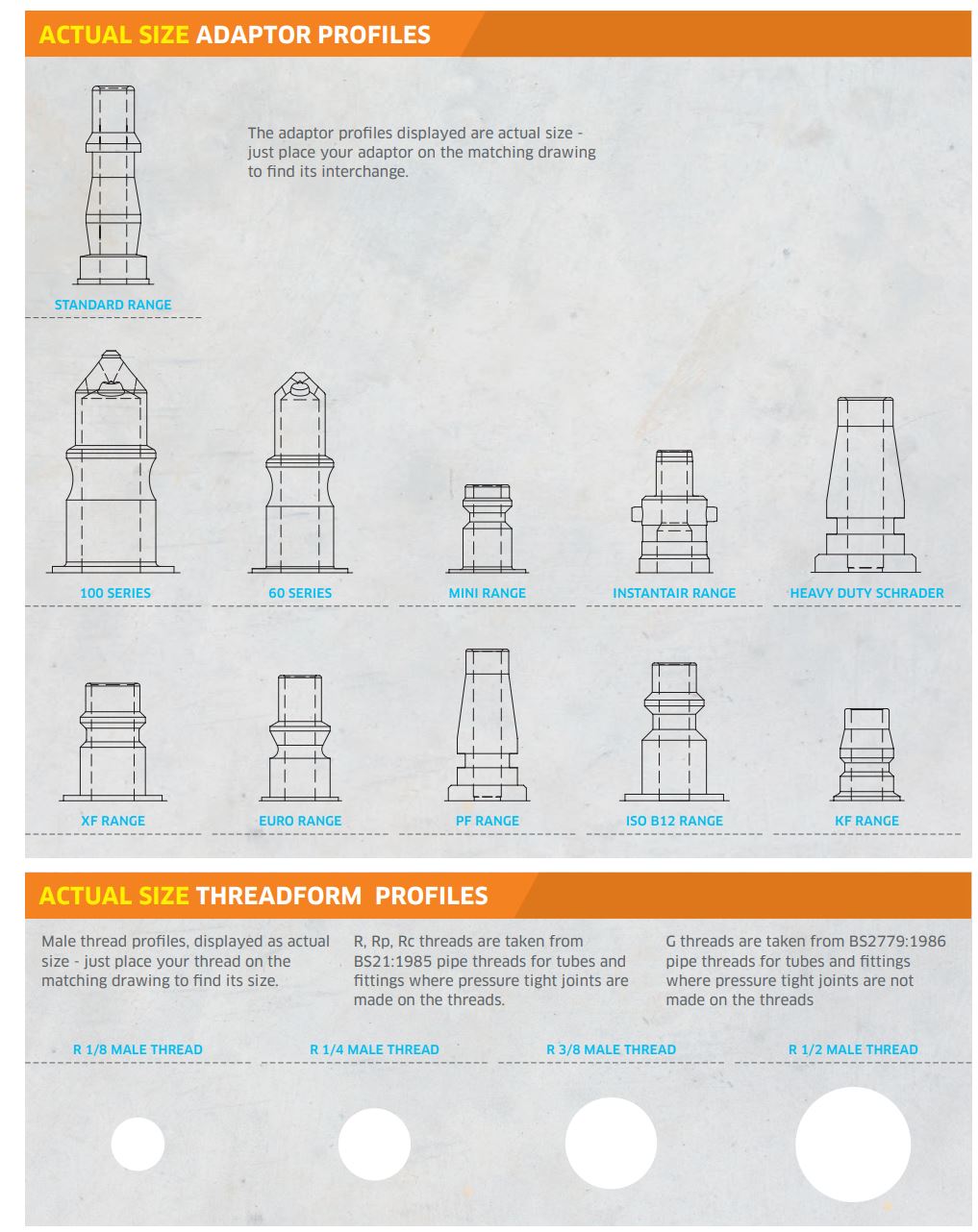

    For anyone playing along - here's most of the varieties of just the PCL range:
    And I think I'm going to standardise here on PCL XFs as that's what the tools I have here have already.
    Alan

    Just to add a little bit of spice, whereas page 19 of PCL's catalogue (above) shows 'XF' and 'Euro' with distinct profiles ... PCL likes to call one range of their connectors 'XF-Euro' - go figure.
