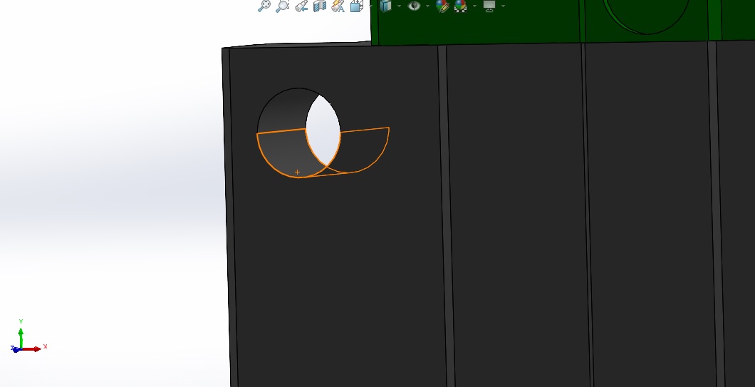

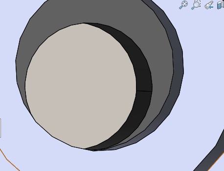

    never had this problem before because it was just a matter of selecting the hole diameter of one object and mating it with another hole and they would both match up bang on. however i cant seem to do it this time because the cad model i downloaded the holes are split into 2 pieces as shown in the pic, so when i am mating and i select 1 half of the hole it doesn't align up with my plate holes.
    any tips please?
    thanks

    U can make a sketch , and select circle , and there u can select a 3 point circle , after that u can make a coincident point on the circe u want to make inside .
    Thank you i will try this
    The other thing I'd try is using a concentric mate rather than a bog standard coincident faces mate.
    this worked perfectly thank you
