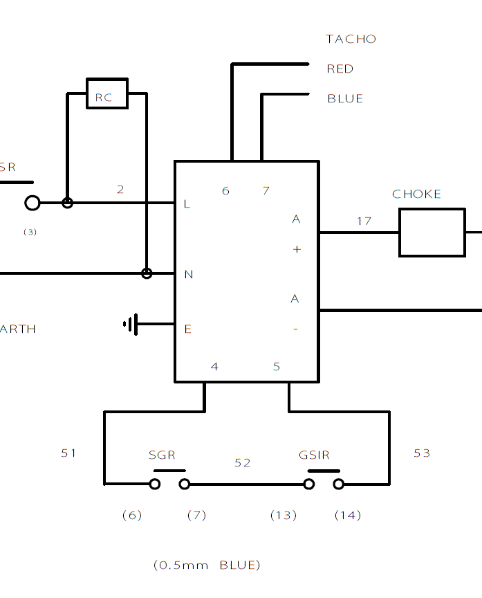

    The fact the drive runs with the SGR (Spindle Go Relay) relay removed, indicates either a fault with the sprint drive, or somebody has altered wiring.
    I think I'd start with comparing the wiring to the wiring diagrams.
    54 should go to terminal 49 on the connector board, and 55 to 47.
    The enable circuit passes through the SGR, and the enclosure safety switch relay -
    If the spindle still activates with the 51/53 wires disconnected from the drive, then there is an issue with the drive.
    But that wouldn't explain why you're not getting the expected 0-10V output.
    You are measuring the voltage between the 54/55 wires, and not to gnd?

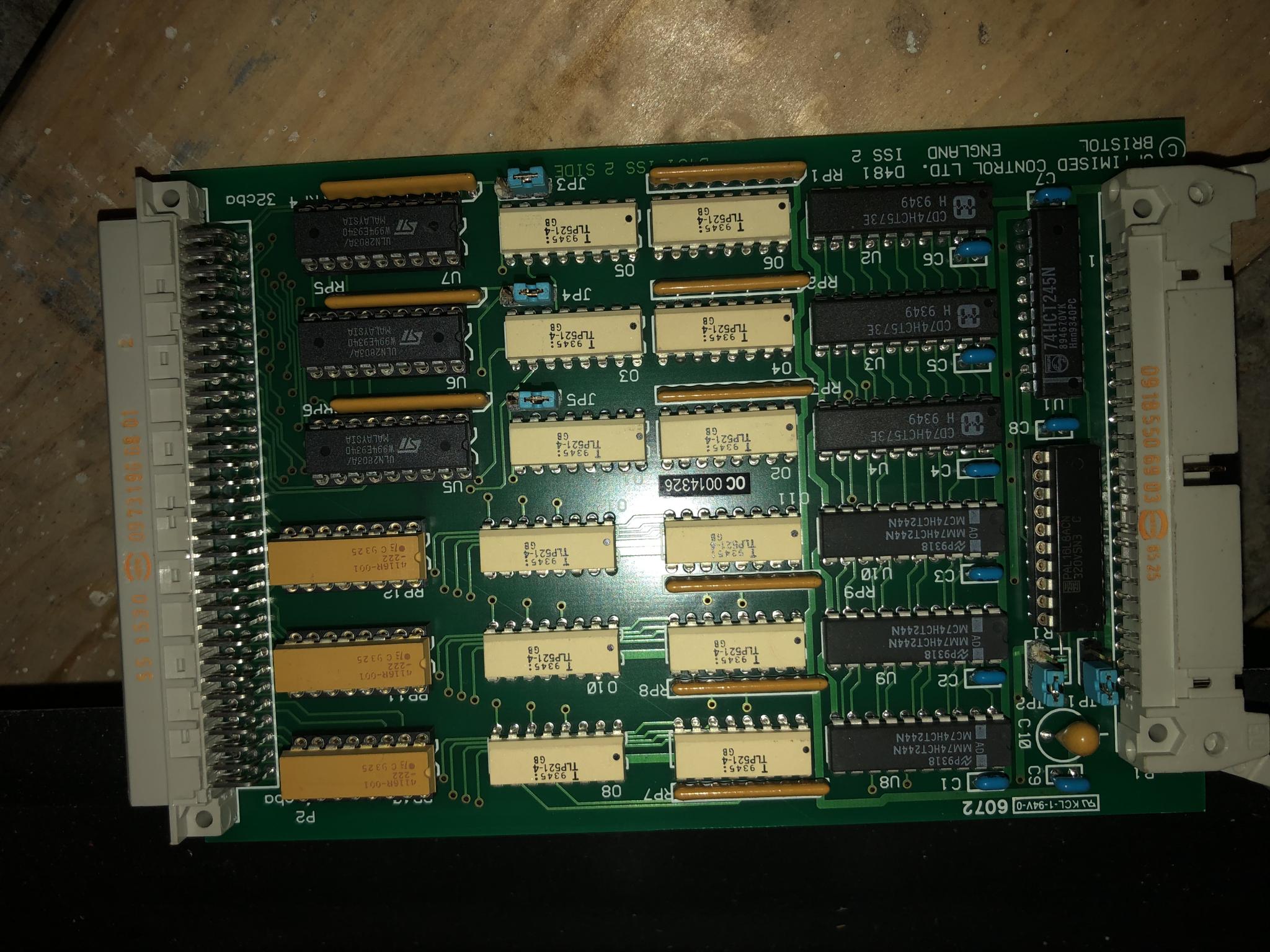

    Here’s the custom card… any pointers gratefully received!

  11. #29
    Lives in East Lothian, United Kingdom. Last Activity: 14 Hours Ago Forum Superstar, has done so much to help others, they deserve a medal. Has a total post count of 2,994. Received thanks 376 times, giving thanks to others 9 times.
    That card is just logic chips and opto-isolators.
    What's on the card to the left from that one?

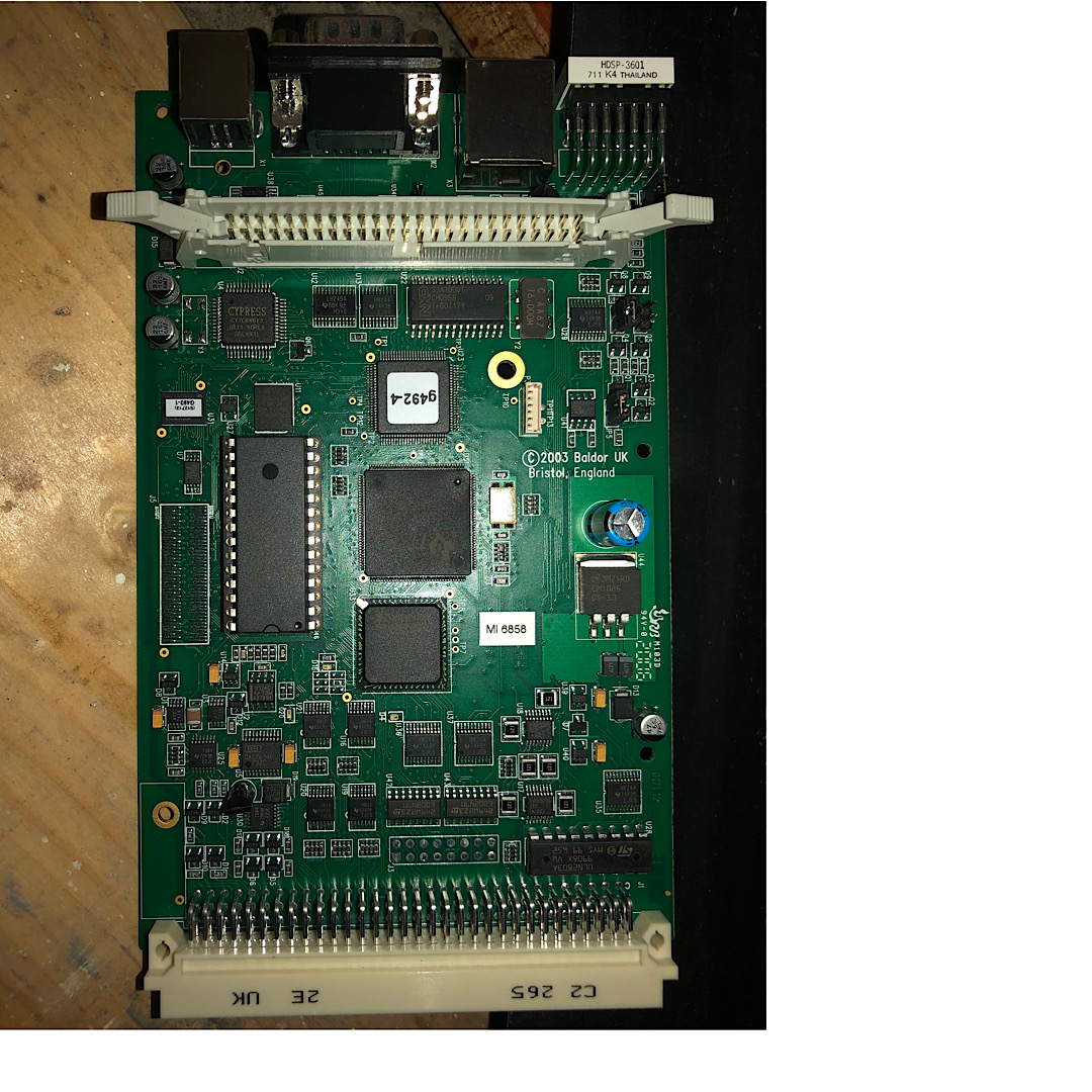

    This is the first card, to the left of the custom card.
    This is the Baldor card.
    The cards to the right of the custom card are the 3 individual axis cards.
