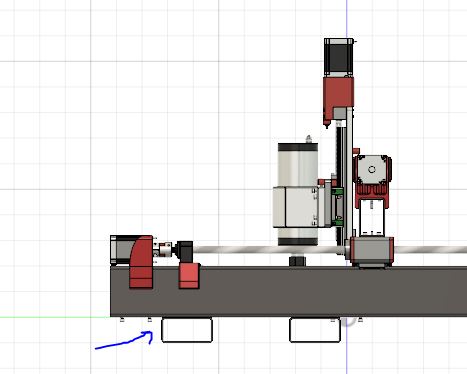

    now I was thinking to leave some over hang with the RSTs supporting the Y axis (so I could tap some boards vertically)
    could it increase the chance for vibrations? and how to mitigate it ?
    Provided you keep the amount sensible then it won't vibrate, I build machines that hang the tool past the front by 90mm and it doesn't affect them at all.
