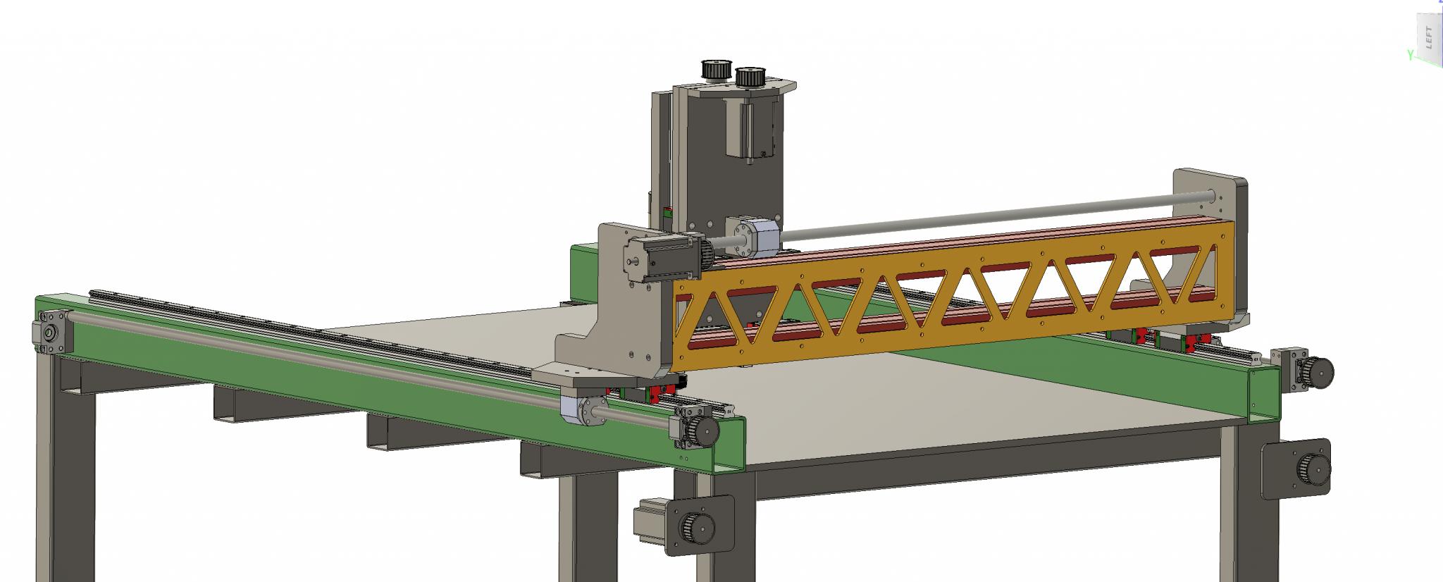

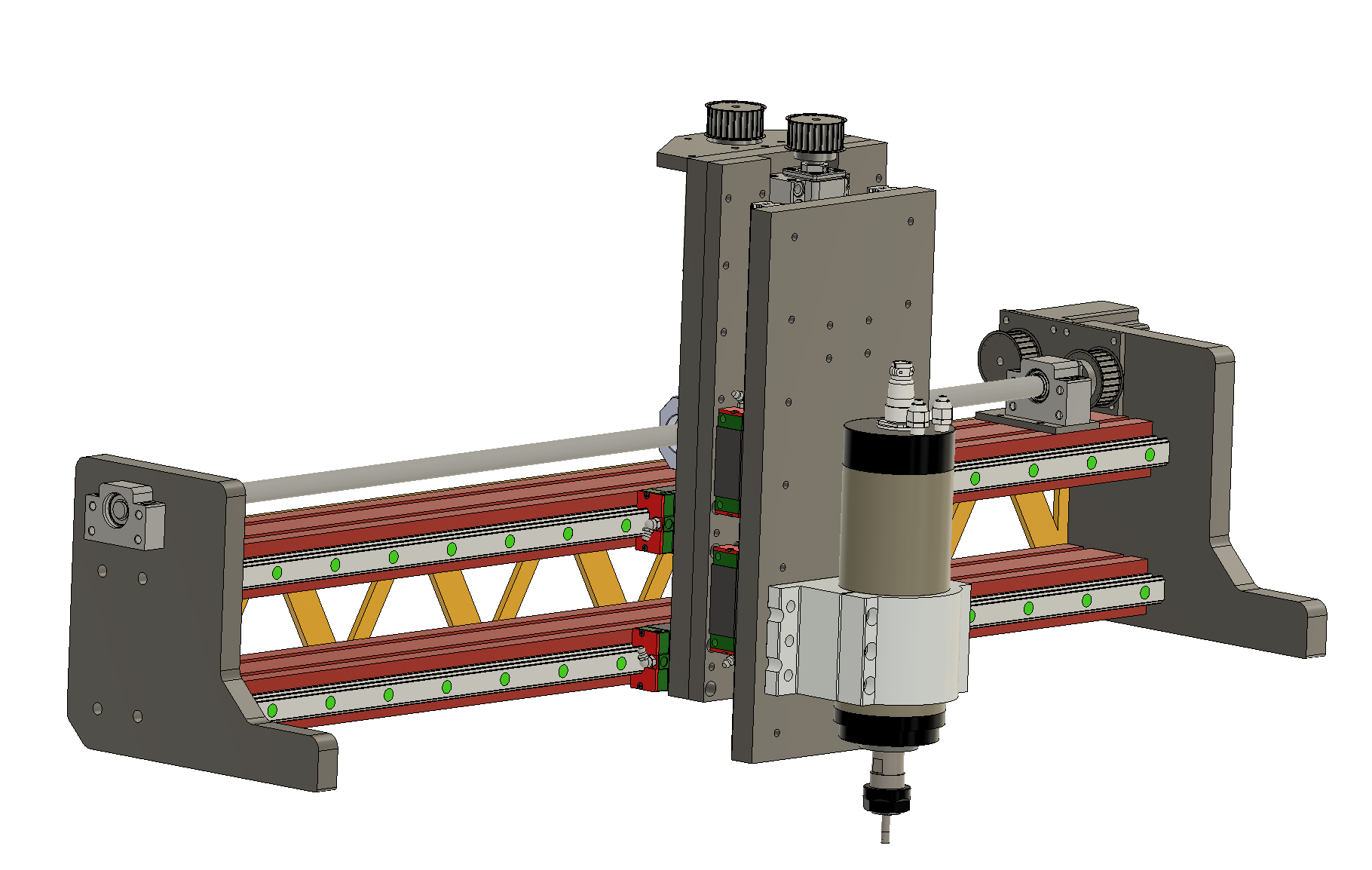

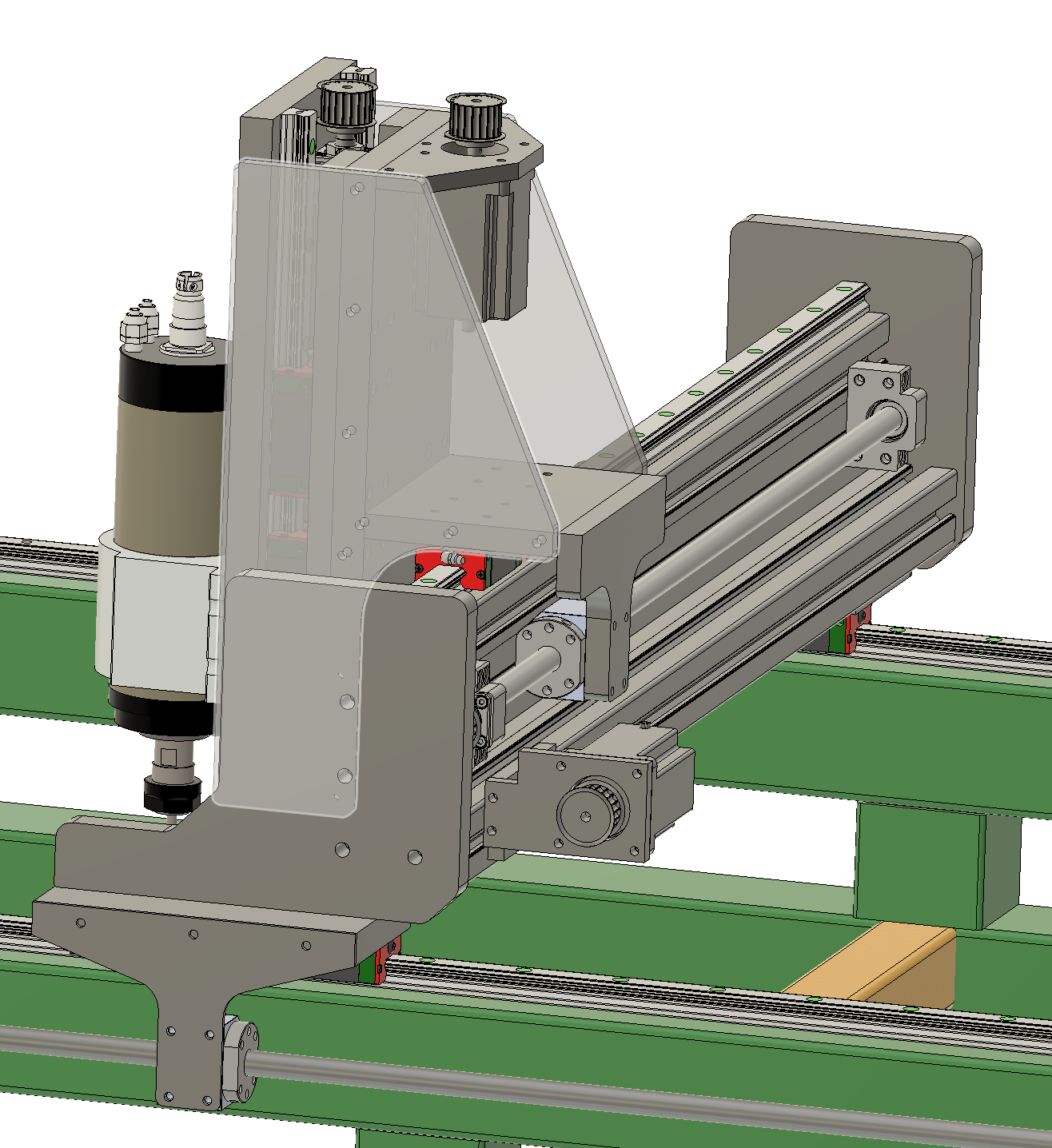

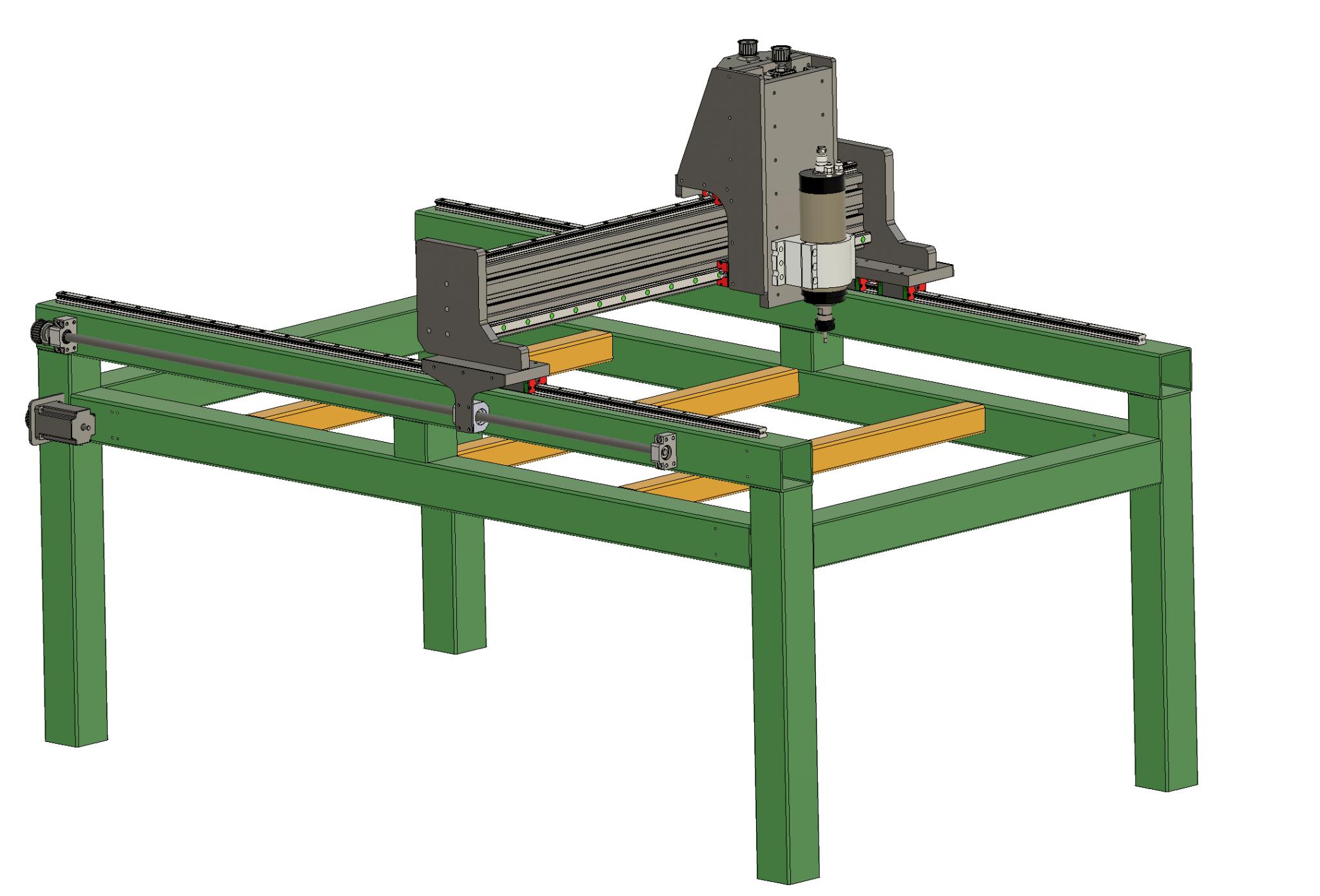

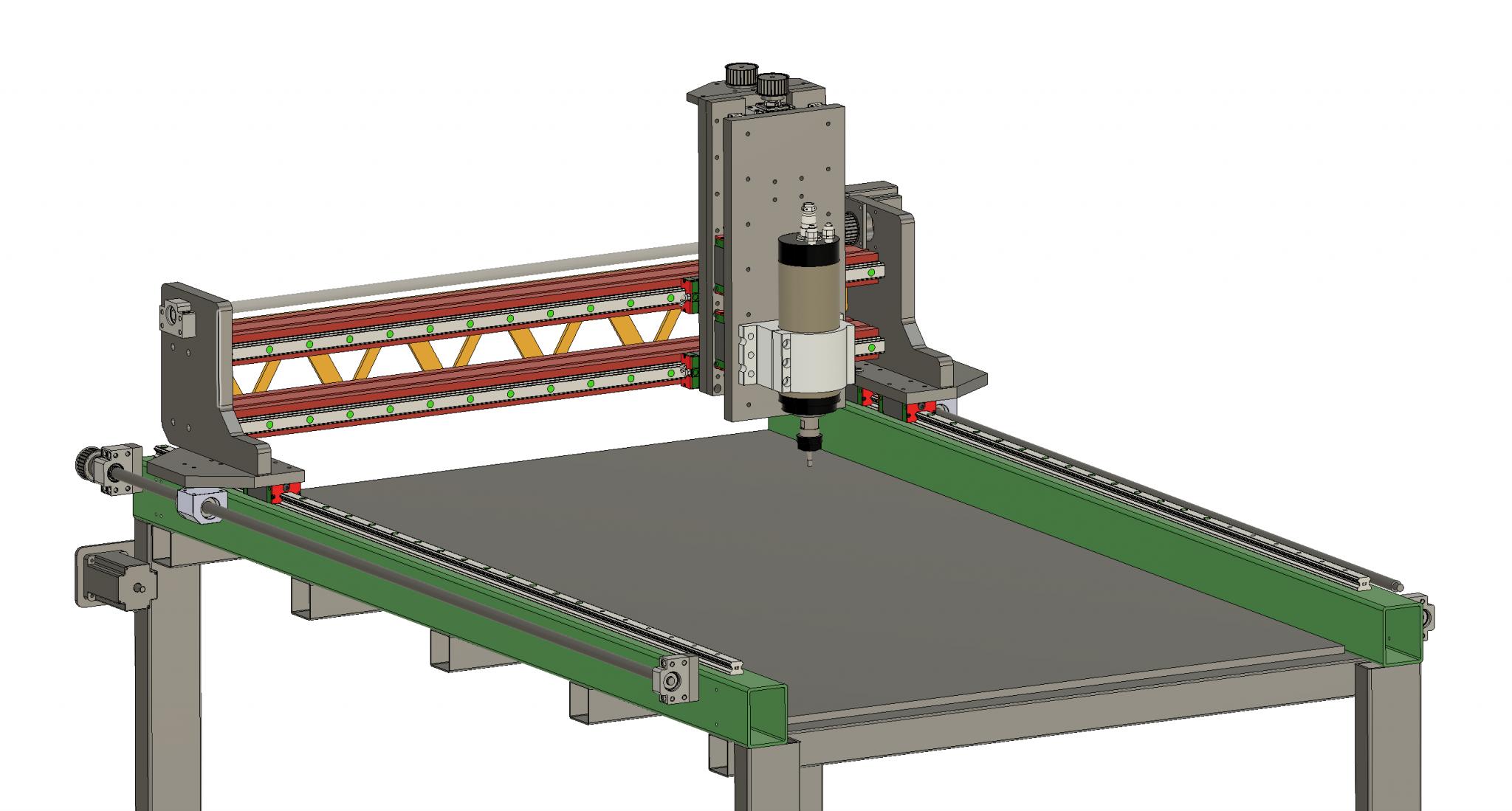

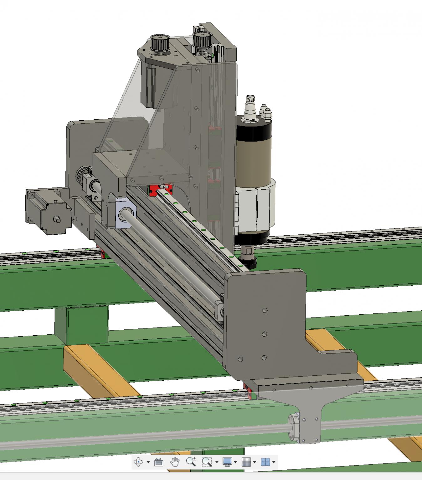

    Current design
    Size: Rail lengths 1000x1500x400 mm. Maybe it’s reasonable to make the router smaller so it could be more rigid with same ball screws and frame design. The 1500 mm could be changed to 1000 mm for example. Mainly considering this due the lower price of 1605 ball screws.
Name:	Screenshot 2021-09-28 at 18.41.21.jpg
ID:	30493Click image for larger version.
Name:	Screenshot 2021-09-28 at 18.41.37.jpg
    Custom parts (plates): Surface milled (mainly 20 mm) aluminum plates, I plan to order water cutting of the parts. Where needed I could make counterbores for the hex socket bolts using special counterbore drill.
    Base frame: Rectangular tube steel, design is yet not final. I am able to weld it by myself.
    Gantry beam: 4080 aluminum profile with sheet metal reinforcement. I know the 45x90 design recommendation, but it would cost me 60€ more, yet I am open to your opinion - is the 45x90 L design gantry worth this money?
    I've built literally 100's of machines now using the 45x90 with my "L" design gantry so I'm probably a little biased, but it just works and pound for pound it's the strongest arrangement I've ever used. Yes, I've built and still do build machines with stronger gantry's but they are much much more expensive and complicated to build and can only be done if you have a CNC machine to start with.

    If your main goal is to cut aluminum then you need a stronger base and gantry along with a ridged Z-axis.
    Recommendations for stronger design are welcome. I made a base frame design, larger rectangular tubes are 80x80x4 and smaller ones 50x50x4.

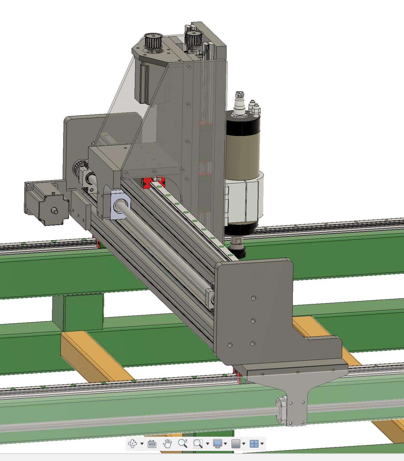

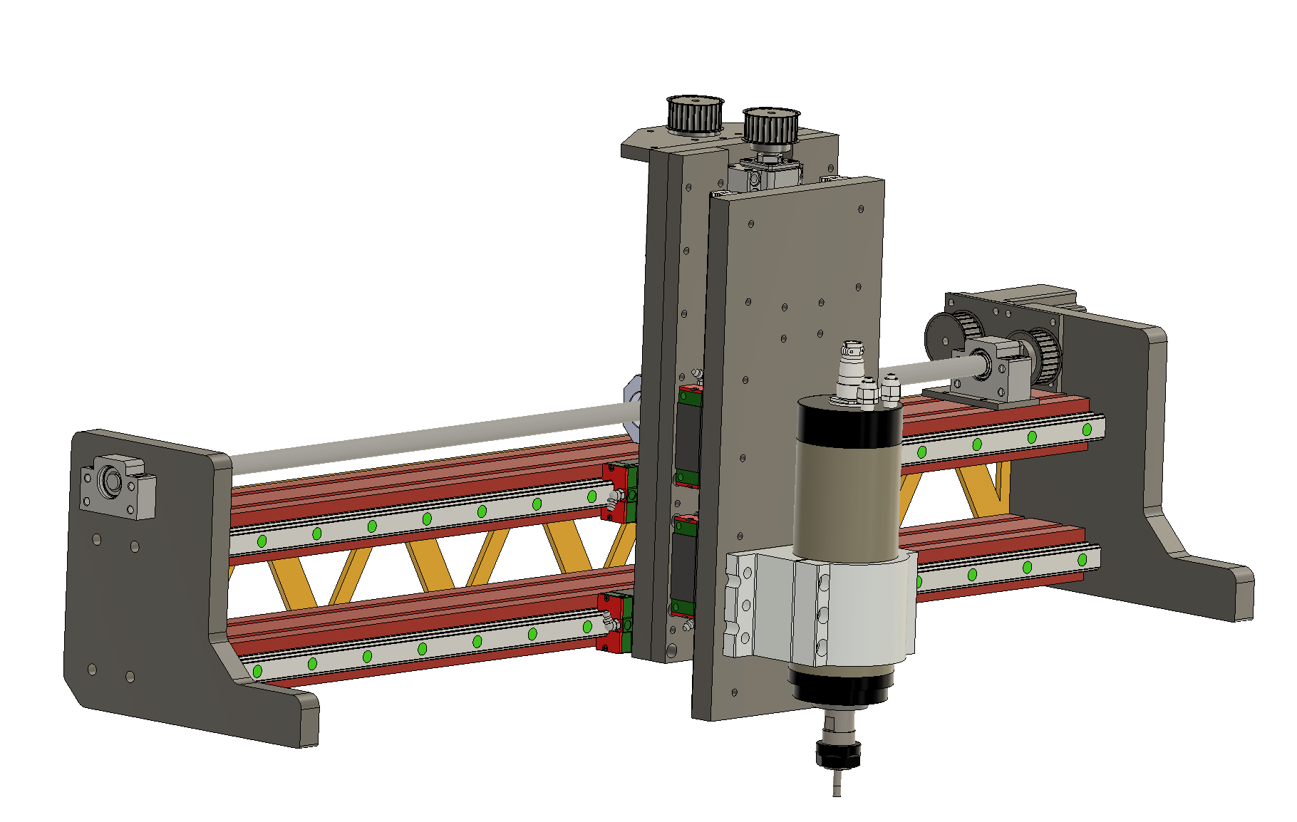

    I actually had the 45x90 already made in 3D model, now I can show it. I also added reinforcement plates for the Z axis sides. Yes, I got the idea from your webpage, JazzCNC :)
Name:	Screenshot 2021-10-13 at 19.26.29.jpg
Name:	Screenshot 2021-10-13 at 19.26.46.png
