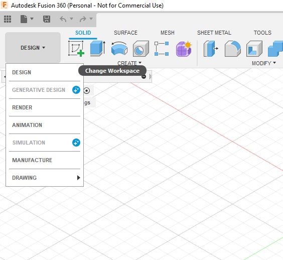

    Interesting. In my installation, it's at the top left! Once the 30 days are you you should be asked to declare you are a hobby / student etc user, then it's yours for 12 months, at which time they ask again and you get another 12 months.

    ah ok i was following a tutorial but on their version it was called cam not manufacture but the simulation is greyed out and tells me to subscribe to a paid version to use it.

    Yup, the free version definitely includes CAM. But simulation - depends what you mean! It will definitely do toolpath simulation - I do it all the time. You can also move parts around in the modelling ("Design") environment within their permitted constraints to examine clearances, etc, and you can ask it to look for clashes between components. But a lot of the more sophisticated mechanical analysis tools are paid version-only.
    ...and because they keep tweaking the user interface and layout, tutorials often are out of date. You just have to try to translate.
