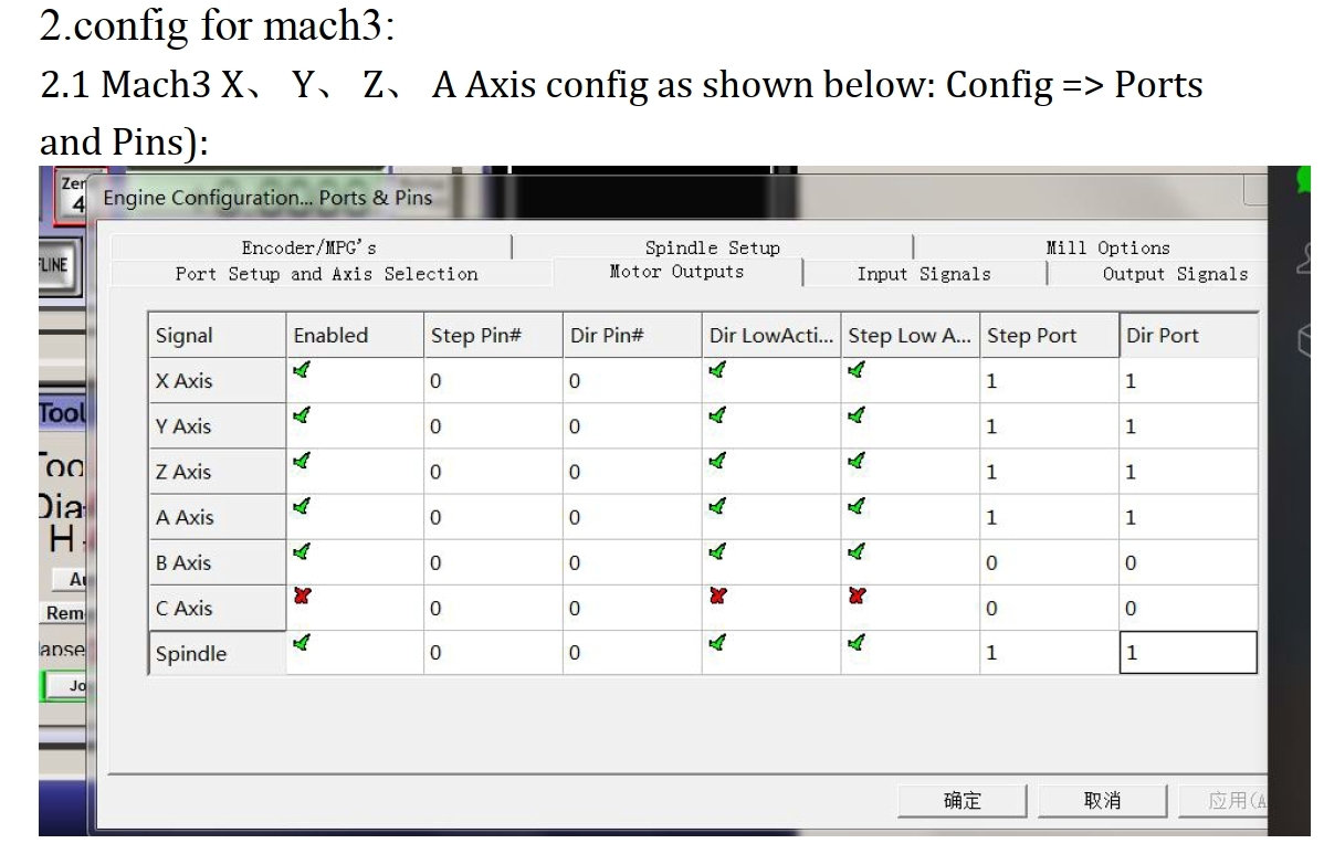

    My Mach3 5 axis controller board came today and although there was a lot of documentation supplied with it, there was not enough to setup the board properly.
    All the stepper motor settings are shown as 0 for all the steps pins and all the dir pins. I know that is not right, but how do I determine which are the correct settings? Can anyone help me with this?

    I don't know your board, but a Chinese NVEM controller specifies in the manual that the X/Y/Z/A/B/C ports are hard-coded in the driver and you don't need to specify them in Mach3 (defaults to port/pin 1/0). Try it and see.

    First google hit I found on that board number confirms the above.
    https://www.duxe.ru/upload/iblock/40...c4d2421927.pdf

    Thanks jazz, read page 5 of the link you provided, same as the link I provided from the Russian site to back off the analogy i first posted. My first post clearly started the info from the different card and was what I had to hand at the time.
    My recommendation remains, try it as is, the provided driver software hard codes the output mapping

    Mach3 knows nothing about USB, so definitely the board is an motion controller.
    On the picture:
    http://www.mycncuk.com/attachment.ph...811440&thumb=1
    is clearly visible a micro controller (no matter which type but looks as some STM32Fxxxx).
    So, motion controller with BOB :)
