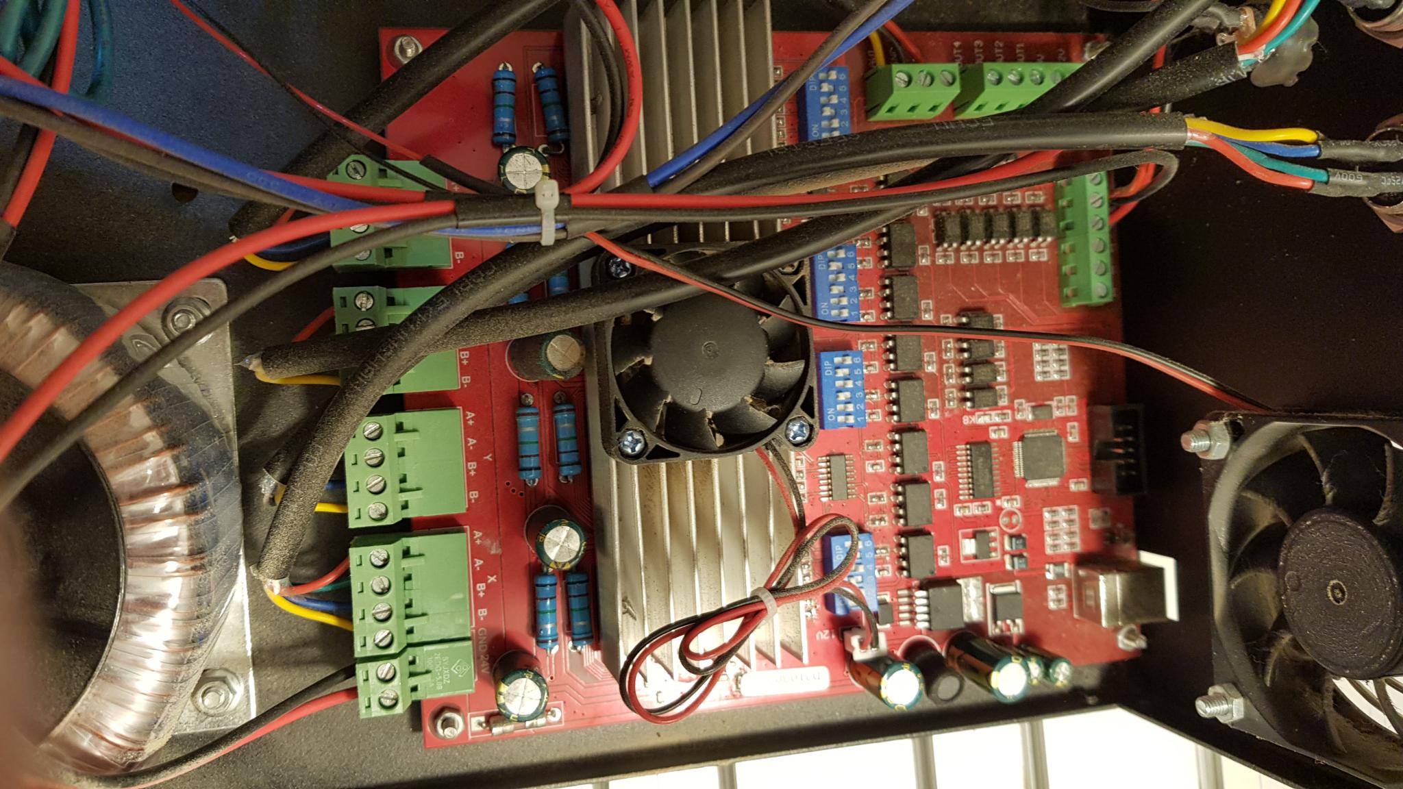

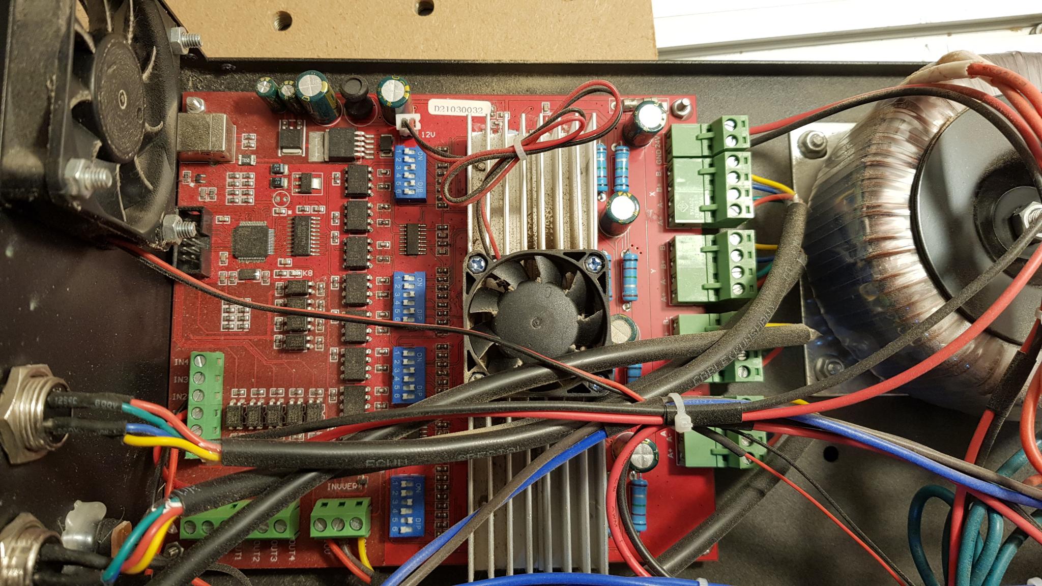

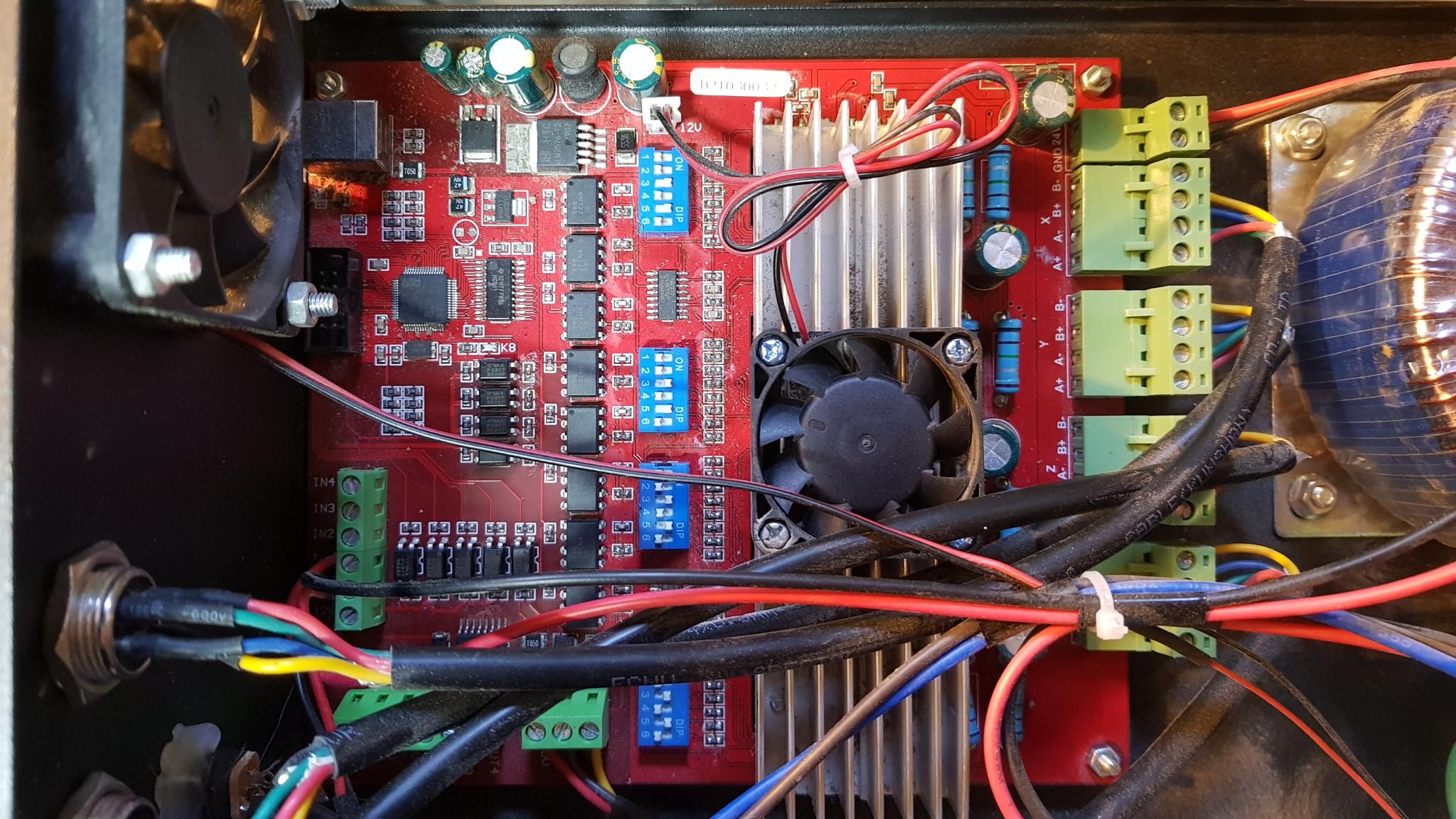

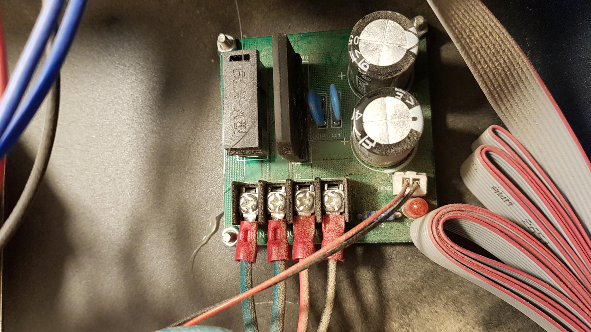

    This is what i have, what do i need and what do i have to take out....cheers

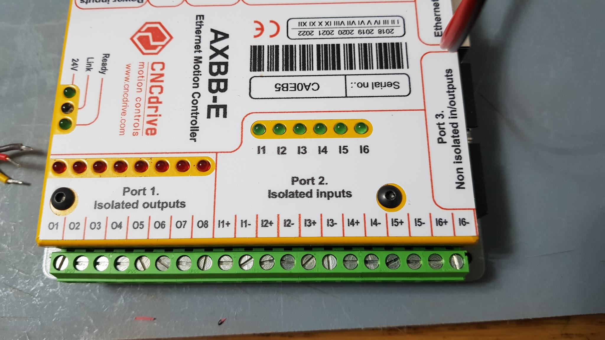

    Just received my AXBB-E and i also got a 5v and 24v psu so all i need to do now is panic as i dont have a clue what im doing......Help
ID:	30861 do i keep this board as it has the X Y Z axis attached
    UPDATE.....Have connected Axbb-e to the 5v and 12v power psu and also connected network, so now need to build a bigger controller box so all will fit in.

    That is an all-in-one board with controller and motor drives combined so you can't use it because you can't control the drives.
    To use with the AXBB-E you will need separate drives.

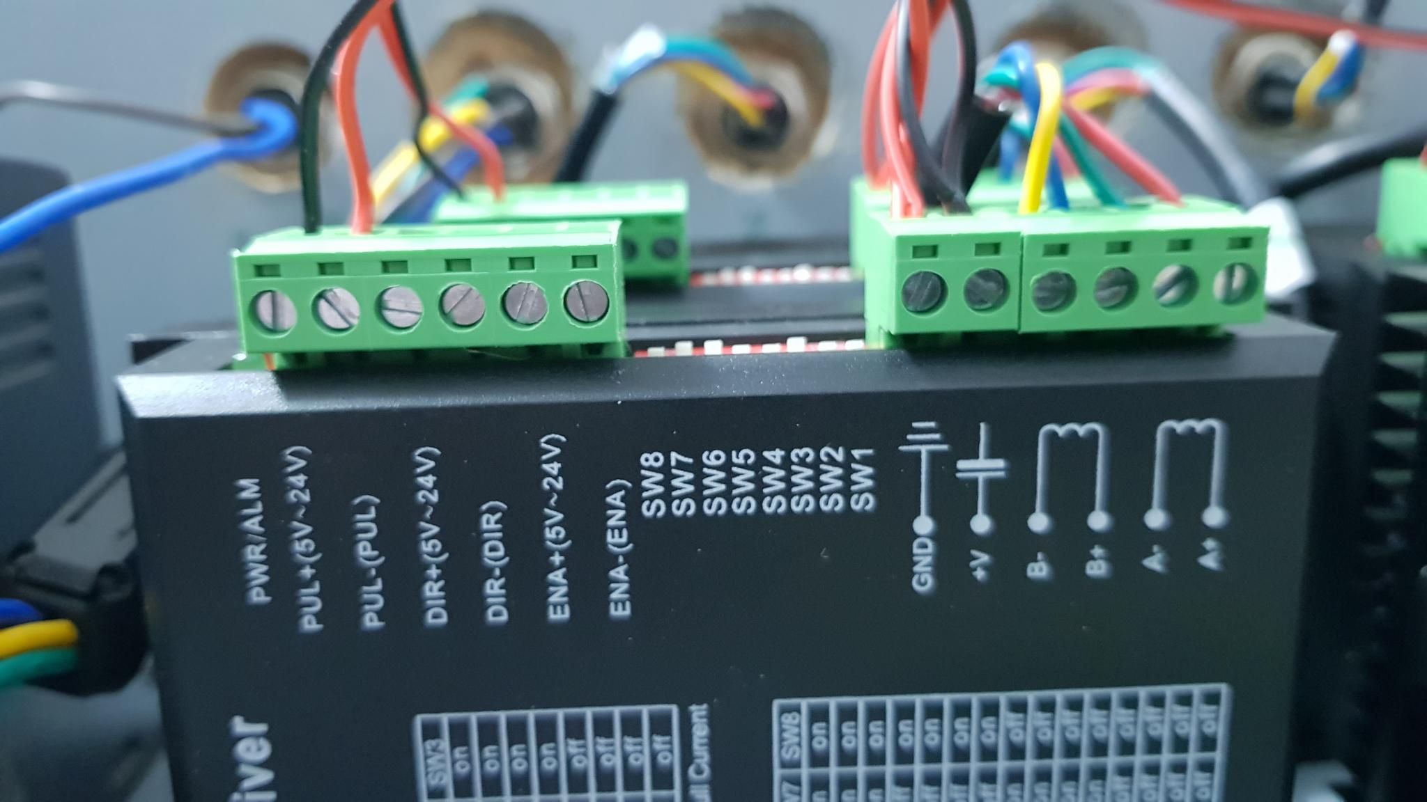

    This is typical of Chinese machines as they fit oddball motors which you probably won't find any info about. However, doesn't really matter too much because you will only have at best 36Vdc from the PSU so any drive with a 50Vdc max rating will work for you. Because you can't tell the motor current a little trial and error will be needed on the amps but this is no big deal as they will just run hot if too high and stall easily if too low.
    These will work fine for what you need and will work miles better than what you had before. But before buying it's worth checking the voltage coming from the PSU
    https://www.omc-stepperonline.com/di...or-dm542t.html

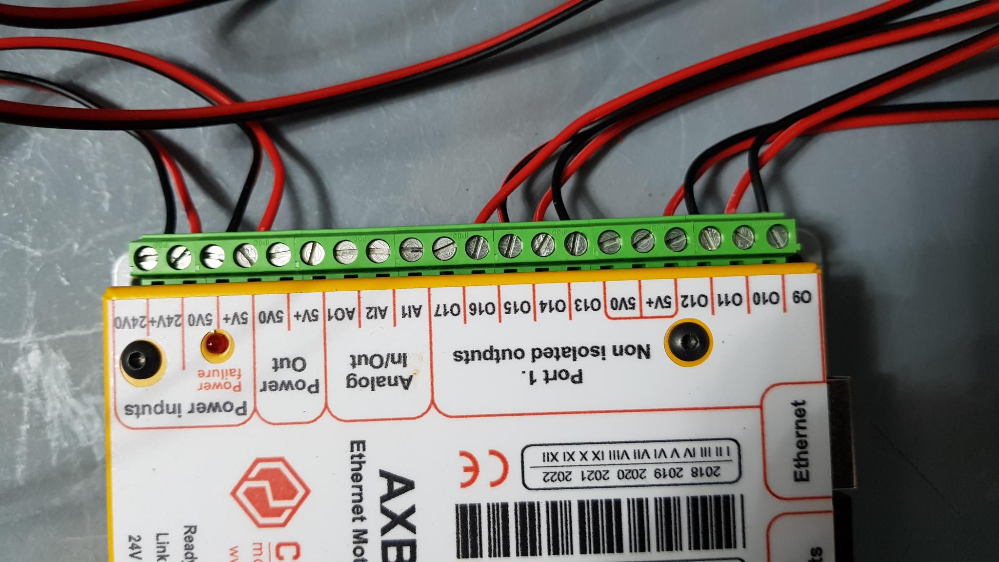

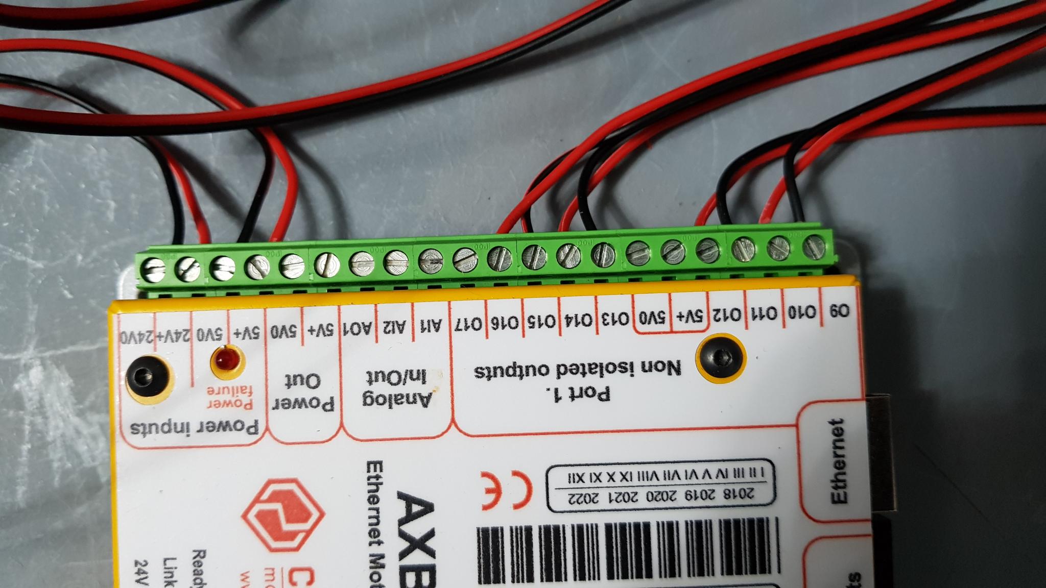

  13. #30

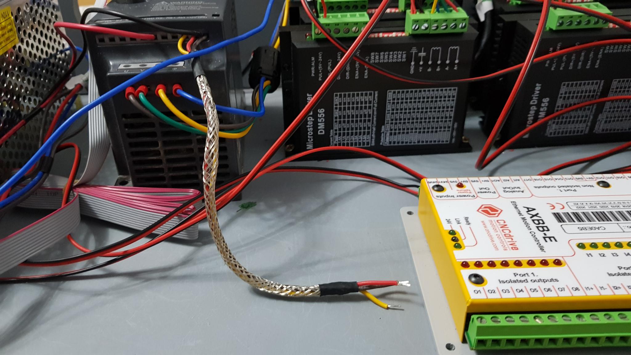

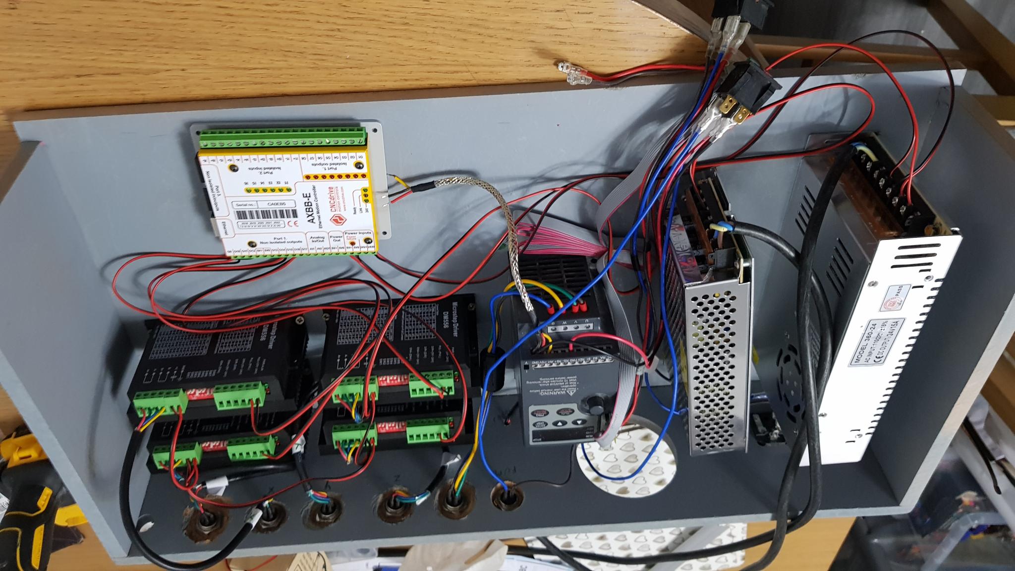

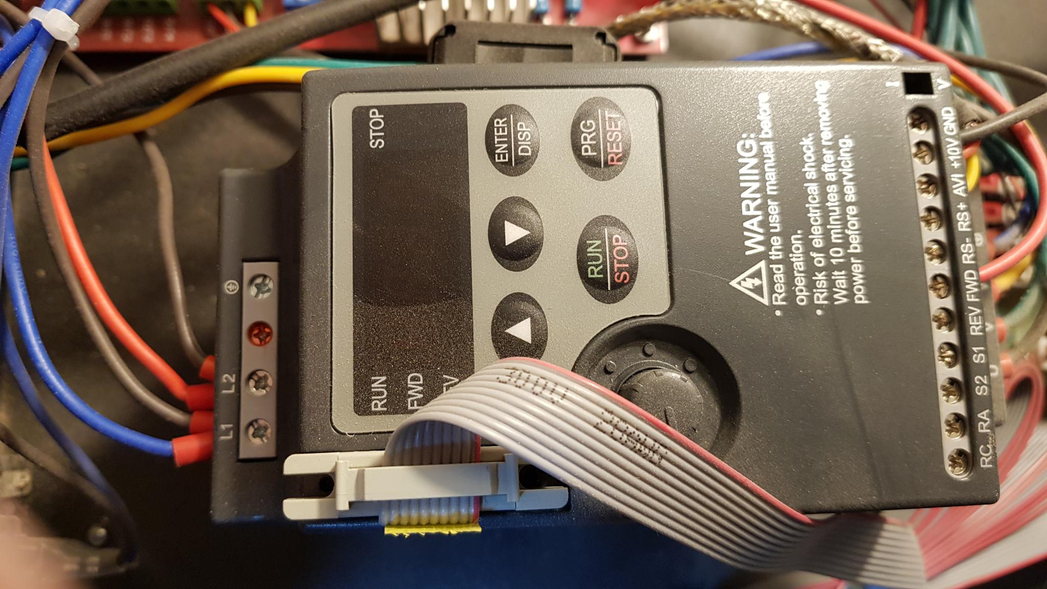

    Hi All,
    been having a go at building onto the AXXB-E attached are some pics and would like advice as to were I have gone wrong on the stepper drives, also the 3 wires lying by the AXXB-E are from the VFD av1 grnd and +10v were do i attach these to the AXBB-E, also emergency stop and pump.
    All the advice i have had up to now is much appreciated.
