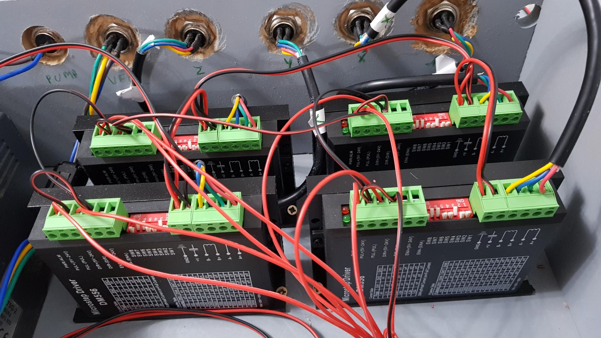

    im nearly there I think with wiring my Axbb-e , just got a few more questions.
    Do I need to wire on off switch, if I do …how, or can I just plug in without it.
    Wires coming from L1 AND L2 from back of VFD were do I locate these.
    Is it ok to loop my 5v power supply from my 24v power supply or should I use separate supplies.
    Cheers for all the advice and help..

    I assume you mean loop the mains input to the supplies. That is no problem, just do it carefully. I would advise using the correct size crimped spade terminals rather than trying to twist several mains wires together.
    You can have a mains on/off if you wish. I use a 4 way dis-board with individual switched outlets with separate feeds for the AXBB-E 5V/12V supply and the 36V motor supplies.
    Cheers for that. any idea where the red and brown wires from the VFD L1 AND L2 go onto the Axbb-e

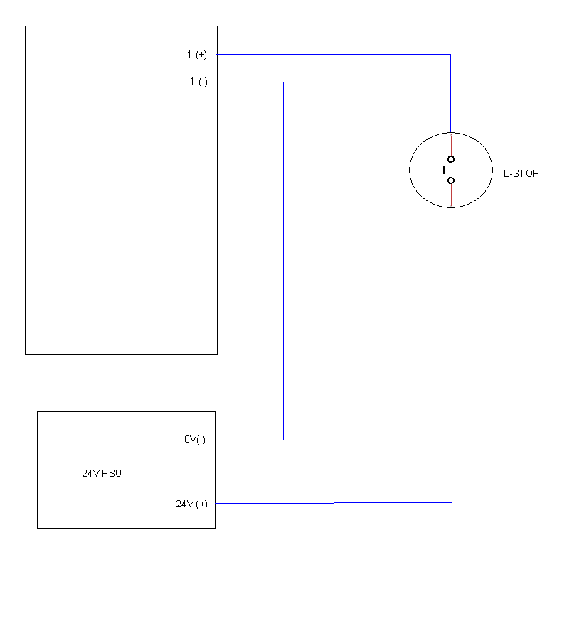

    Hi Macca,
    I got your email but thought I'd reply here then others can get some thing from it if needed,
    Quote Originally Posted by mrmacca View Post
    You don't need an On/Off and can just use the Mains switch on the wall but a separate switch is nice to have and simple to fit. Just use any switch rated to handle 240V and break the Live wire or better still a 2 pole switch and break both Live and neutral. Don't break the Earth wire.
    On a separate note to be safe you should really have a latching safety circuit built into the E-stop that turns off power to the drives when pressed and won't be allowed to reset until all is safe. The easy way to do this is with a Relay and Momentary button wired in series with the E-stop. If you want to do this just say and I will draw you a circuit showing how.
    If you don't have a latching system the moment you turn on power the drives will become active so if say for instance the E-stop was released and UCCNC was running code when turned on the machine will instantly start moving with no clue where it is and will crash.
    With a latching system this can't happen also a signal will be sent to the controller saying an E-stop is in place and won't allow UCCNC to Reset.

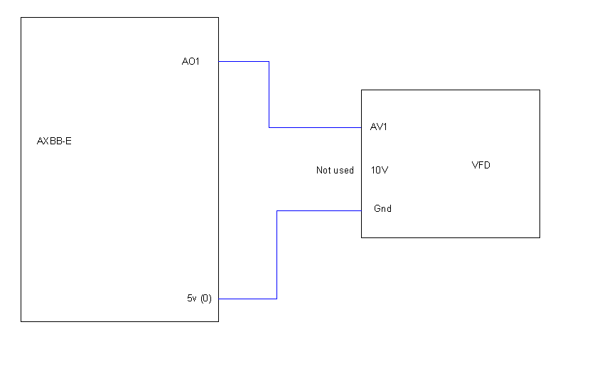

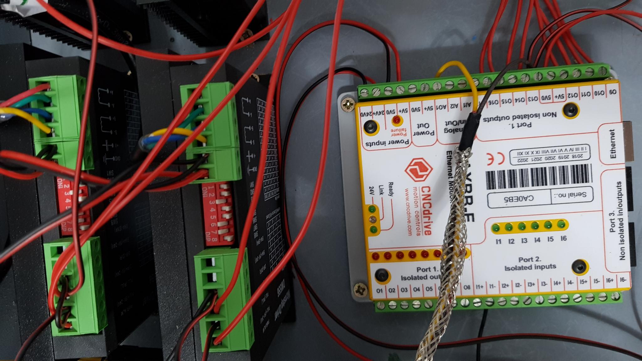

    Cheers, a latching system would be good if you could do me a diagram , as for the VFD the wires are coming from L1 and L2 and i cant remember what they were attached to, yes i want to join the power inputs so they operate from one cable. What about fans i have 2 were do i connect these.Click image for larger version.
ID:	30886 Click image for larger version.
ID:	30887 The cables from the VFD went to in1 and ov on the old board.
    Cheers for all the help, I'm sure I will need more.
    Attached pic. colours might not match yours but should show you how it's done.
    Edit: Note that you need a contactor rated to suit the PSU which turns on the drives. Don't use a Relay if you are switching DC to the drives.
Name:	Latch E-stop.png
    They are the Mains Input so put Live to L1 Neutral to L2.
    Need to know more about the fans.
