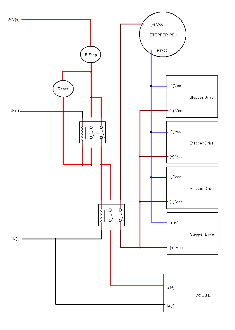

    On a separate note to be safe you should really have a latching safety circuit built into the E-stop that turns off power to the drives when pressed and won't be allowed to reset until all is safe. The easy way to do this is with a Relay and Momentary button wired in series with the E-stop. If you want to do this just say and I will draw you a circuit showing how.
    If you don't have a latching system the moment you turn on power the drives will become active so if say for instance the E-stop was released and UCCNC was running code when turned on the machine will instantly start moving with no clue where it is and will crash.
    With a latching system this can't happen also a signal will be sent to the controller saying an E-stop is in place and won't allow UCCNC to Reset.

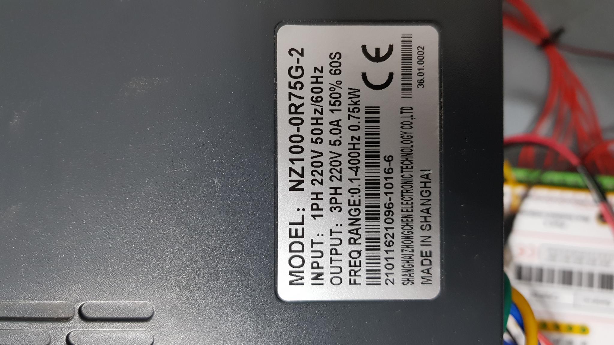

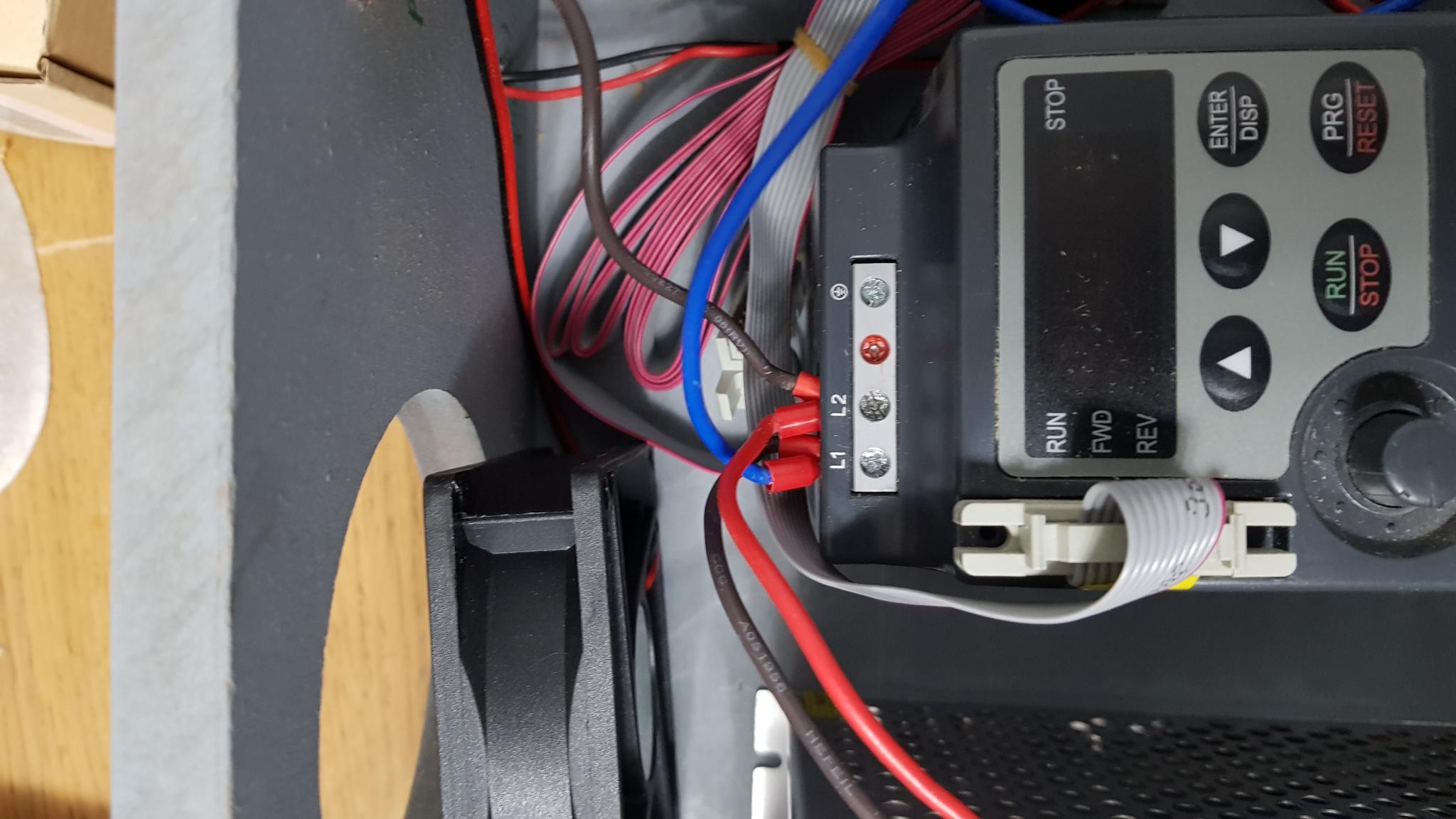

    Wires coming from L1 AND L2 from the back of VFD where do I locate these.
    L1 and L2 are usually the Mains Inputs but without seeing and knowing more about the VFD it's difficult to know or advise safely. Give better pictures

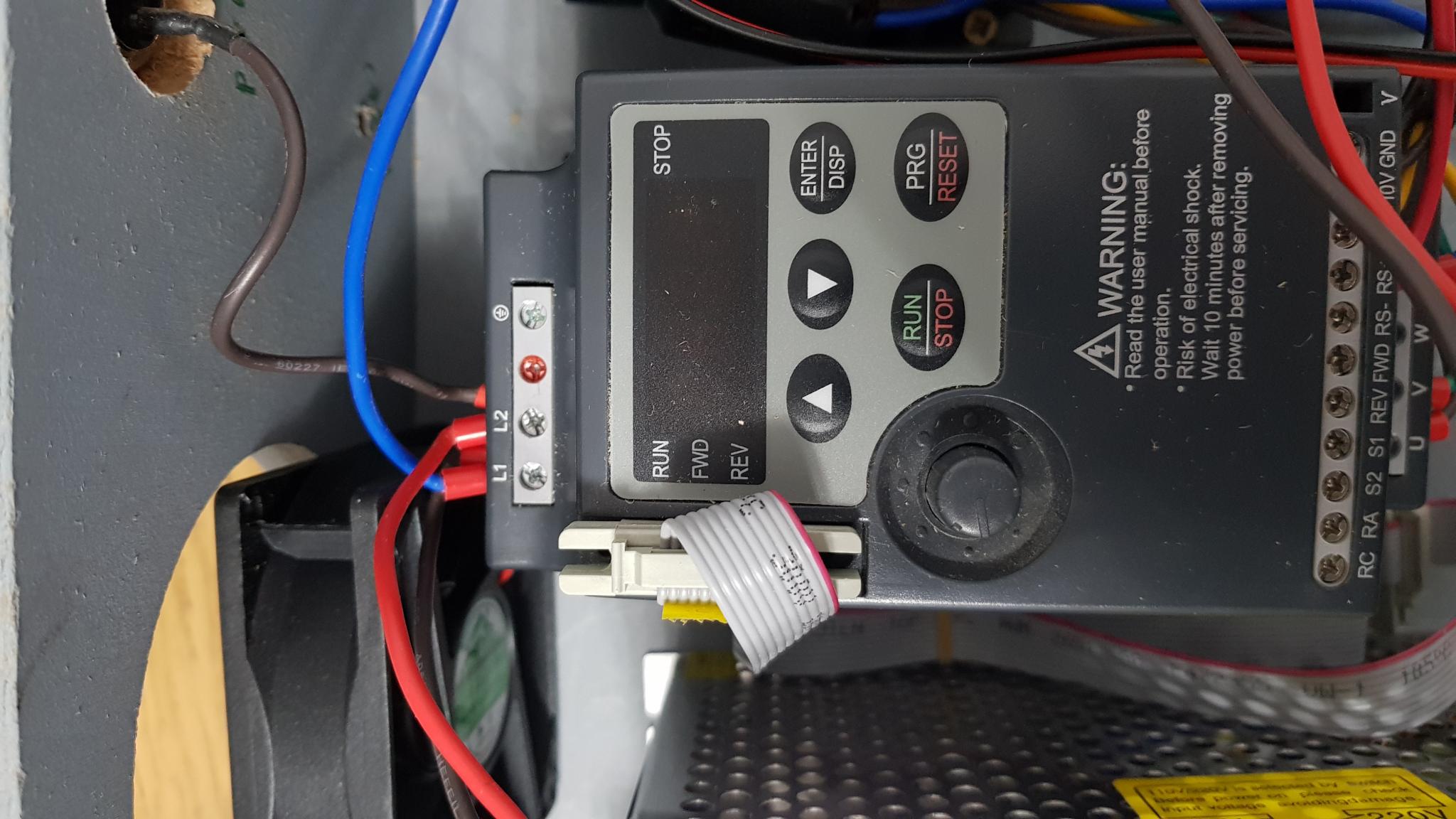

    Cheers, a latching system would be good if you could do me a diagram , as for the VFD the wires are coming from L1 and L2 and i cant remember what they were attached to, yes i want to join the power inputs so they operate from one cable. What about fans i have 2 were do i connect these.Click image for larger version.
    Attached pic. colours might not match yours but should show you how it's done.
    Edit: Note that you need a contactor rated to suit the PSU which turns on the drives. Don't use a Relay if you are switching DC to the drives.
    They are the Mains Input so put Live to L1 Neutral to L2.

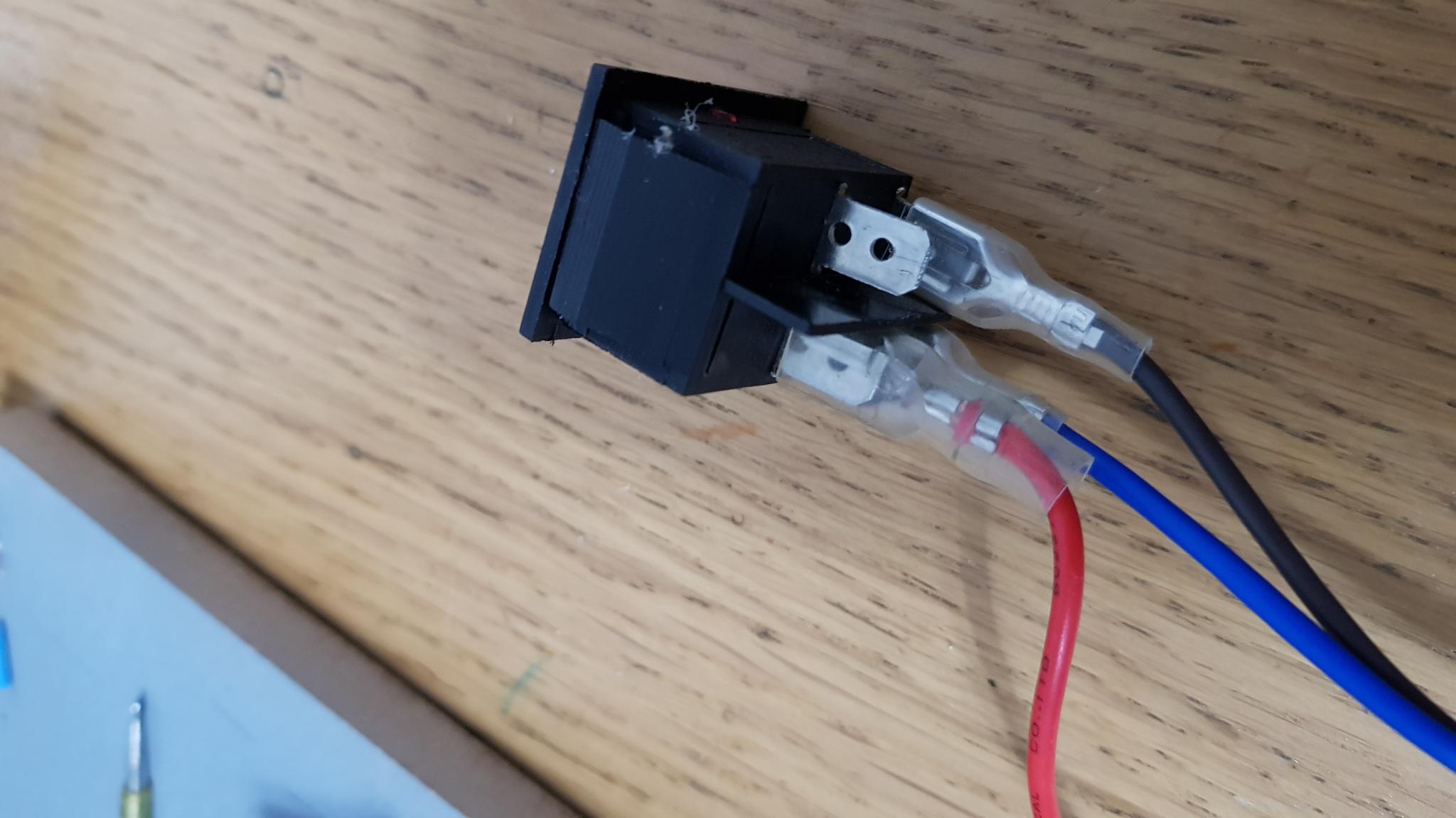

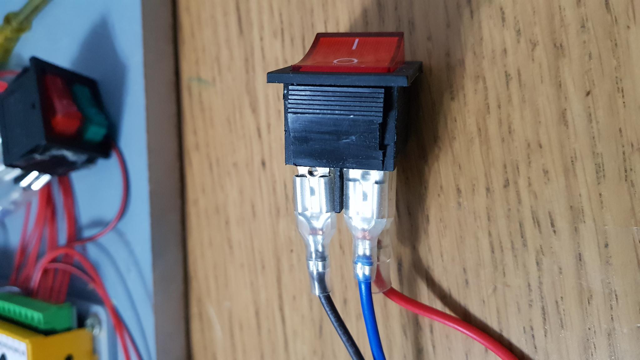

    still confused by were to put VFD wires coming from L1 and L2 also on off switch not got a clue how to wire this, if it wasn't for this forum and youtube i would have blown up by now.

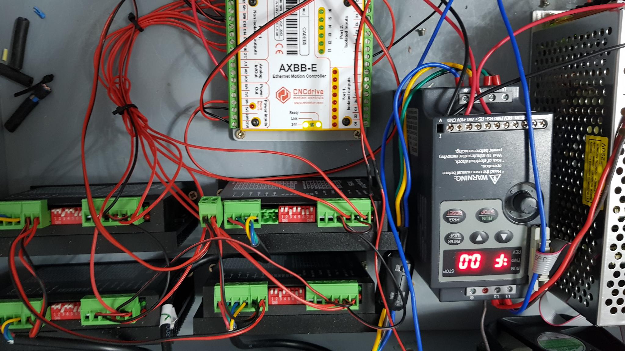

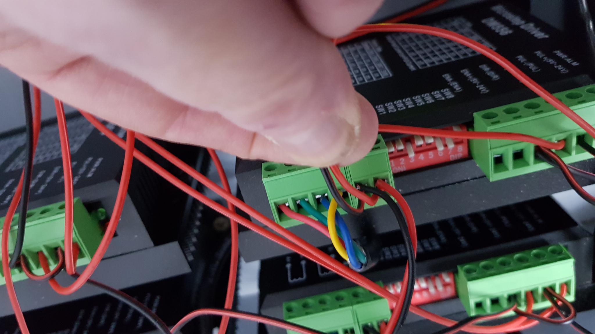

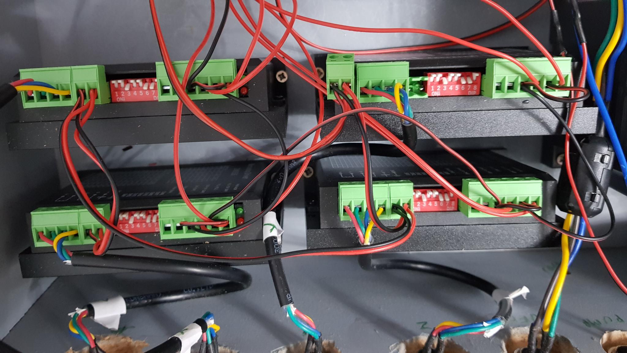

    Decided not to go with on/off switch, turned on and lit up fine and also vfd came on , only problem is the 2 wires in pic from the stepper drivers, if i put them in + - on the psu then nothing lights up on them and also it knocks the 24v light out on the AXBB-E, So have i wired them up wrong.
    Once again cheers for the help.

  8. #48
    All sorted, all lighting up like it should, just need to setup uccn program now...That will be fun...see you all soon and many thanks

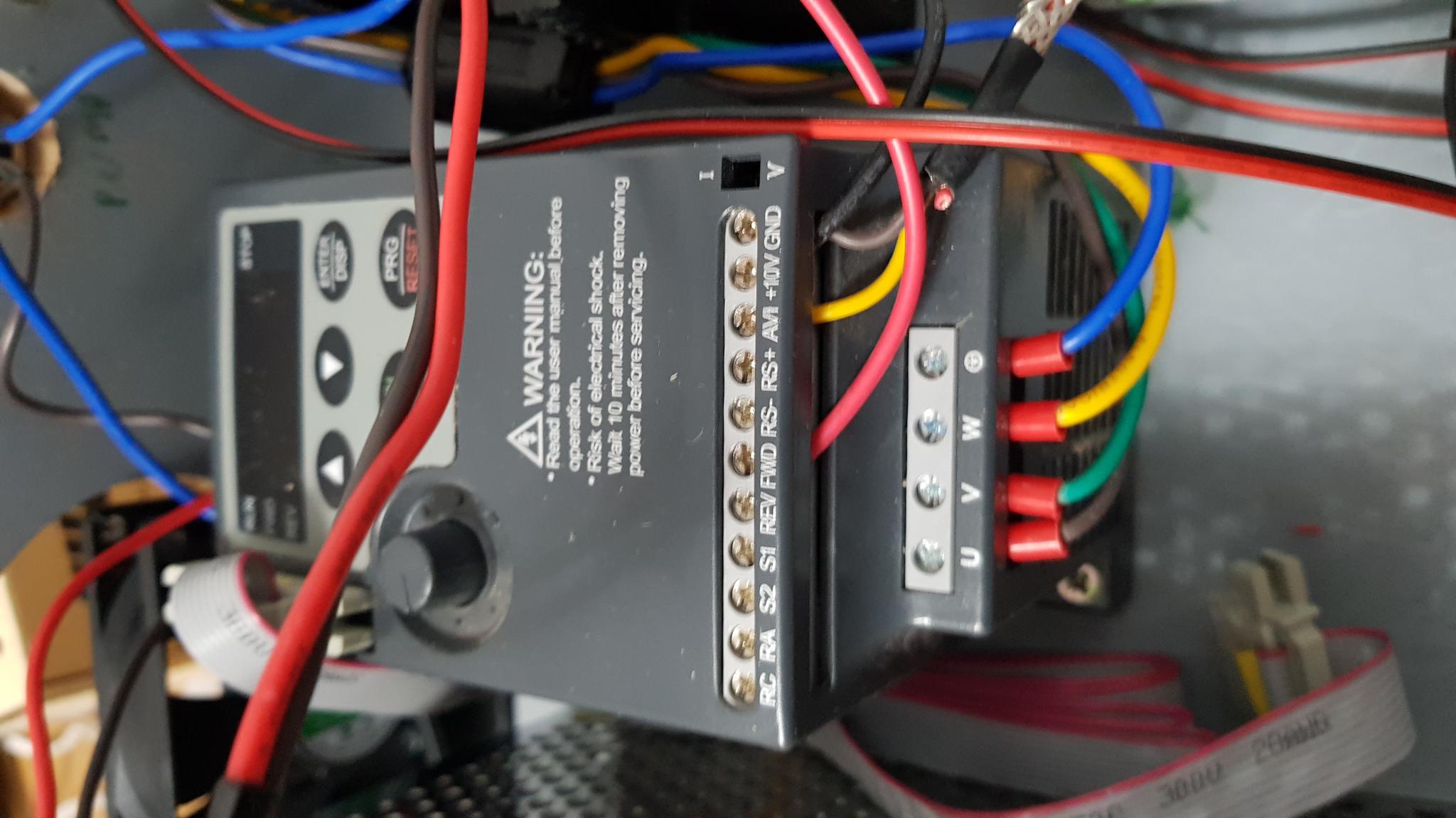

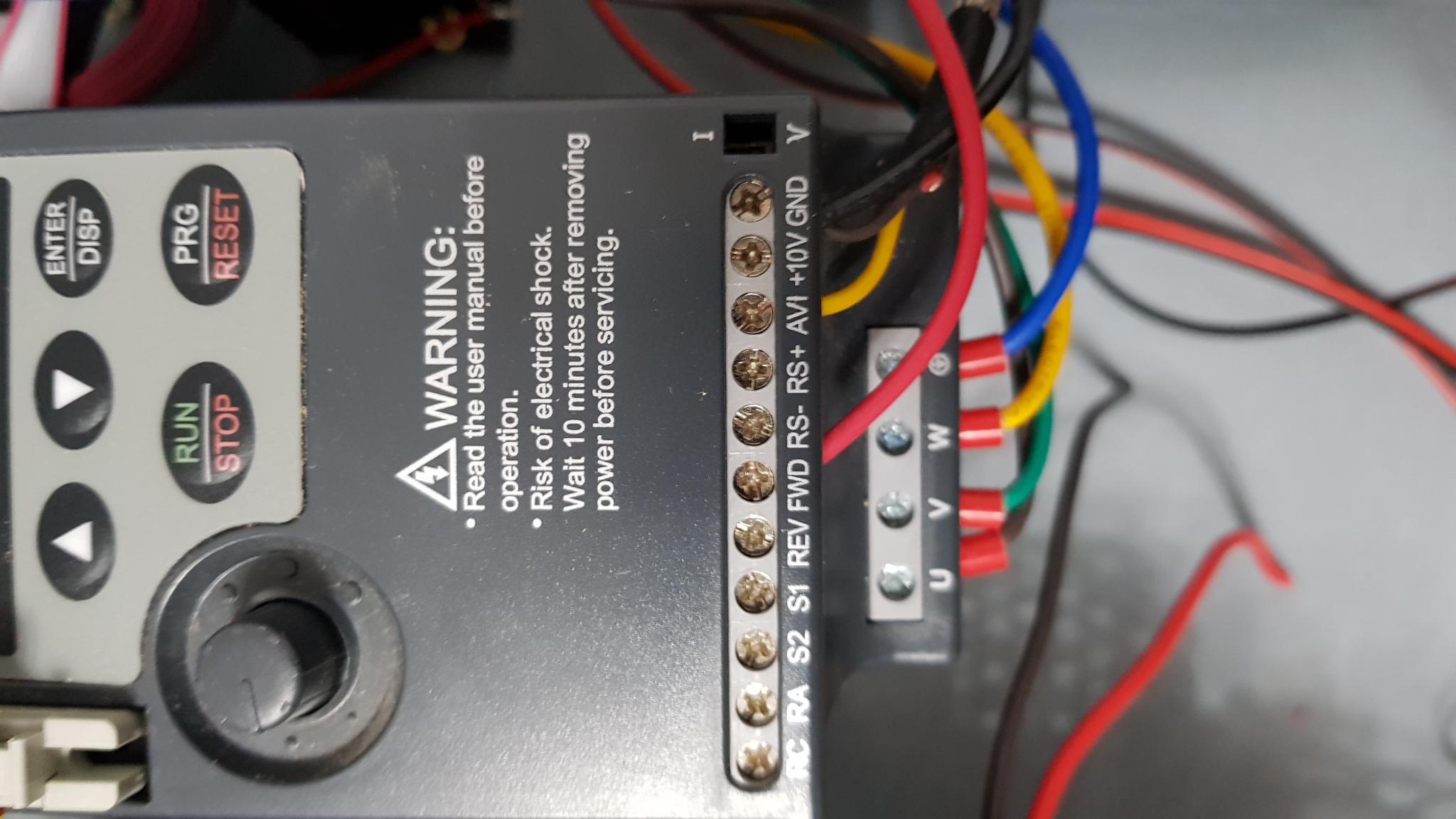

    Back again , need help getting the spindle to spin in UCCNC, can move all axis but cant get spindle to move.
    Any ides much appreciated
  10. #50
    Quote Originally Posted by mrmacca View Post
    Simply connect Fwd to Gnd and it will start. If you want to start/stop it through the controller using UCCNC then use an Output which controls a relay and run a wire from Fwd through a NO contact back to Gnd on the VFD.
