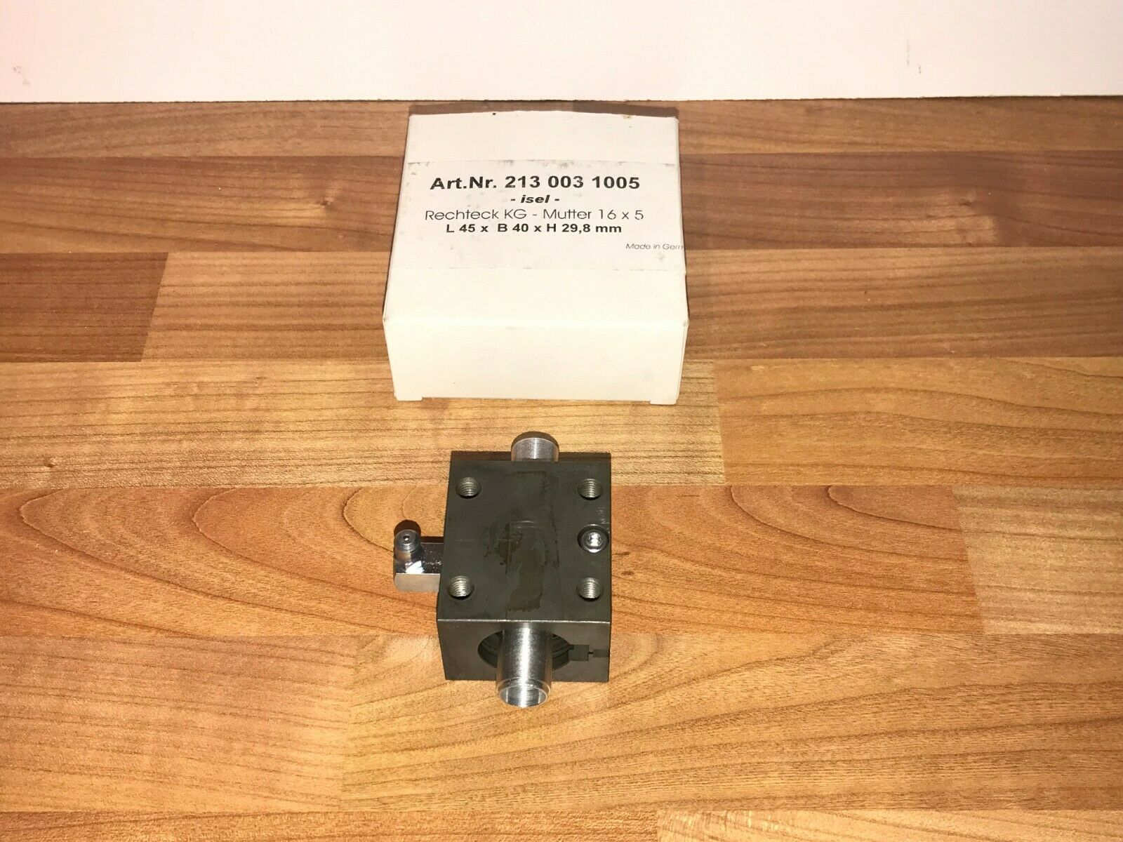

    Hello, does anybody know how to preload ballnut for isel machine, some online sources says can be ajusted, so seems longest screw (Y axis by isel X) has bolt to squish, but cant see anything on others axis as they build in aluminium extrusion, thank you in advance.

    Hi Buckis
    This might help
    https://www.cnc.info.pl/download/file.php?id=1211
    It's in German I think there should be a grub screw to adjust although they don't really make it clear in the description.
    Andrew
