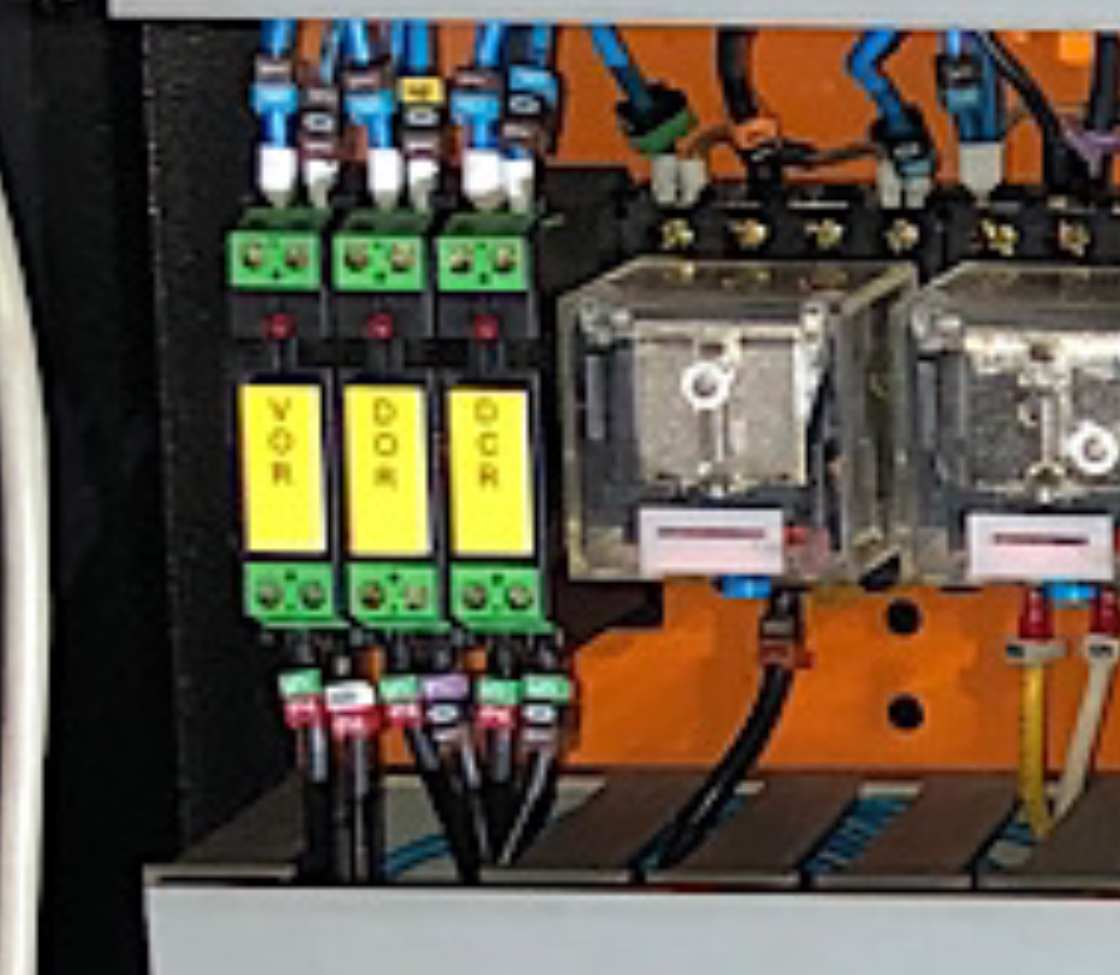

    Yes! I’ve got the VOR, as well as DCR & DOR (door closed/open relays?)
    Ah! This may also explain something else…
    To the right hand side of the column, is what looks like a push fit air fitting, maybe 5or6mm from memory.
    Thinking now this could be the air supply for the vice?
    Should all of the relays have the LED illuminated when the machine is under power?
    Or just when commanded?
    Hoping to strip the case of the head over the next couple days, to try and identify the drawbar issue…

    The Vice used an air over oil actuator/intensifier bolted to the back of the machine, as the vice would have been oil actuated, so the couple would have likely been for oil.
    Not all relays should be powered.
    Things like the DCR/DOR should only have one of the two active at any given time.
